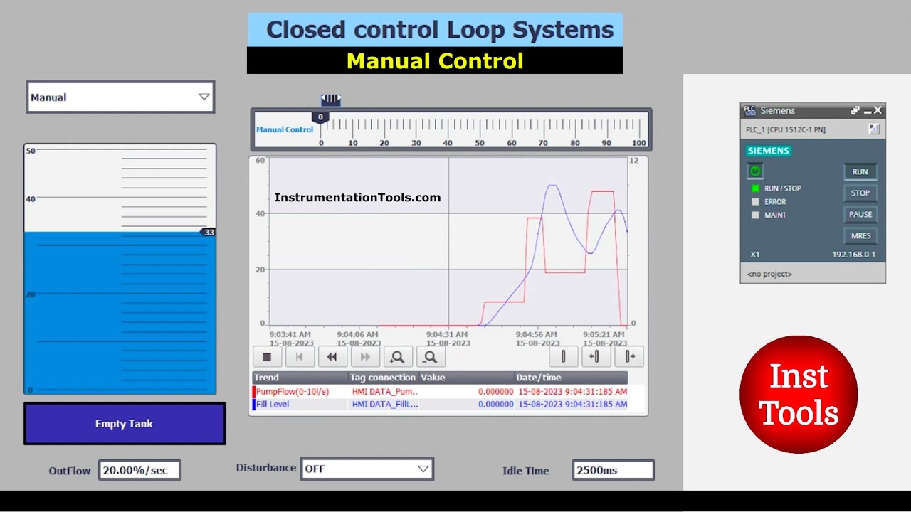

What is Manual Control?
To understand what manual control is, imagine that you have a tank filled with water, this tank feeds water to a 5 apartments building, the demand from this tank will probably be continuous and also variable depending on the apartment’s different needs. Now imagine having to manually control the tank so it would always be filled at 80% of the maximum level. You would manually control the start/stop of a pump assuming a constant flow pump or you would control the ON/OFF of a water supply valve.
To manually control the level and keep it at 80% wouldn’t be easy, because you will have to adjust the frequency of the pump running and stopping or the degree of opening of the valve depending on the demand from the apartments, and as the demand is variable, keeping the level at the 80% won’t be possible.
Manual control doesn’t have any feedback signals, so you need to observe the tank level by yourself and decide when to run or stop the pump. See the following simulation of the manual control system.
Manual Control System - Closed Loop Control System Simulation
As you can see from the simulation, there is no feedback signal for the tank level, you have to observe it by yourself and then decide to run or stop the pump. You will also notice that it is hard to keep the level at a certain point because the demand is variable and changes all the time.

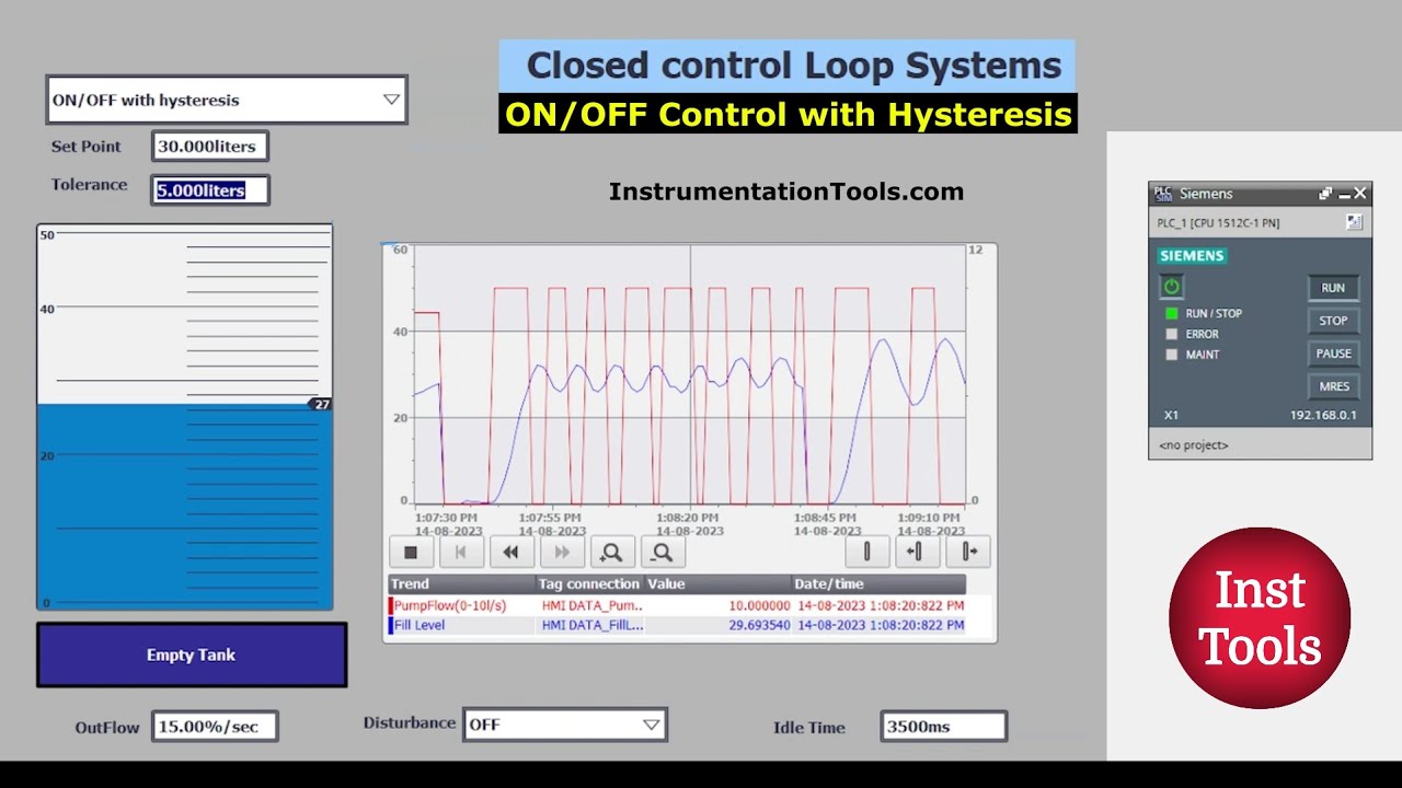

ON/OFF control with Hysteresis
The “ON/OFF control with Hysteres” is exactly the same as the ON/OFF control, but with an added tolerance to the set point, meaning the level of the tank is not allowed to be within a certain tolerance of the set point. To help the pump run more smoothly and prevent frequent start/stop of the pump to protect it from burning out.
However, this control will depend on the behavior of the pump whether is it working with different flows or it is just on-off the pump. If the flow of the pump is controlled then the behavior will be better, but if it just on-off of the pump, then it will be like the previous control but with a longer running time of the pump. we will see in the simulation.

PLC Simulation of the System
To simulate the system, we have created a simple HMI simulation and defined the needed parameters to show how the different control type will work. We need to understand some parameters we have created to make the simulation as real as possible. There is a function block FB called tank simulator, that was created to give the system a real-like behavior, you don’t need to understand completely how it works, but you can open up the function and read through its code.
However, some parameters you need to understand, and they are the following:
Idle time:
Any real pump will take some milliseconds before it can reach its full power or any other flow power, it doesn’t immediately jump to full power. This was included in the simulation to give a real behavior of the pump.
Outflow:
This is the demand of your system, it is set to be a % of the level of the tank. In the simulation, we manually write the outflow.
Disturbance:
A real system will have some kind of noise or random disturbance that can affect the behavior of the system, this was also included in the simulation.
Check the following simulation video to see how the system behaves with different controller types.
Closed Loop Simulations and ON-OFF Control with Hysteresis - PLC Basics
In the video, you can notice that, when the system type is ON/OFF the pump is starting and stopping a lot of time in a short period of time. Which might cause the pump to burn out.
When a tolerance is provided, the pump will have a fewer start/stop time and a relatively longer running time.
In both control systems, you can see that maintaining the tank level at the set point is not achieved all the time, because the outflow can change at any time and also the random disturbance.
