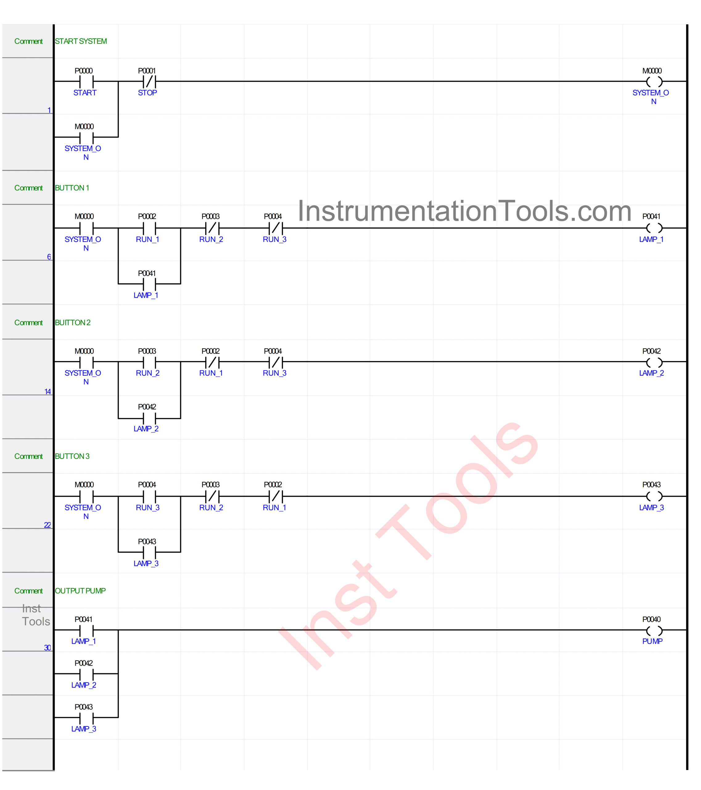

PLC Logic

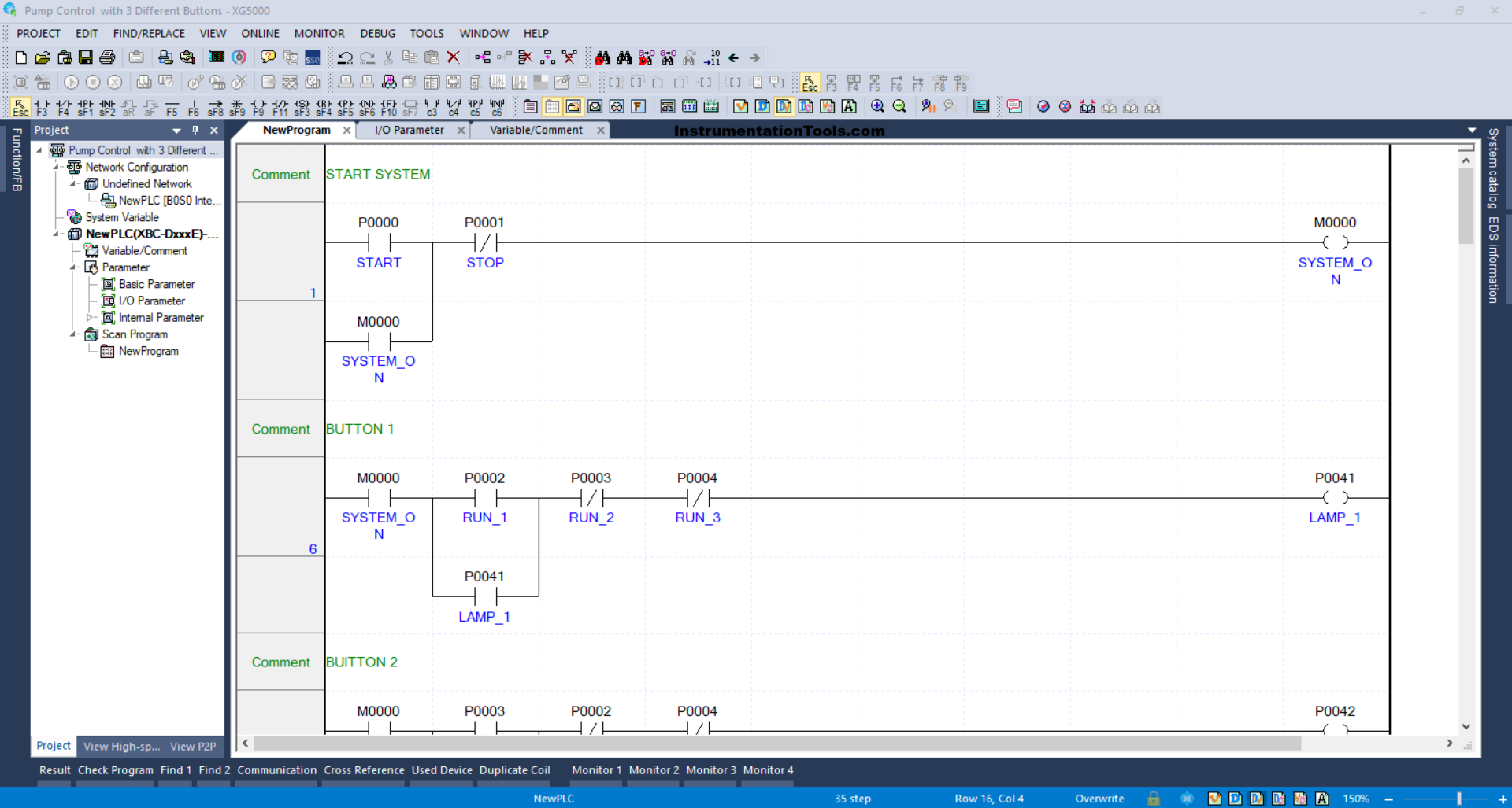

RUNG 1 (START SYSTEM)
In this rung, when the START (P0000) button is pressed, the memory bit SYSTEM_ON (M0000) will be in the HIGH state. Because latching is used, the memory bit SYSTEM_ON (M0000) remains in the HIGH state even though the START (P0000) button is released.
If the STOP (P0001) button is pressed, the memory bit SYSTEM_ON (M0000) will be in the LOW state.
RUNG 6 (BUTTON 1)
When the NO contact of the memory bit SYSTEM_ON (M0000) is in a HIGH state and the RUN_1 (P0002) button is pressed, the output LAMP_1 (P0041) will turn ON.
Even though the RUN_1 (P0002) button is released, the output LAMP_1 (P0041) will remain ON due to the use of latching.
The output LAMP_1 (P0041) will turn OFF when the RUN_2 (P0003) or the RUN_3 (P0004) buttons are pressed.

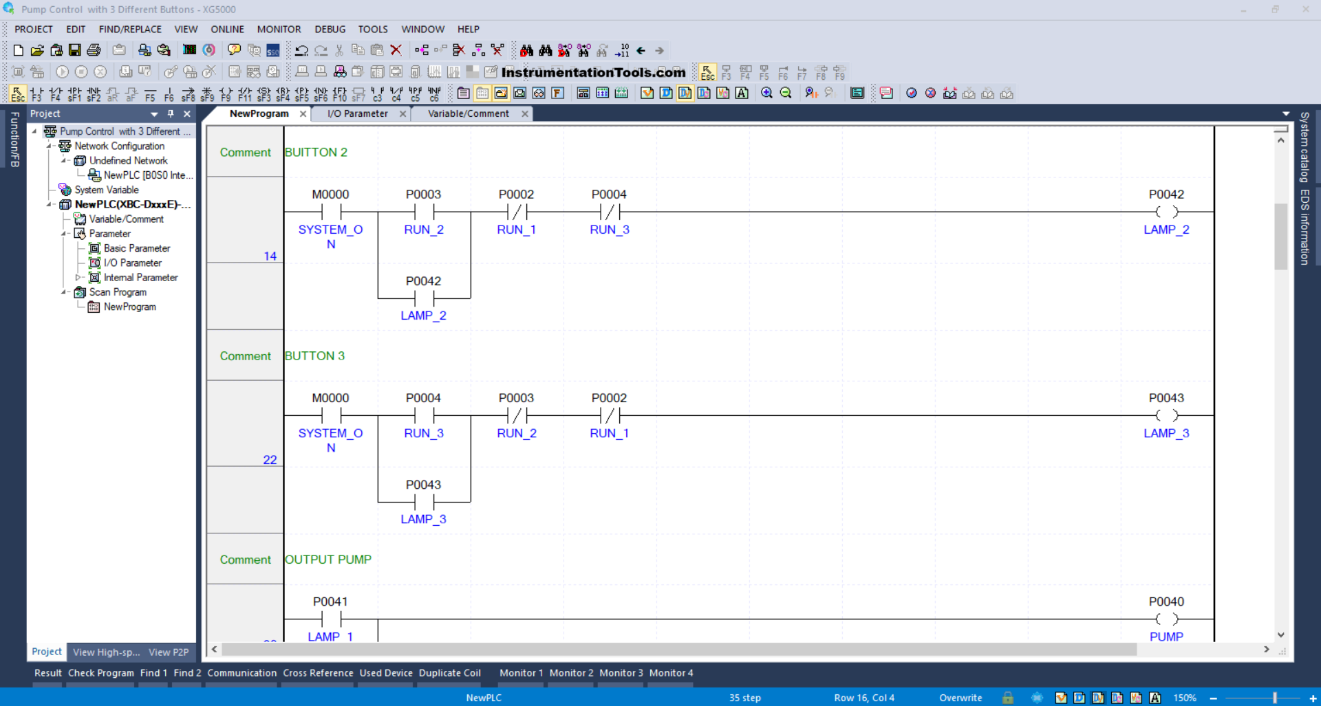

RUNG 14 (BUTTON 2)
When the NO contact of the memory bit SYSTEM_ON (M0000) is in a HIGH state and the RUN_2 (P0003) button is pressed, the output LAMP_2 (P0042) changes to an ON state.
Even if the RUN_2 (P0003) button is released, the output LAMP_2 (P0042) will remain ON because it uses latching.
When the RUN_1 (P0002) or the RUN_3 (P0004) buttons are pressed, the output LAMP_2 (P0042) will turn OFF.

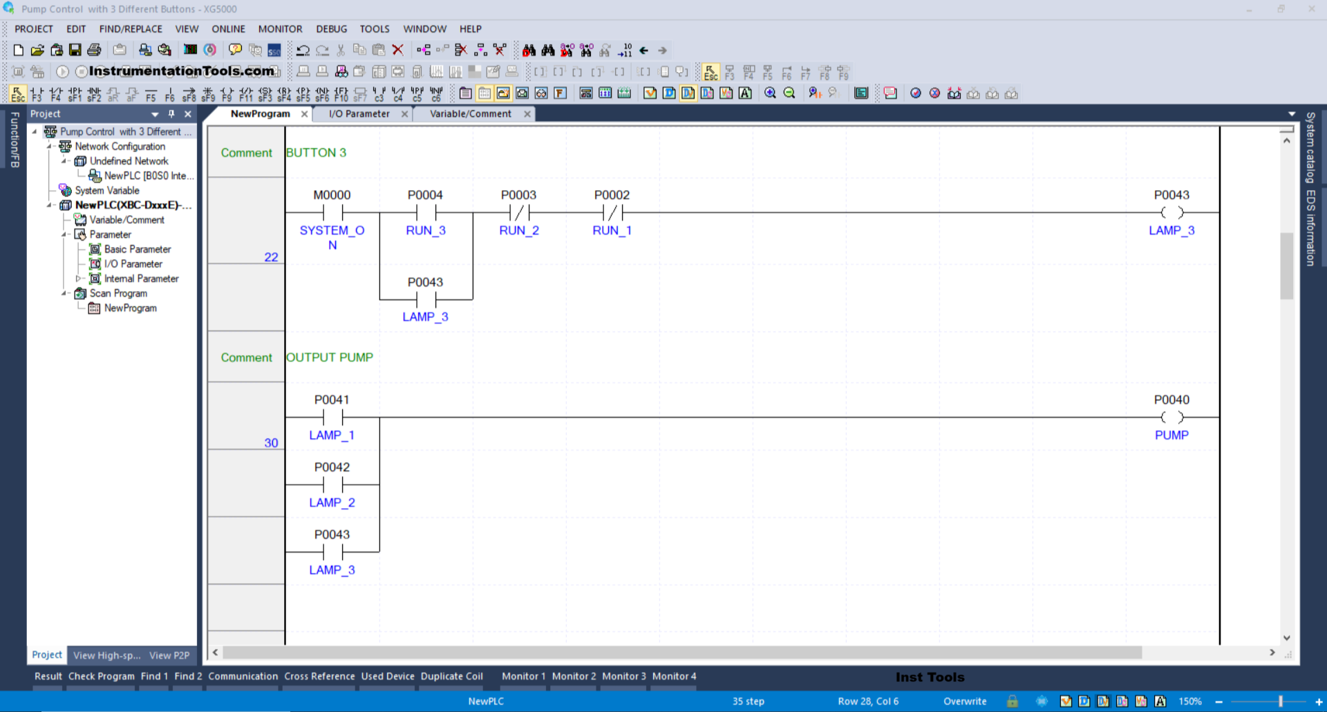

RUNG 22 (BUTTON 3)
When the NO contact of the memory bit SYSTEM_ON (M0000) is in a HIGH state and the RUN_3 (P0004) button is pressed, the output LAMP_3 (P0043) changes to an ON state.
The output LAMP_3 (P0043) will remain ON even if the RUN_3 (P0004) button is released because it uses latching.
When the RUN_1 (P0002) or the RUN_2 (P0003) buttons are pressed, the output LAMP_3 (P0043) will turn OFF.
RUNG 30 (OUTPUT PUMP)
In this rung, if any one of the NO contacts from LAMP_1 (P0041), LAMP_2 (P0042), and LAMP_3 (P0043) is in a HIGH state, then the PUMP output (P0040) will turn ON.
