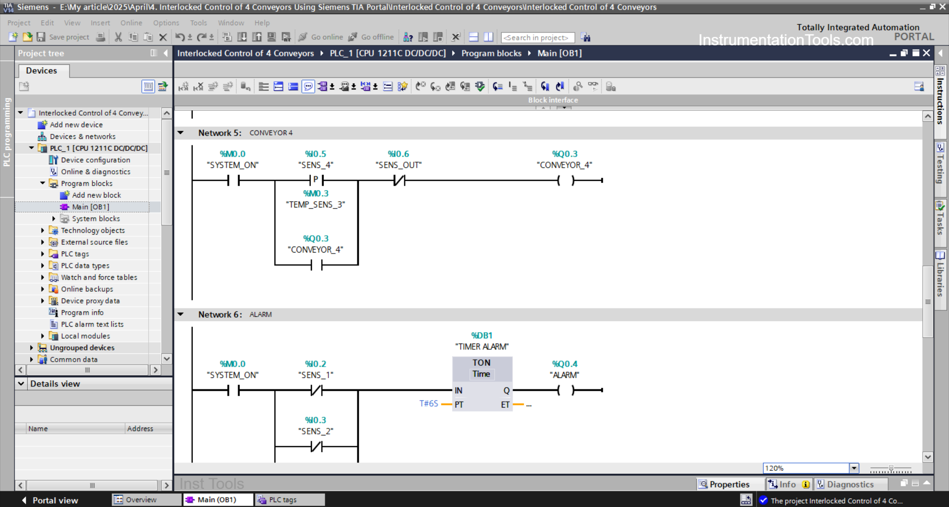

NETWORK 5 (CONVEYOR 4)
In this Network, the CONVEYOR_4 (Q0.3) output will be ON if the NO contact of the memory bit SYSTEM_ON (M0.0) and the SENS_4 (I0.5) sensor are in the HIGH state. The CONVEYOR_4 (Q0.3) output will remain ON even though the SENS_4 (I0.5) sensor is in the LOW state. Because it uses Latching.
When the NC contact of the SENS_OUT (I0.6) sensor is in the HIGH state, the CONVEYOR_4 (Q0.3) output will return to OFF.

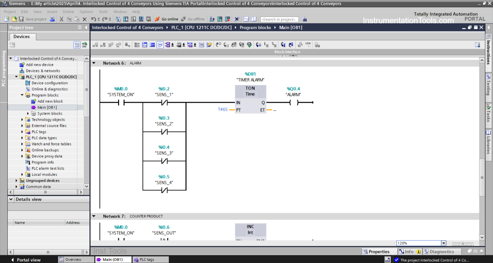

NETWORK 6 (ALARM)
In this Network, the TIMER ALARM (DB1) timer will start counting up to 6 seconds when the NO contact of the memory bit SYSTEM_ON (M0.0) is in the HIGH state.
The ALARM (Q0.4) output will be ON when the TIMER ALARM (DB1) timer has finished counting.
The ALARM (Q0.4) output will be OFF and the timer TIMER ALARM (DB1) will be reset, if any NC contact from the sensors SENS_1 (I0.2), SENS_2 (I0.3), SENS_3 (I0.4), SENS_4 (I0.5) is in the HIGH state.

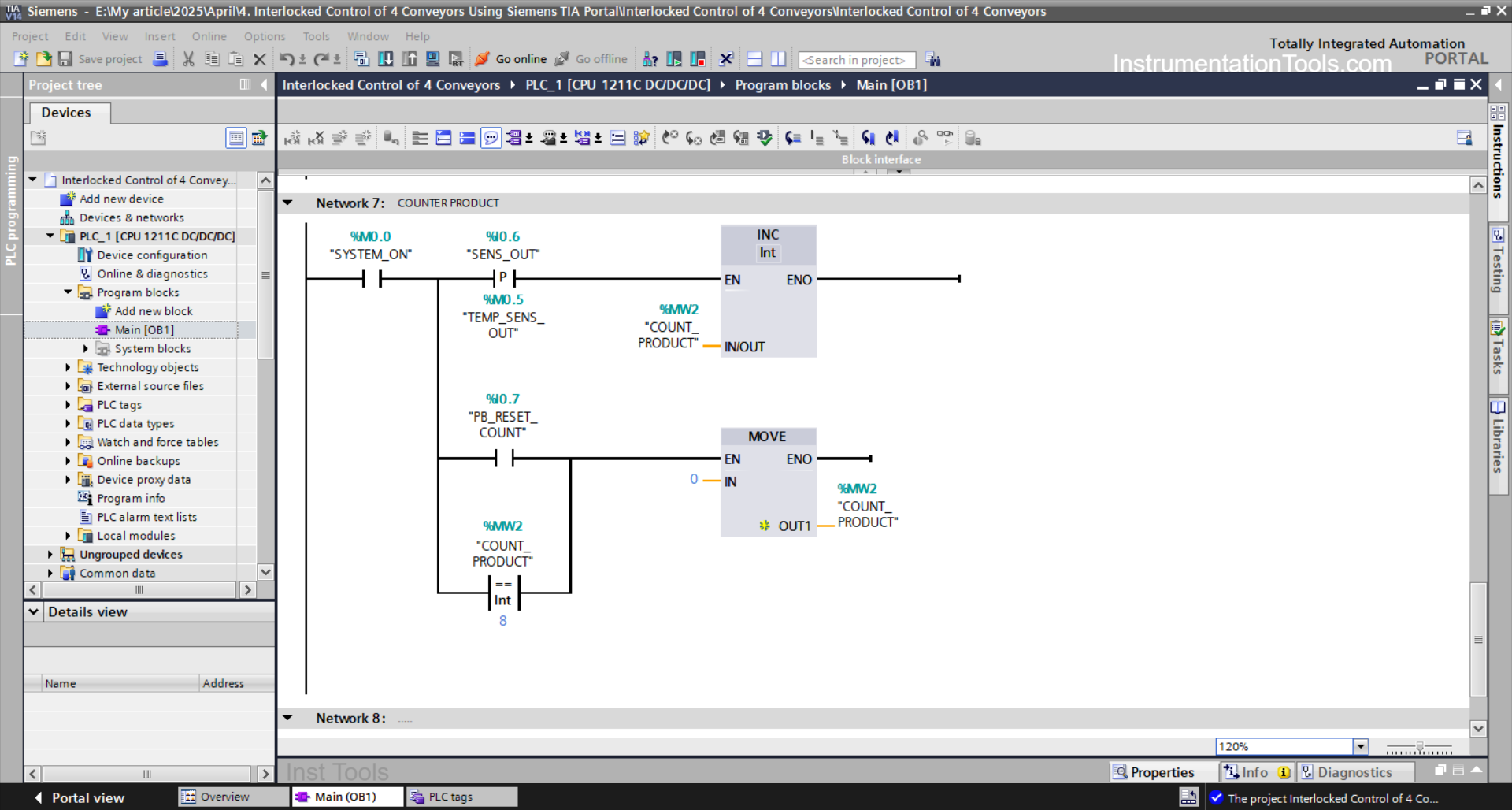

NETWORK 7 (COUNTER PRODUCT)
In this Network, the value of the memory word COUNT_PRODUCT (MW2) will increase (+1) if the NO contact of the memory bit SYSTEM_ON (M0.0) and the SENS_OUT(I0.6) sensor are in the HIGH state. Because it uses the Increment instruction.
The value of the memory word COUNT_PRODUCT (MW2) will be reset to “0” when the value of the memory word COUNT_PRODUCT (MW2) is Equal to “8” or the PB_RESET_COUNT (I0.7) button has been pressed.
