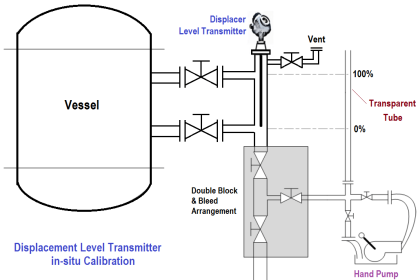

A displacer level transmitter consists of a displacer element which is suspended from a hanger with a torque tube which is connected to the transmitter head.
Displacer Level Transmitter Dry CalibrationDry Calibration of level transmitter:Dry Calibration with Weights for liquid level :  Interface level is measured with dry weight calibration
The displacer element is designed to be heavier than the liquid in which it is being used so that, even when fully immersed in the liquid, so it still exerts a downward force on the hanger.
Displacer Level Transmitter Calibration
As the liquid in the vessel rises to cover the element, a buoyancy force is created which is equal to the weight of the liquid displaced by the element (Archimedes’s principle). This is seen by the transmitter as an effective reduction of the hanging weight of the element, and, as the displacer element hanging weight is proportional to the liquid level around it, the electronics in the transmitter head can give readout of liquid level.
Displacer Level Transmitter weight calibration
