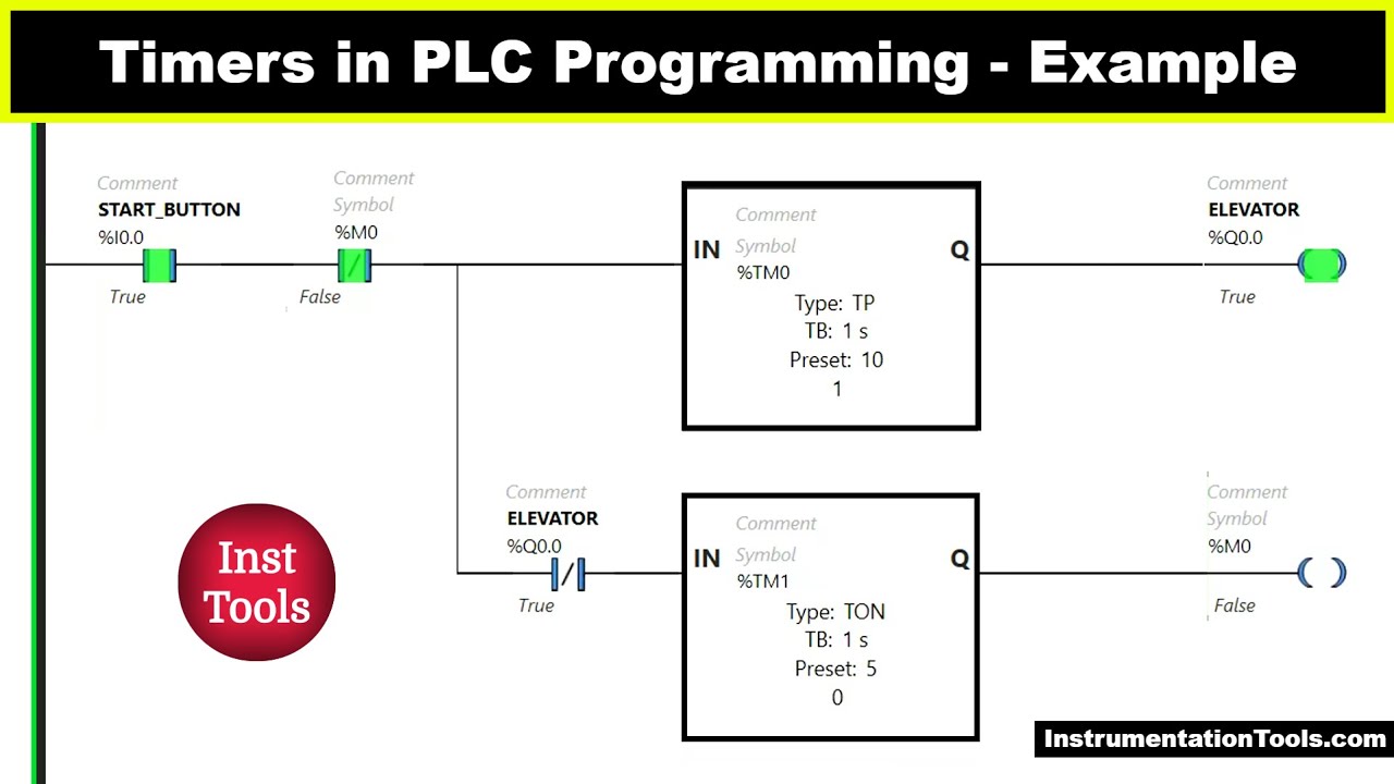

This is an elevator control application using a PLC Program with 5-second floor stops before moving to the next floor.

Problem Statement:
We are using one toggle switch to control the Elevator.
The elevator should stop at each floor for 5 seconds before moving to the next floor.

Inputs and Outputs
Digital Inputs:
Start Button: I0.0
Digital Outputs:
Elevator: Q0.0
Ladder Logic
Elevator Control
Program Description
We have used Normally Open Contact for the Start Button (I0.0).
Normally Open Contact is used for the Start Button (I0.0) to Turn ON the output  Elevator (Q0.0).
Timer-type TP is used to Turn ON the output Elevator (Q0.0) for a limited time.
Normally Closed Contact is used for Memory Bit (M0) to restart the output Elevator (Q0.0).
Normally Closed Contact is used for the Elevator (Q0.0) to turn ON the Memory Bit (M0).
Timer Function Block type TON is used to delay the turning ON time of Memory Bit (M0).
PLC Logic Simulation
Let’s simulate the PLC program.
When the Start  Button(I0.0) is turned ON, the output Elevator (Q0.0) turns ON or the Elevator starts moving but for a limited time because Timer Function Block type TP is used to turn ON the output Elevator (Q0.0) for a limited time. The time is set to 10 seconds.
PLC Controlling Program of an Elevator
After 10 seconds, the output elevator (Q0.0) turns OFF or the Elevator stops moving after reaching the next floor but only for 5 seconds because When the output Elevator (Q0.0) turns OFF, Normally Closed Contact used for the Elevator that is used to turn ON Memory Bit (M0) will be in the false state and Memory Bit (M0) will turn ON after 5 seconds as Timer Function Block type TON is used to delay the turning ON time of the Memory Bit (M0).
After 5 seconds, the Memory Bit will turn ON but it will turn OFF immediately as Normally Closed Contact used for the Memory Bit (M0) to restart the output Elevator (Q0.0).
Floor Elevator Programming Exercise
So, When the Start Button (I0.0) is turned ON, the output elevator (Q0.0) starts moving. After 10 seconds, the output Elevator (Q0.0) stops as the Timer Function Block is used and the timer is set to 10 seconds.
When the output Elevator (Q0.0) Stops, Normally Closed Contact used for the Elevator will be in a false state and pass the signal to turn ON the Memory Bit (M0) after 5 seconds as the Timer Function Block type TON is used and the timer is set to 5 seconds.
Elevator Stop Program
Memory Bit (M0) will turn OFF immediately because Normally Closed Contact is used for Memory Bit (M0) that is used to restart the output Elevator (Q0.0).
So, When Memory Bit (M0) turns OFF immediately, Normally Close Contact used for Memory Bit (M0) will be in the false state and pass the signal to restart the output Elevator (Q0.0).
