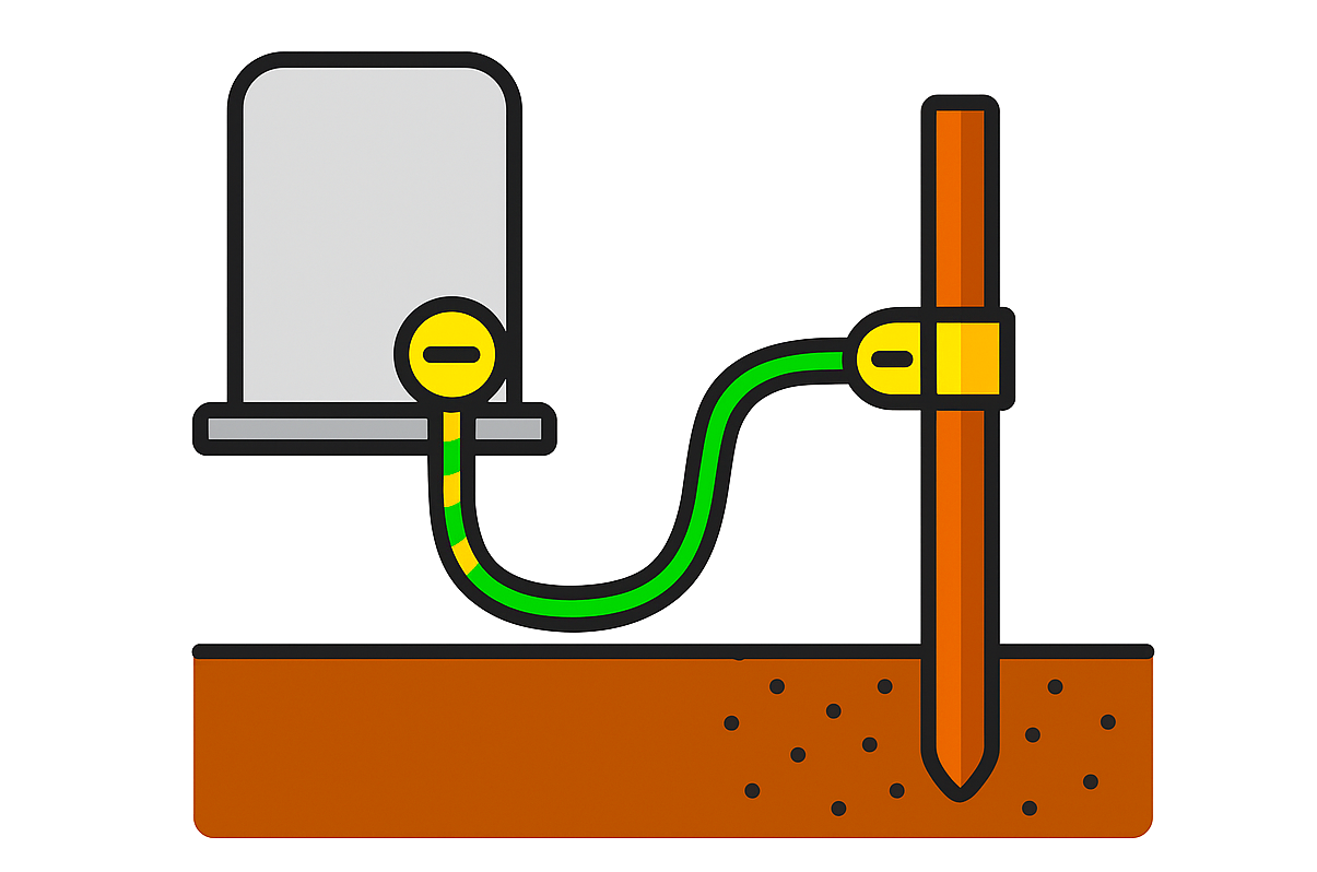

What is Earth Resistance?
Every electrical circuit has a leakage current or fault current flowing through it. This fault current is dangerous for the system as it can damage the circuit. So, such fault currents must be safely dissipated to a certain path. In electrical systems, this path is called an earth pit. A wire is used to carry this leakage current to the earth pit. This wire is called an earthing conductor. The role of this conductor is to allow the passage of leakage current safely to the main ground or earth pit. Due to this, the electrical system remains safe from any damage.
Now, as this conductor is intended to carry the leakage current, it must allow a very minimum resistance. If the resistance is greater, then the current will not be able to pass through it. Then it will be of no use for the earth conductor in the system, as it will not allow the leakage current to pass through it, which will damage the system. So, the earth resistance is defined as the resistance offered by the earth conductor to the leakage current. The value must typically be between 0.5 – 1 ohms, so that leakage or old current is allowed to pass easily.
Refer to the image below for understanding the Earth connection. As shown, a wire is connected from the electrical panel to the earth pit. Leakage current flows through a metal body, so it is connected to the panel body.

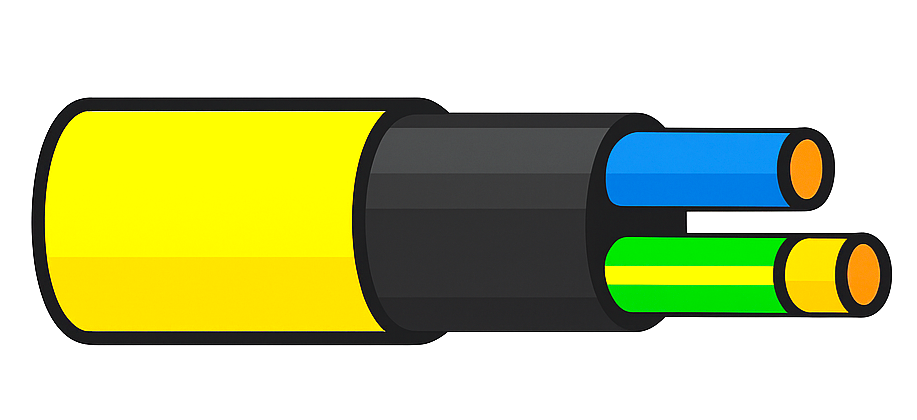

What is Insulation Resistance?
Every electrical cable has insulation with some dielectric strength so that the current does not leak from inside the conductor to the outside world. Due to this insulation, if you touch the live cable, you will not get an electric shock. You cannot practically layer cable with only conductors inside. It will short the other wires in contact nearby or cause an electric shock to the person who touches the wire. So the insulation is some non-conducting material that blocks the flow of current through it. It is mostly made of PVC, XLPE (cross-linked polyethylene), or rubber.
As this resistance is intended to block the flow of current, it must be of a higher value. If the resistance is less, then the current will be able to pass through it. Then it will be of no use for the insulation in the cable, as it will allow the current to pass through it and come in contact with the outside environment, making it dangerous. So, the insulation resistance is defined as the resistance offered by the insulator to the current.
Refer to the image below for understanding insulation. As shown, the insulator (yellow color) is spread in the outermost layer of the wire, which covers the internal conductor (blue color), thus preventing the flow of current through its body.
