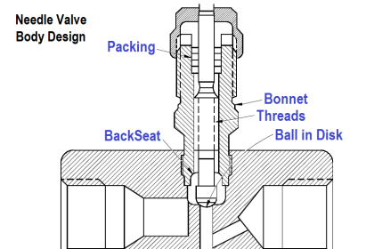

Linear Movement Valves
Ball valves and needle valves are mostly used for instrument isolation.
Instrument needle valves provide a highly reliable task to regulate, throttle, and isolate gaseous, non-viscous liquid of various nature.
Needle valves are linear movement-based. Needle valves can control the flow of liquids or gases and that of flow can be decreased gradually and ultimately shut off completely.
Needle valves are used to control flow into delicate and sensitive gauges, fluids under pressure cause damage due to sudden surges.
Since the orifice is small, needle valves are usually easy to shut off completely with merely finger-tight pressure.
