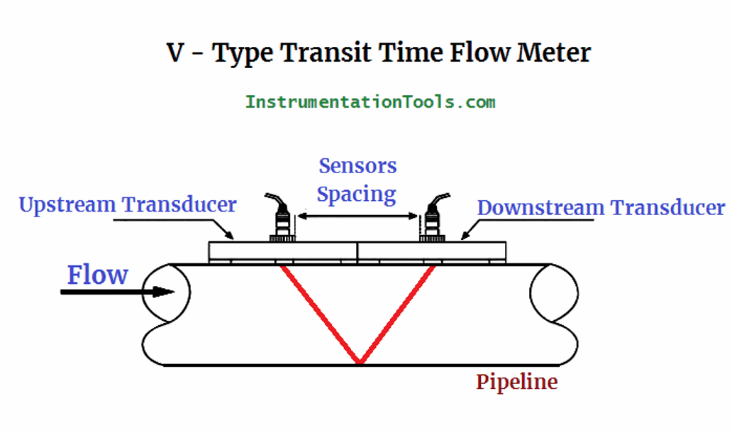

V – Type Transmit time flow meters
The two sensors are installed on a pipeline such that the ultrasonic waves travel in the form of v-shape, hence called them as V-Type Transmit time flow meters, as shown in below figure.
V Type Transit Time Flow Meter

    The “V” configuration is recommended for most installations. This arrangement places the two transducers on the same side of the pipe within approximately a diameter of the pipe from each other. A rail attachment clamps on the pipe and allows the transducers to be slid horizontally to position them the calculated distance apart.
