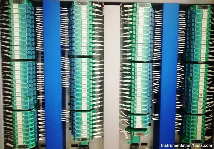

In an industrial plant, thousands of wires come from sensors and field devices to the control room. If all these wires go directly to the main control system (like a DCS or PLC), things can get messy and very hard to maintain. That’s why we use something called a marshalling cabinet — it acts like a middleman between the field devices and the control system.
Where Does the Marshalling Cabinet Fit?Why Do We Need a Marshalling Cabinet?What is Cross Wiring?What if Signal Types are Mixed?What About Safety Systems?How Cables Are Connected Inside the Cabinet?Conclusion
Think of the signal path like this:
Field Devices ➡️ Junction Boxes ➡️ Marshalling Cabinet ➡️ System Cabinet (I/O cards)
So, the marshalling cabinet sits between the junction box (where field wires come in) and the system cabinet (where PLC or DCS I/O cards are located).
Here’s why it’s useful:
  • The marshalling cabinet helps organise hundreds of incoming field signals.
  • If something goes wrong, it’s easier to troubleshoot.
  • It allows us to route signals exactly where we need them, even if they come in randomly.
DCS Marshalling Cabinet
Here’s what usually happens inside a marshalling cabinet:
  • Field cables (multi-core cables) enter from the bottom.
  • Wires are first connected to surge protection devices (if needed).
  • If surge protection is not used, wires go directly to terminal blocks.
  • For IS (Intrinsically Safe) systems, the wires go through IS barriers first.
  • Then comes the cross-wiring, where signals are routed to match the I/O card layout.
Finally, special interface cables (plug-and-play type) go from the marshalling cabinet to the I/O cards in the system cabinet.
Some boards also need DC power, which is provided from inside the marshalling cabinet.
