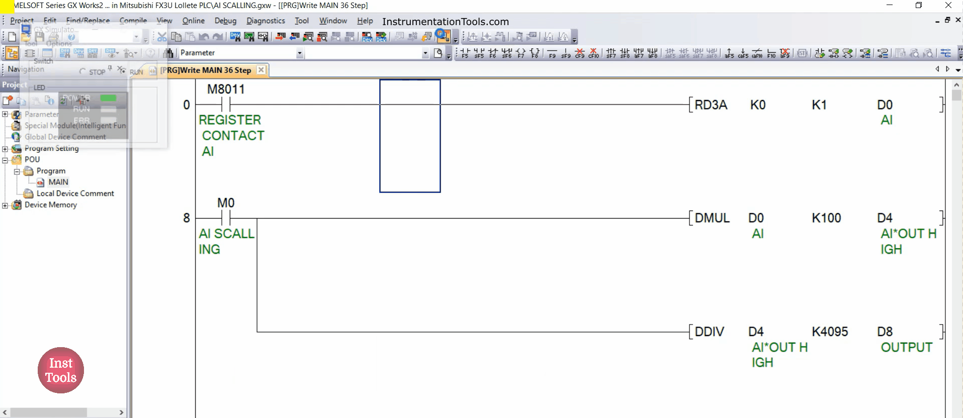

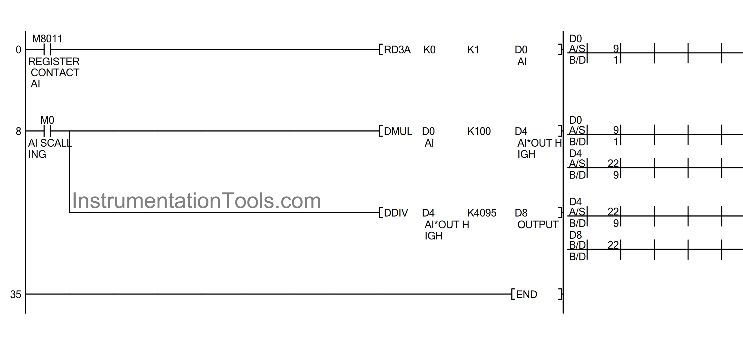

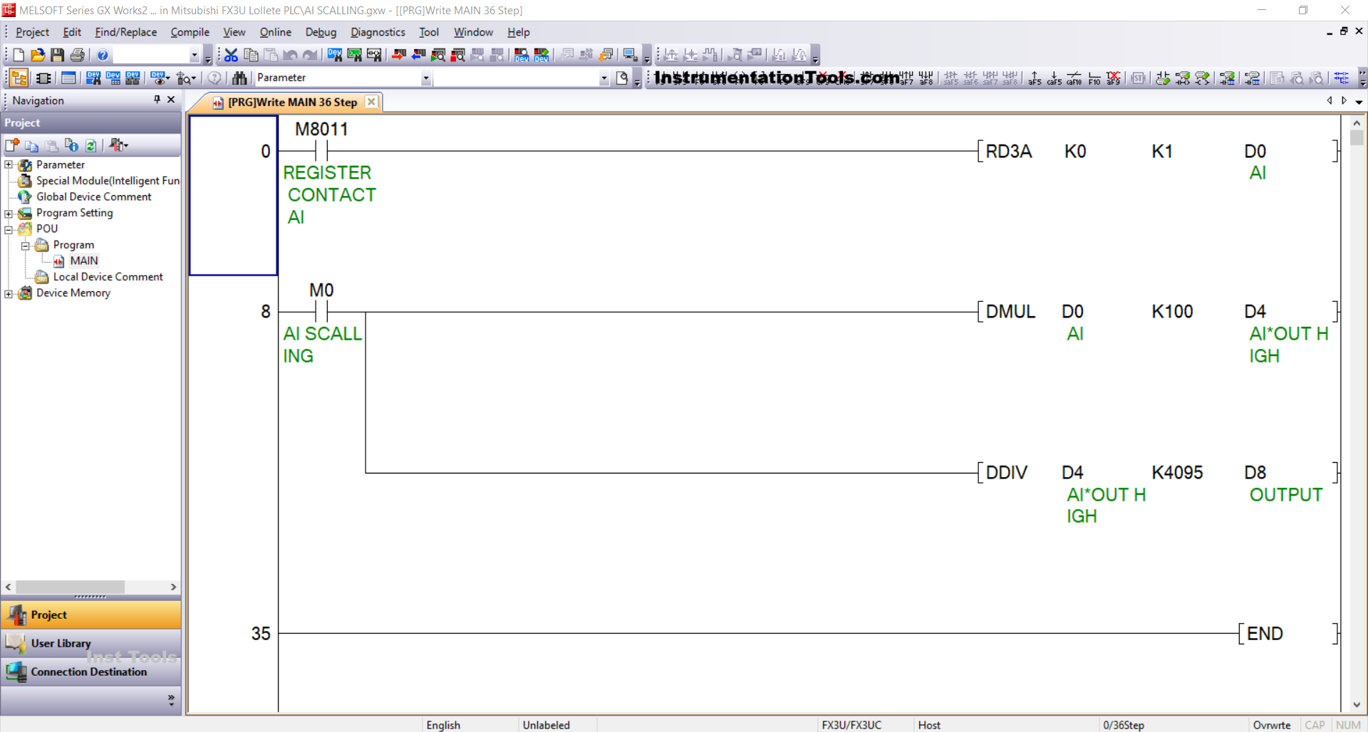

Scaling Analog Input to 0-100%
RUNG 0
In this rung, when the NO (Normally Open) contact of REGISTER CONTACT AI (M8011) is in a HIGH state, the RD3A instruction will read the analog input value from address “AD1” or “K1”. The analog input data will then be stored in memory word AI (D0).
RUNG 8
In this rung, when the NO contact of memory bit AI SCALING (M0) is in a HIGH state, the DMUL instruction will multiply the data in memory word AI (D0) by the value “100” and store the result in memory word AI*OUT HIGH (D4).
Next, the DDIV instruction will divide the data in memory word AI*OUT HIGH (D4) by the value “4095” and store the final result in memory word OUTPUT (D8).
