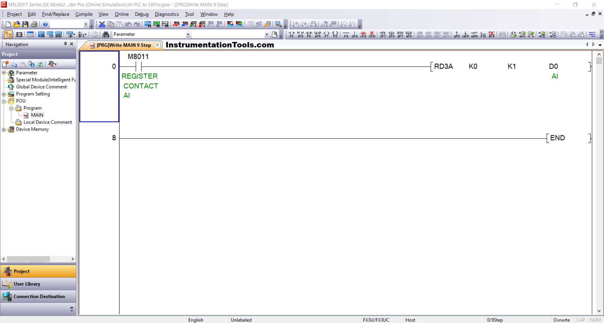

1. PLC Programming:
Create a program in GX Works2 software using the RD3A instruction, which is used to read analog input data.
- Module Configuration: 0/K0.
- Analog Input Address: 1/K1.
- Data Storage: The analog input value will be stored in word memory D0.
- Instruction Activation: Use the normally open contact from the memory bit REGISTER CONTACT AI (M8011) to trigger the instruction.

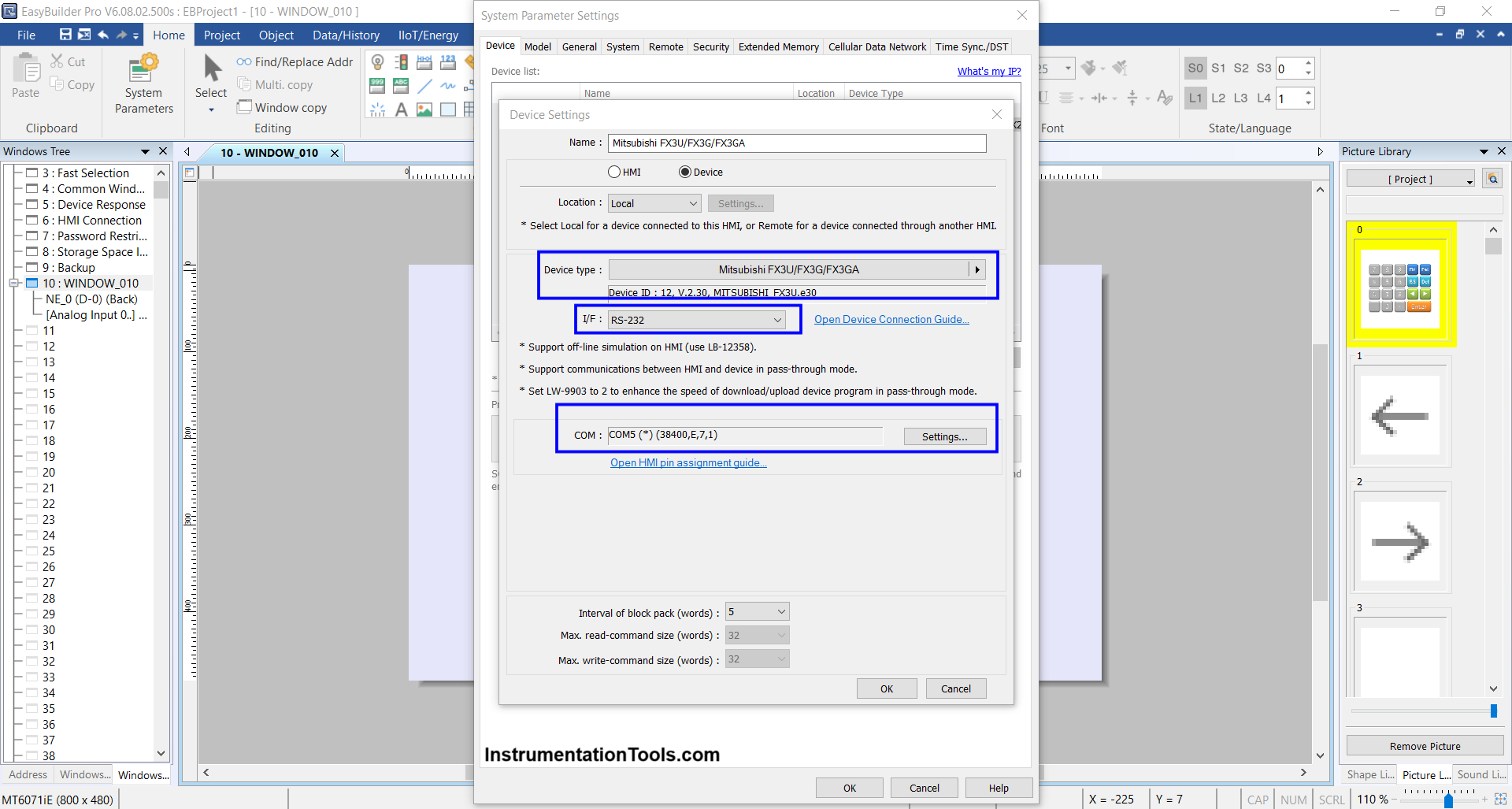

2. Add PLC Device
Open System Parameter and click New Device/Server.
Set the connection parameters as follows:
- Port: RS-232
- COM Port: COM5(*)(38400,E,7,1) — adjust according to your PLC connection
- Device Type: Mitsubishi FX3U/FX3G/FX3GA
Click OK to save the configuration.

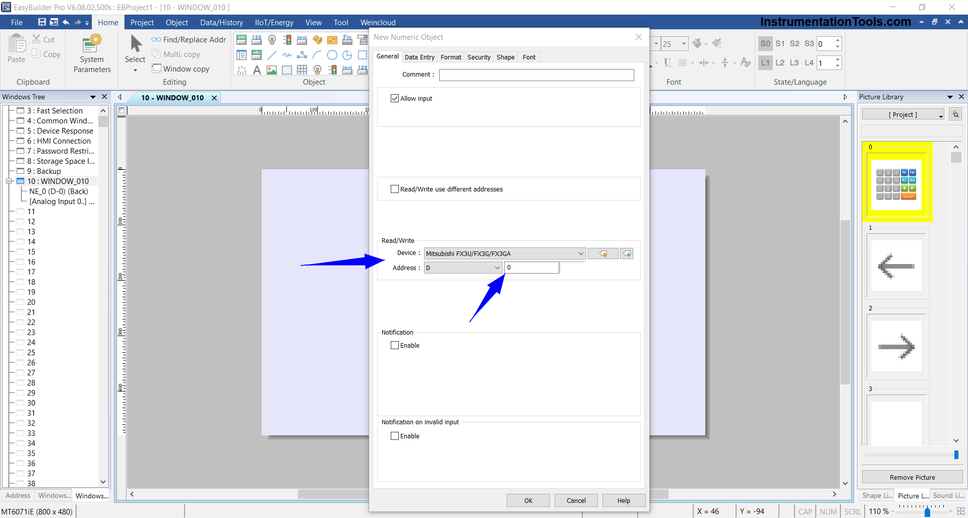

3. Design the HMI Interface
Insert a Numeric Object into the design area.
Configure the object settings:
- Device: Mitsubishi FX3U/FX3G/FX3GA
- Address: D0 (corresponds to the analog input memory address in PLC)

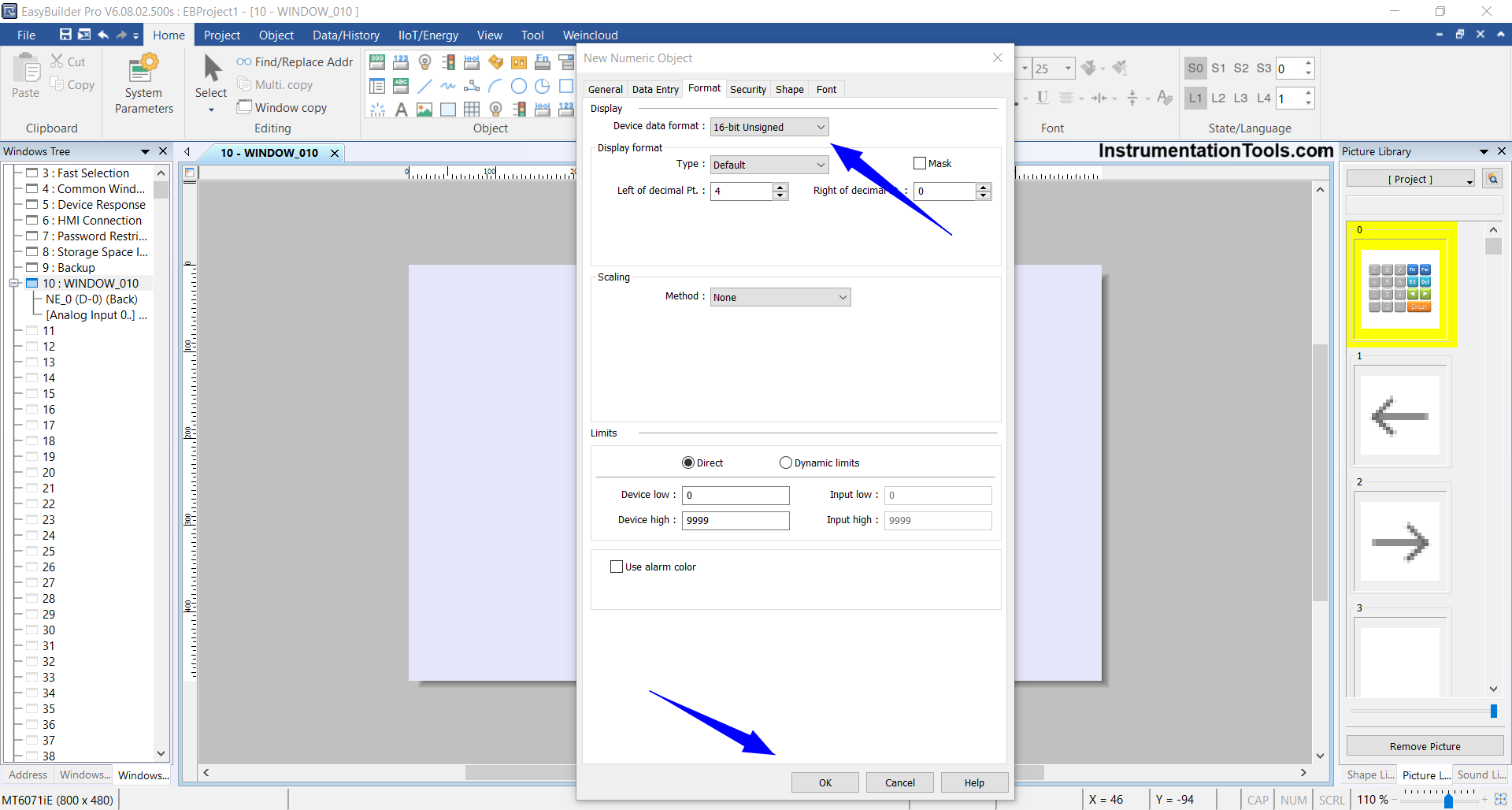

- Data Format: 16-bit Unsigned
Click OK to place the object on the screen.

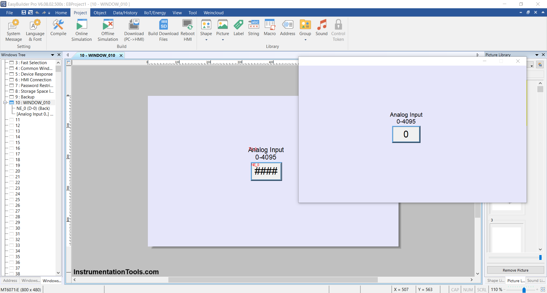

4. Run Online Simulation
Once the design is complete, start the simulation by selecting Project → Online Simulation.
5. Verify Connection
If the connection is successful, the simulation screen will appear and interact directly with the PLC.
*Important Note: If you see the message “Device Not Responding”, it indicates a failed connection.
Solution:
- Change the Device Type in System Parameter to FX0S/FX0N/FX1S/FX1N/FX2/FX3SA or another compatible type.
- This is because some units like the FX3U-14MT (Lollette, China version) have limited compatibility with the standard FX3U model in EasyBuilder Pro.
