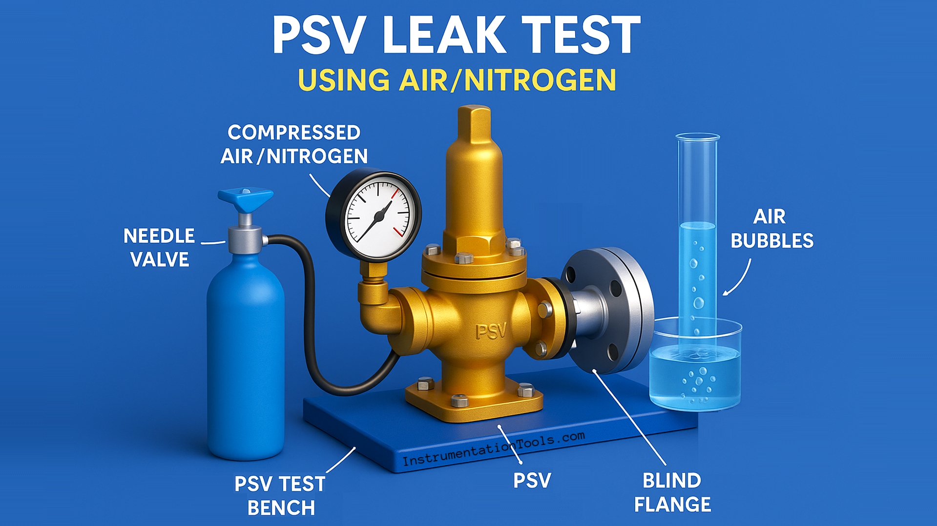

PSV Leak Test Using Air or Nitrogen
Pressure Safety Valve Leak Test Procedure
Step-by-step Process:
1. Place the PSV on a test bench.
Secure the valve on the leak test bench as per standard setup.
2. Find the CDTP (Cold Differential Test Pressure).
This pressure value is usually written on the PSV tag or in its datasheet. If not, you’ll need to calculate it manually (explained in the note at the end).
3. Increase pressure slowly.
Use a needle valve to gradually increase air or nitrogen pressure in the test setup. Go up to 90% of the CDTP, not all the way.
4. Check for leaks.
Attach a clear tube to the valve outlet. Submerge the other end in a container of water. Watch for air bubbles.
5. Evaluate the results.
If the number of bubbles is below the acceptable limit, the valve passes the leak test.
If there are too many bubbles, the valve fails the leak test.
6. If it fails…
Follow the manufacturer’s troubleshooting steps, or contact the valve vendor for help.

Understanding the Test Setup
In the air/nitrogen method, leaks show up as bubbles in a water container.
In the water method, leaks show up as visible water drops from the outlet flange.
