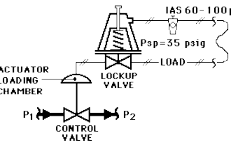

Based on the previous report, regarding the failure of the PSV of fire pump A, it is Reported that PSV started to crack at the discharge pressure of below of 110PSI (based in the P & ID, the setting supposed to be 200psi)
Prior to go too far to the investigation and troubleshooting, down below is following the principle of the PSV used:

Internal parts for inspection purpose, the PSV was rotated from the spool to be Able to inspect its internal parts. Figure 2 below shows how the PSV rotated out of the spool.
PSV Inspection
1.2 Leak Test without Pressure
After rotated and the internal parts can be seen, then the downstream side of the PSV (upper position) was filled with water to check the diaphragm tightness during no pressure.
And the result was no water Came out from the upstream side of the PSV (lower position), this indicated resources that the diaphragm was fully tight during no pressure both at the diaphragm chamber and the process side.
See figure 2 below to look more detail.
