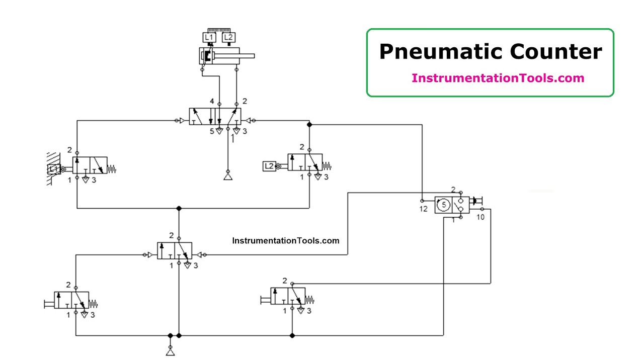

Pneumatic Counter Circuit Diagram
The pneumatic counter circuit diagram is shown below.
Pneumatic Counter for Counting the Strokes of a Cylinder
Pneumatic Counter Working Principle
The air supply is given to the system and the cylinder was in its home position with the contact of Limit switch 1.
When the Push button is pushed, the supply goes to the 3/2 Pneumatic actuated directional control valve.
We connected the output of the 3/2 pneumatic actuated valve to the limit switches for switching the positions of the 5/2 pneumatic actuated valve.
The switching positions of 5/2 directional control valves make the cylinder move forward.
The cylinder moves forward and touches its end position which was identified by the Limit switch 2. This made the cylinder move backward and that time count was counted with the help of a pneumatic counter.
Pneumatic Counter
Again this cylinder comes to the home position and touches the limit switch 1 which makes the cylinder move forward.
Then the cylinder moves forward and the process continues. At the same time cylinder stroke was counted by the pneumatic counter.
Components of Pneumatic Counter
After obtaining the defined value in the counter, the process gets stopped. The cylinder will be in the home position only. Even if we restart the process also it won’t work. It will work only after we reset the pneumatic counter.
The pneumatic counter was reset by using a separate push button. So, by this method, the cylinder stroke was counted and it was deployed as per the application.
Stroke Reading Cylinder and Counter
Conclusion
This method can be used in the applications of sorting, conveyor assembly, gang drilling, etc. We can give the counter input as per the needs and as per the component specification. This will save more time and manual counting errors.
