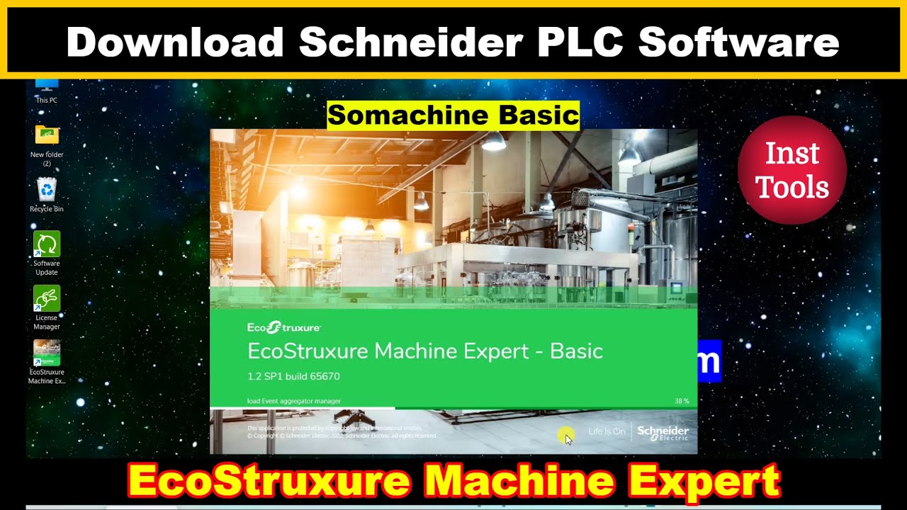

  • We used EcoStruxure Machine Expert software for PLC programming.
