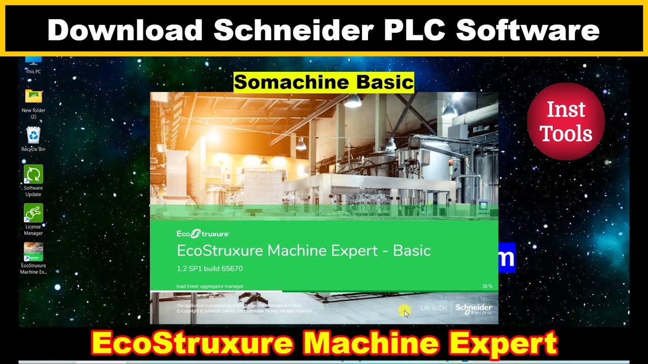

We used EcoStruxure Machine Expert Basic PLC software for programming.
