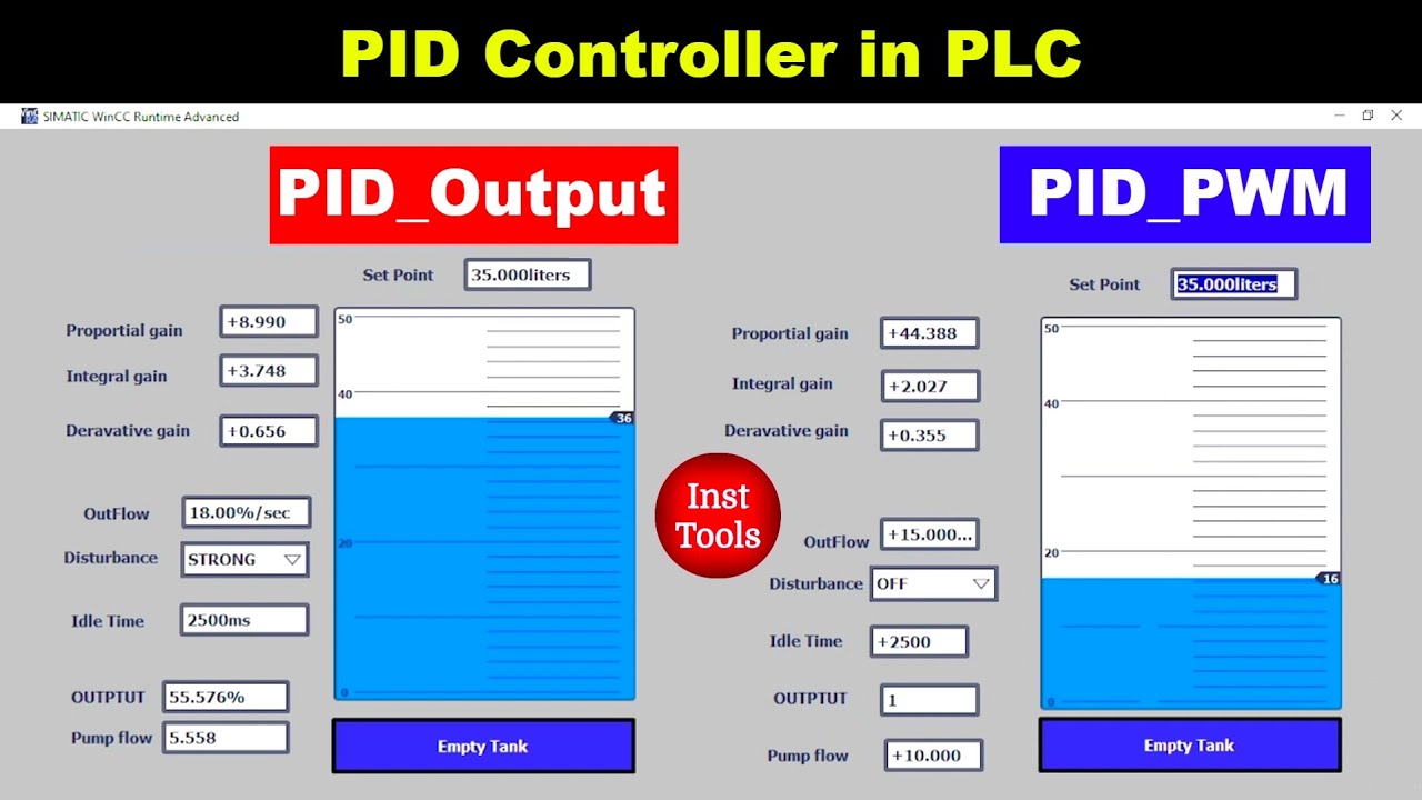

Explain the HMI Visualization
To be able to compare between the system behavior with the PWM output and output_PER we made the HMI visualization as you can see in pictures 13 and 14.
HMI Simulation for PID Controller
picture 13. HMI simulation.

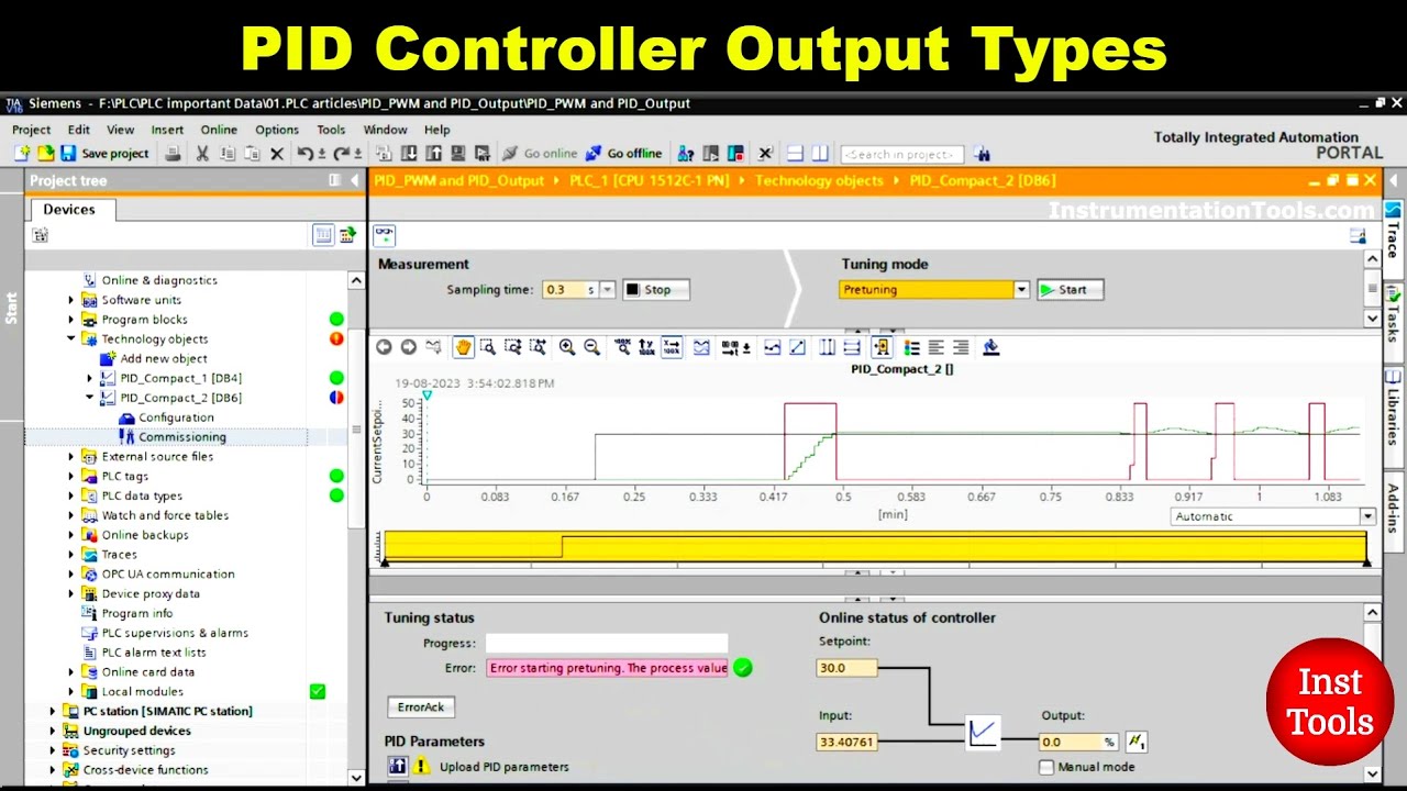

Auto-tuning of the PID Controller
picture 14. Tank 1 and Tank 2 simulation system
Putting the two tanks together will make it easier for our eyes to notice the different behavior of each tank system with the different PID output. In the last article we showed the auto-tuning procedure of the Output_PER PID block, so this time we will only show the auto-tuning of the Output_PWM of the PID block. See the next simulation video.
PID Controller Output Types Simulation - PID PWM and PID Output
You can see from the video, that the tuning was done easily using the TIA Portal, and the tank 2 system is stable and reaches the set point required in a reasonable manner. Notice the PWM of the PID output in the graph representation. Also, notice the ON/OFF behavior of the pump.
See the next simulation video comparing the behavior of the two tank systems.
PID Controller in PLC - Simulation of PID Types with Example
You may say that the tank 1 system is more stable and reaches the set point faster, but tank 2 is also a very accepted system. And both systems are ok. Off course in our case, the Output_PER is better because it has the advantage of using the full range of pump output from 0 to 10 liters/sec.
