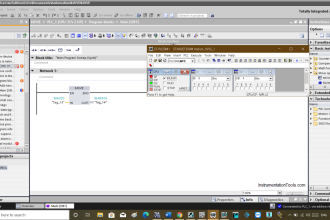

As you see from the last picture, you can set the execution of OB10, the start date, and the time of day at which the OB10 should be executed.
For the sake of simulation, we made the execution interval to be every minute so that every minute the OB10 will be called and executed. That means starting from the date of 3/23/2023 and time 09:25 AM the value of TimeOfDayInterruptCounter will increase by 1 every minute.
You have the option of setting the time according to the PLC system time or local time as you see from the last picture. In a previous article, we talked about the system and local time of the PLC, what each time mean, and how to configure and use them.
As we said before the local time is the time you see now on your PC.  So it is the actual time of the region where the PLC will be used.
You have to configure the local time for the PLC, depending on where it will be used. See picture 5.
Time delay interrupt in PLC
Picture 5 – Setting the local time for the PLC
Simple PLC Program Example
We added a time of day interrupt OB10 to our PLC program and we have set it so it will be executed every minute. We also have configured the local time of the PLC.
We created a simple logic of an ADD instruction to accumulate the value of the TimeOfDayInterruptCounter by 1 each time the OB10 is executed.
We will add another instruction, but in the main OB1, this instruction is RD_LOC_T or read local time, so we can see how the local time is progressing and compare it with the execution of OB10. See picture 6.
Configure Siemens Interrupt OB
Picture 6 – Simple program example
Compile your PLC program and start a new simulation.
Notice that we will set the time of day interrupt occurrence so that the OB10 can be called and executed while we are simulation the PLC logic. See the following simulation.
PLC Time of Day Interrupts
As you see from the animation, the value of TimeOfDayInterruptCounter is zero at the start and then it will be increased by 1 every minute starting from time 09:25 AM indicating that the OB10 is being executed every minute.
