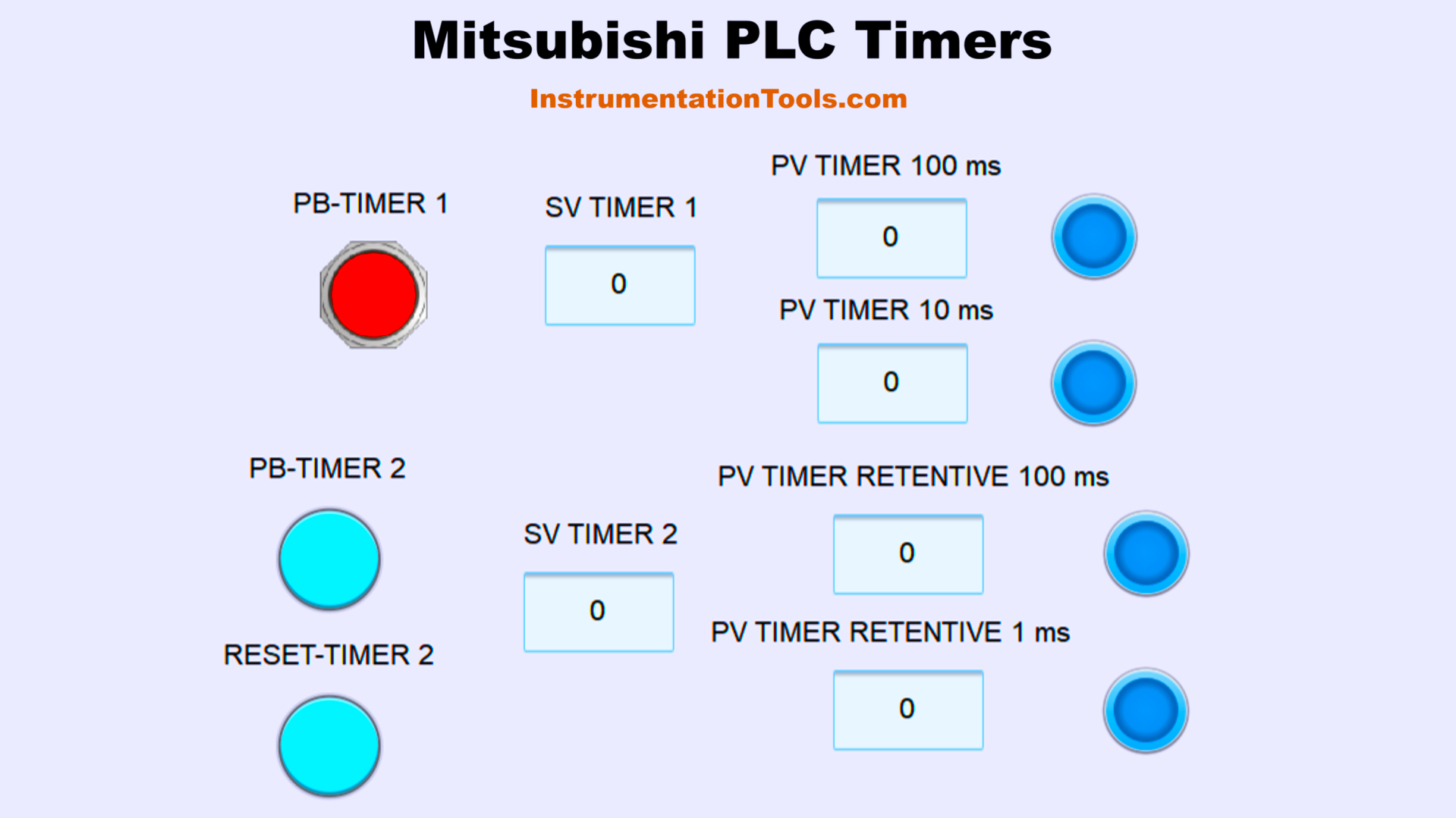

For testing purposes, in this program, both the 100 ms and 10 ms timer instructions will be activated by the same button with the same adjustable preset time.
Each timer will control a different output.

For testing purposes, in this program, both the Retentive 100 ms and Retentive 1 ms timer instructions will be activated using the same button with the same adjustable preset time.

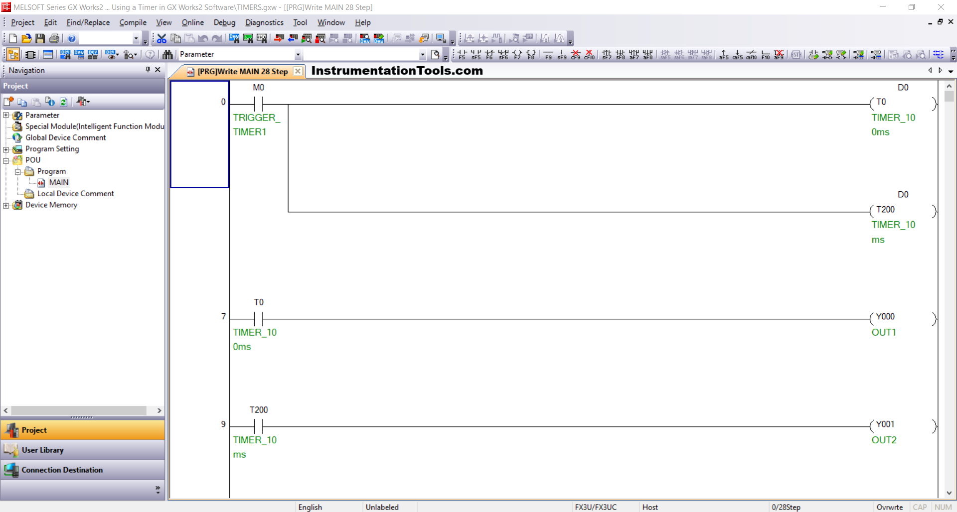

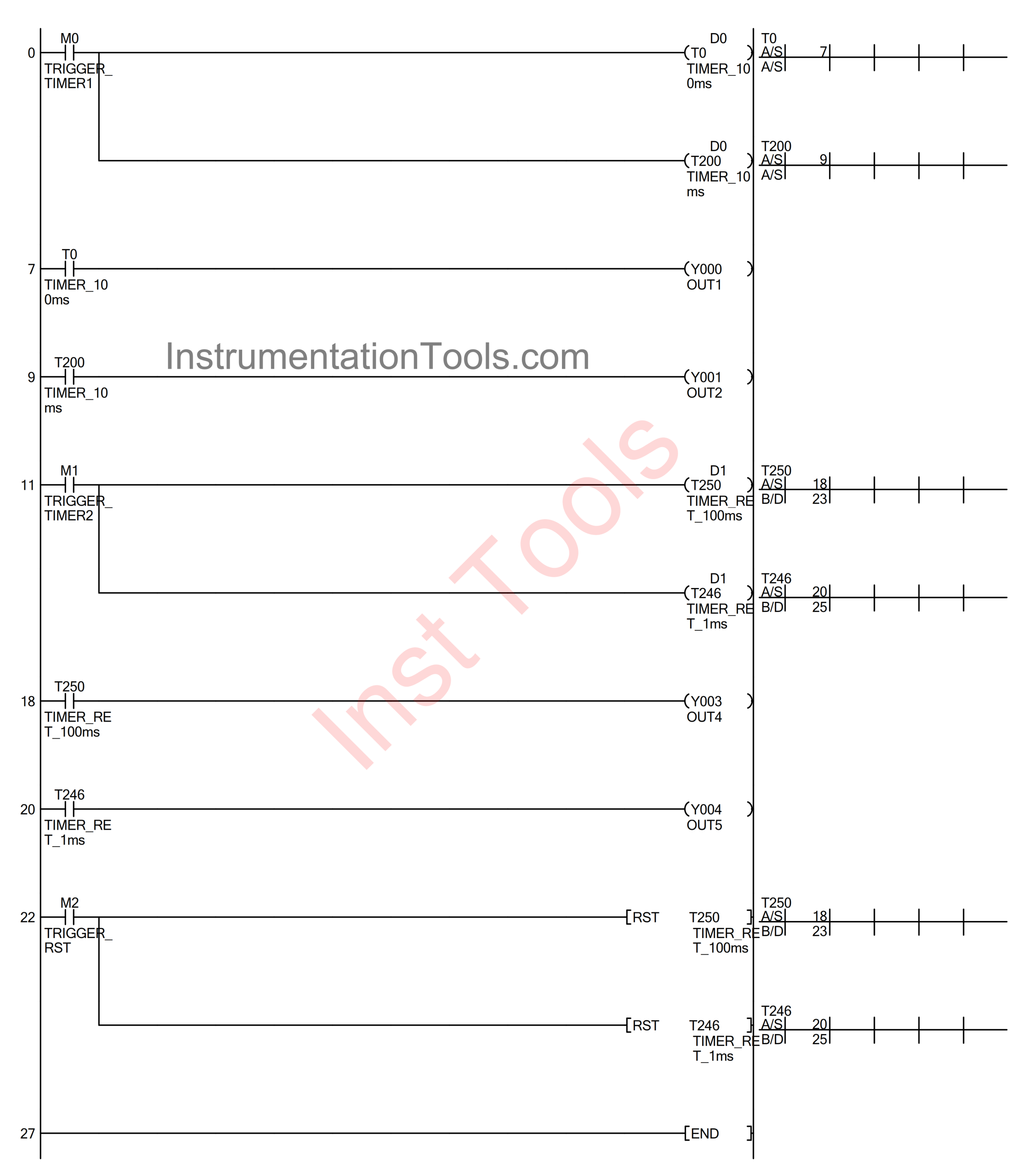

RUNG 0
In this Rung, if the TRIGGER_TIMER1 (M0) button is pressed, then the TIMER_100ms (T0) and TIMER_10ms (T200) timer instructions will start counting up according to the value set in the SV_TIMER1 (D0) memory word and when it has finished counting, the TIMER_100ms (T0) and TIMER_10ms (T200) timer instructions will be ON.
The TIMER_100ms (T0) and TIMER_10ms (200) timer instructions will be OFF if the TRIGGER_TIMER1 (M0) button has been released.
RUNG 7
In this Rung, the OUT1 (Y0) output will be ON if the NO contact of TIMER_100ms (T0) is in the HIGH state.
RUNG 9
In this Rung, the output OUT2 (Y1) will be ON if the NO contact of TIMER_10ms (200) is in the HIGH state.
RUNG 11

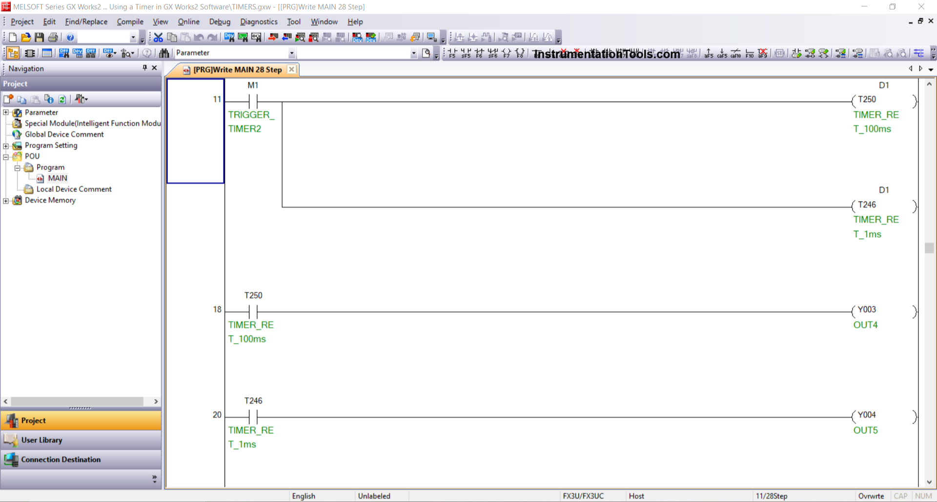

In this Rung, if the TRIGGER_TIMER2 (M1) button is pressed, then the TIMER_RET_100ms (T250) and TIMER_RET_1ms (T246) timer instructions will start counting up according to the value set in the SV_TIMER2 (D1) memory word. When the counting is finished, the TIMER_RET_100ms (T250) and TIMER_RET_1ms (T246) timer instructions will be ON.
The TIMER_RET_100ms (T250) and TIMER_RET_1ms (T246) timer instructions will be OFF if the TRIGGER_TIMER2 (M1) button has been released.
RUNG 18
In this Rung, the OUT4 (Y3) output will be ON if the NO contact of TIMER_RET_100ms (T250) is in the HIGH state.

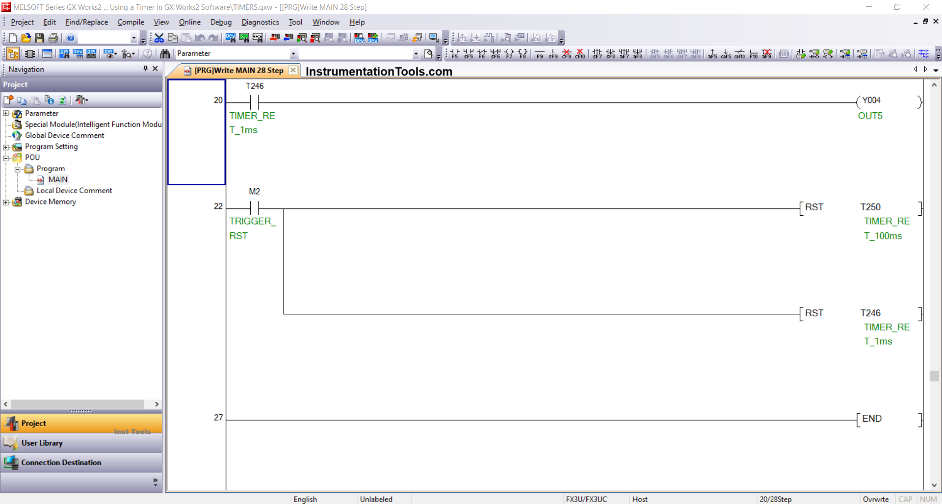

RUNG 20
In this Rung, output OUT5 (Y4) will be ON if the NO contact of TIMER_RET_1ms (T246) is in the HIGH state.
RUNG 22
In this Rung, if the TRIGGER_RST (M2) button is pressed, then the timer instructions TIMER_RET_100ms (T250) and TIMER_RET_1ms (T246) will be OFF, and the PV time data is reset to zero “0”.
