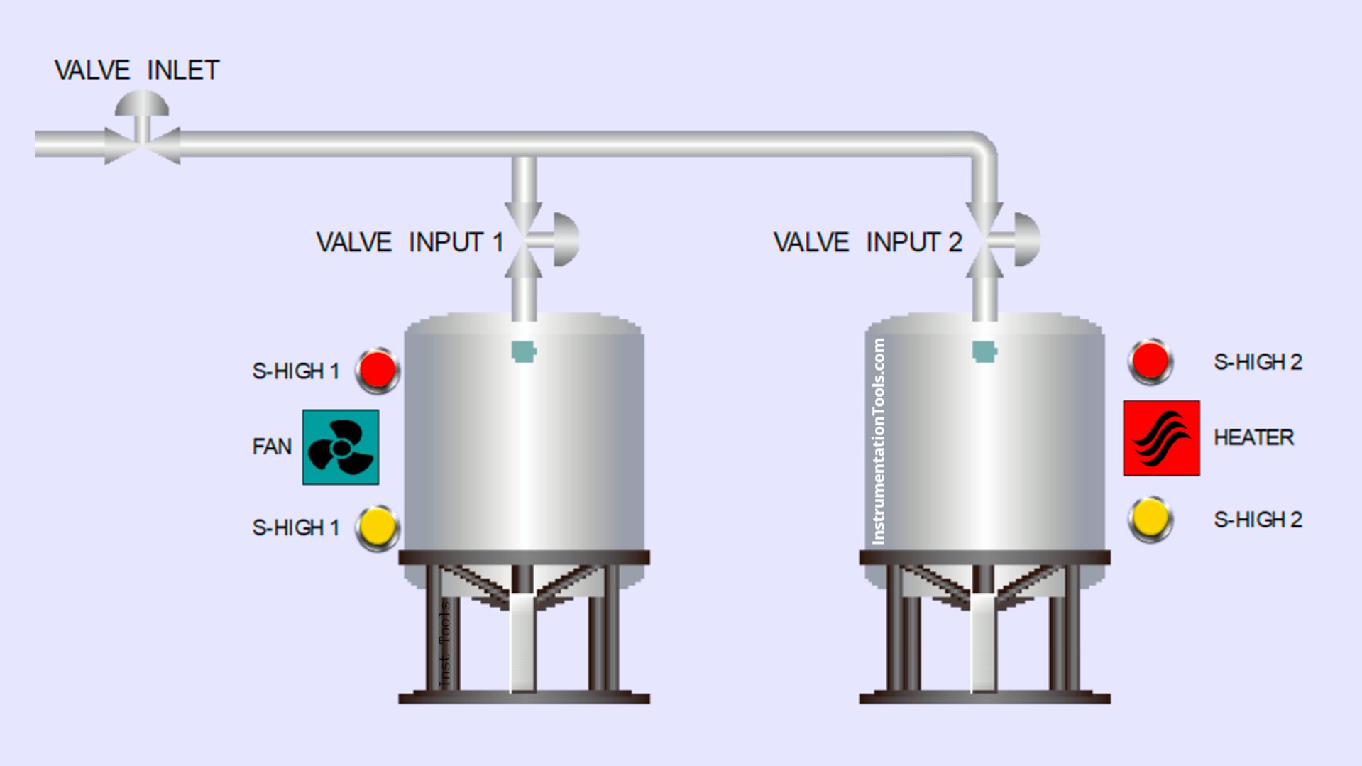

1. Parallel Tank System
- Two tanks (1 & 2) are connected to the same water source.
- Each tank has its own input valve.
- The main inlet valve opens when the system is activated.
2. Tank Functions
- Tank 1: Cold water.
- Tank 2: Hot water.
3. Automatic Filling
- If the water level is below the minimum, the input valve opens.
- Filling stops once the maximum level is reached.
4. Heater & Cooler Activation
- When tanks are full:
- Tank 2 → Heater is activated.
- Tank 1 → Cooling fan is activated.
5. Operating Conditions
- Heater and fan only operate if the tanks contain water.

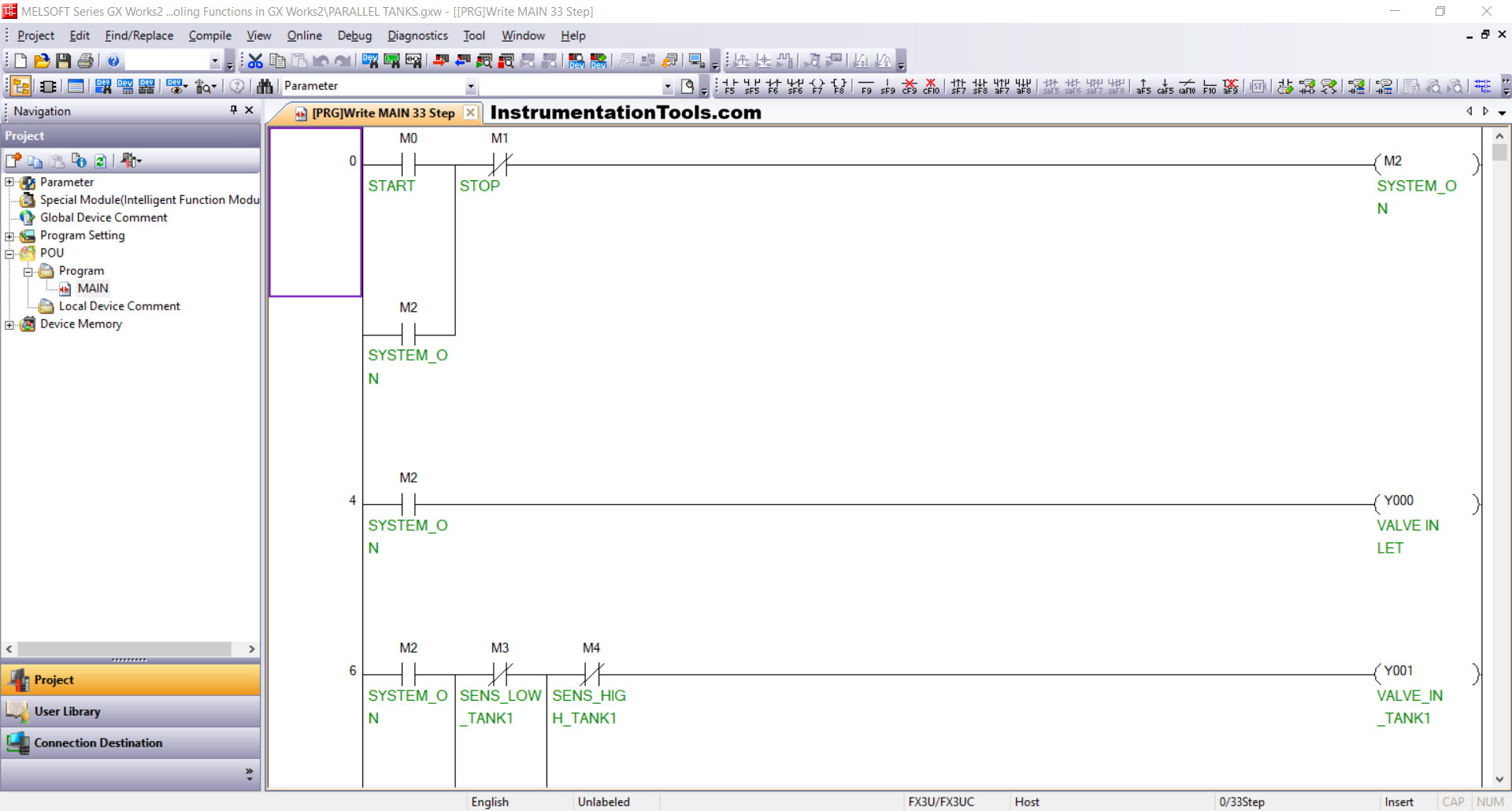

In this Rung, the memory bit SYSTEM_ON (M2) will be in a HIGH state if the START (M0) button is pressed. Even though the START (M0) button has been released, the memory bit SYSTEM_ON (M2) will remain in a HIGH state, because it uses Latching.
If the STOP (M1) button is pressed, the memory bit SYSTEM_ON (M2) will be in a LOW state.
RUNG 4
In this Rung, the VALVE_INLET (Y000) output will be OPEN if the NO contact of the memory bit SYSTEM_ON (M2) is in a HIGH state.
If the NO contact of the memory bit SYSTEM_ON (M2) is in a LOW state, the VALVE_INLET (Y000) output will be CLOSED.
RUNG 6

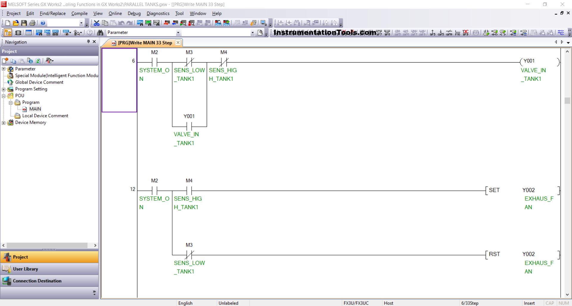

When the NO contact of the memory bit SYSTEM_ON (M2) is in the HIGH state and the NC contact of the SENS_LOW_TANK1 (M3) and SENS_HIGH_TANK1 (M4) sensors are in the LOW state, the VALVE_IN_TANK1 (Y001) output will be OPEN.
The VALVE_IN_TANK1 (Y001) output will remain OPEN even though the NC contact of the SENS_LOW_TANK1 (M3) sensor is in the HIGH state. Because it uses Latching.
When the NC contact of the SENS_HIGH_TANK 1(M4) sensor is in the HIGH state, the VALVE_IN_TANK1 (Y001) output will be CLOSED.
RUNG 12
In this Rung, if the NO contact of the memory bit SYSTEM_ON (M2) and the SENS_HIGH_TANK1 (M4) sensor, and the NC contact of the SENS_LOW_TANK1 (M3) sensor are in the HIGH state, then the EXHAUST_FAN (Y002) output will be ON.
When the NO contact of the SENS_HIGH_TANK1 (M4) sensor and the NC contact of the SENS_LOW_TANK1 (M3) sensor are in the LOW state, then the EXHAUST_FAN (Y002) output will be OFF.

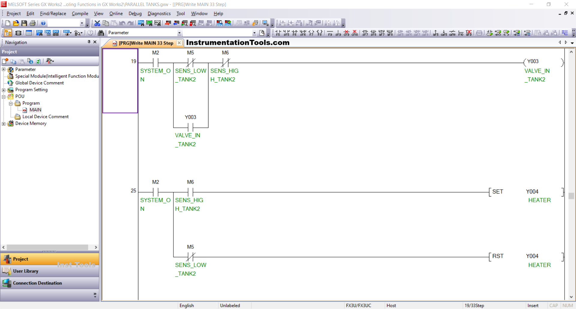

The output VALVE_IN_TANK2 (Y003) will be OPEN when the NO contact of the memory bit SYSTEM_ON (M2) is in the HIGH state and the NC contacts of the SENS_LOW_TANK2 (M5) and SENS_HIGH_TANK2 (M6) sensors are in the LOW state.
Although the NC contact of the SENS_LOW_TANK2 (M5) sensor is in the HIGH state, the output VALVE_IN_TANK2 (Y003) will remain OPEN. Because it uses Latching.
When the NC contact of the SENS_HIGH_TANK2 (M6) sensor is in the HIGH state, the output VALVE_IN_TANK2 (Y003) will be CLOSED.
RUNG 25
In this Rung, if the NO contact of the memory bit SYSTEM_ON (M2) and the SENS_HIGH_TANK2 (M6) sensor, and the NC contact of the SENS_LOW_TANK2 (M5) sensor are in the HIGH state, then the HEATER (Y004) output will be ON.
When the NO contact of the SENS_HIGH_TANK2 (M6) sensor and the NC contact of the SENS_LOW_TANK2 (M5) sensor are in the LOW state, then the HEATER (Y004) output will be OFF.
