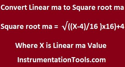

This formula used to convert transmitter Linear Percentage to Square root Percentage conversion. Calculating the equivalent Square root Percentage for any given Linear Percentage.
 Formula:
 Square root % = Sqrt(X).(10)
Where
X is Linear Percentage Value
Example:
Convert 50 % linear to square root
Square root % = √X*10
Square root % = √50*10
Square root % =Â 70.71%

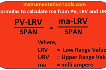

Convert current (4-20)ma to (0-100)%
Calculate 4-20ma from percentage

Convert Linear mA to Square root mA

linear ma to square root ma explain
Hello Manivannan, Its already published. Pl Check in Formulas Category. Thanks
