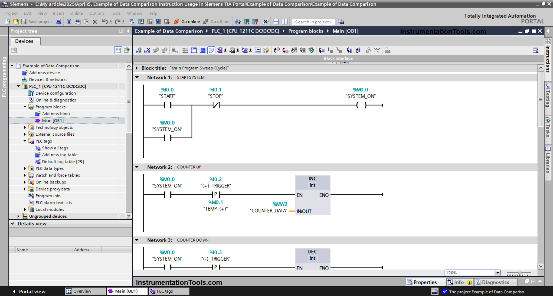

NETWORK 1 (SYSTEM_ON)
In this Network, the memory bit SYSTEM_ON (M0.0) will be in a HIGH state if the START (I0.0) button is pressed. the memory bit SYSTEM_ON (M0.0) will remain in a HIGH state even though the PB_START (I0.0) button has been released. Because it uses Latching.
If the STOP (I0.1) button is pressed, the memory bit SYSTEM_ON (M0.0) will return to a LOW state.
NETWORK 2 (COUNTER UP)
In this Network, the value in the memory word COUNTER_DATA (MW2) will increase (+1) when the NO contact of the memory bit SYSTEM_ON (M0.0) is in a HIGH state and the (+)_TRIGGER (I0.2) button is pressed.
The Increment / INC instruction will add (+1) to the memory word data when triggered.

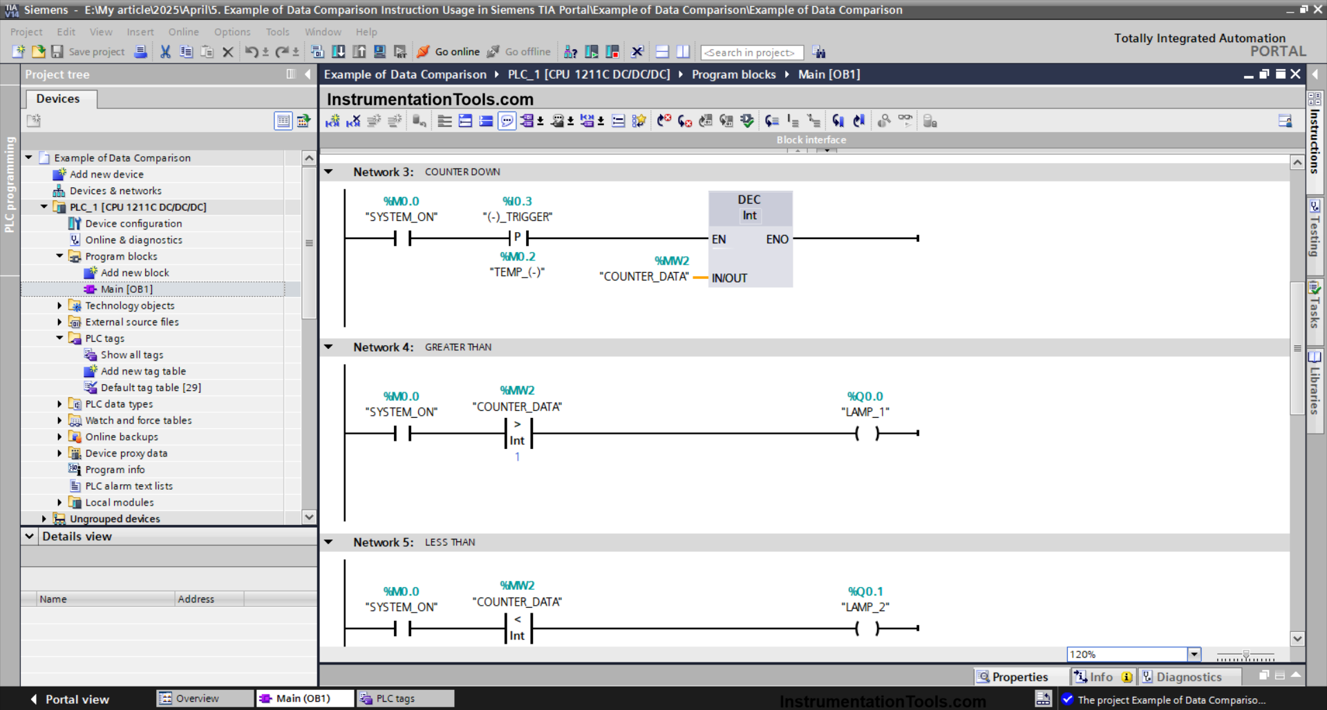

NETWORK 3 (COUNTER DOWN)
In this Network, when the NO contact of the memory bit SYSTEM_ON (M0.0) is in a HIGH state and the
(-)_TRIGGER (I0.3) button is pressed, the value in the memory word COUNTER_DATA (MW2) will decrease by (-1).
The Decrement / DEC instruction will subtract (-1) from the memory word data when triggered.
NETWORK 4 (GREATER THAN)
In this Network, the output LAMP_1 (Q0.0) will be ON if the contact NO of the memory bit SYSTEM_ON (M0.0) is in the HIGH state and the value in the memory word COUNTER_DATA (MW2) is Greater Than “1”.

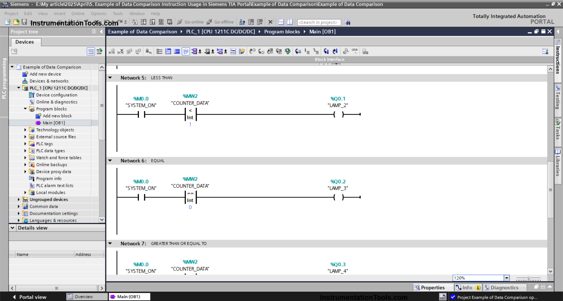

NETWORK 5 (LESS THAN)
In this Network, the output LAMP_2 (Q0.1) will be ON if the NO contact of the memory bit SYSTEM_ON (M0.0) is in the HIGH state and the value in the memory word COUNTER_DATA (MW2) is Less Than “1”.
NETWORK 6 (EQUAL)
In this Network, the output LAMP_3 (Q0.2) will be ON if the contact NO of the memory bit SYSTEM_ON (M0.0) is in the HIGH state and the value in the memory word COUNTER_DATA (MW2) is Equal To “0”.

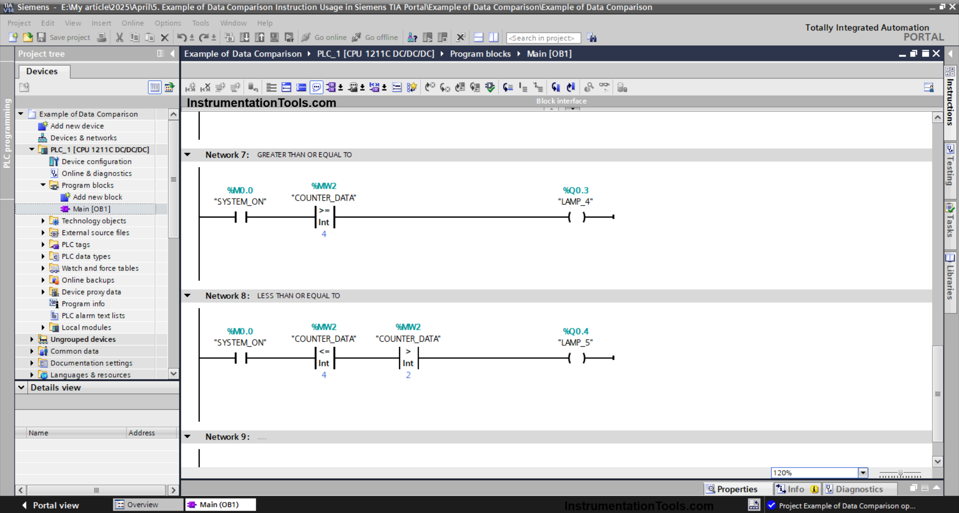

NETWORK 7 (GREATER THAN OR EQUAL)
In this Network, the LAMP_4 (Q0.3) output will be ON if the NO contact of the memory bit SYSTEM_ON (M0.0) in the HIGH state and the value in the memory word COUNTER_DATA (MW2) is Greater Than or Equal To “4”.
NETWORK 8 (LESS THAN OR EQUAL)
In this Network, the LAMP_5 (Q0.5) output will be ON if the NO contact of the memory bit SYSTEM_ON (M0.0) is in HIGH state and the value of the memory word COUNTER_DATA (MW2) is Less Than or Equal To “4” and Greater Than “2”.
