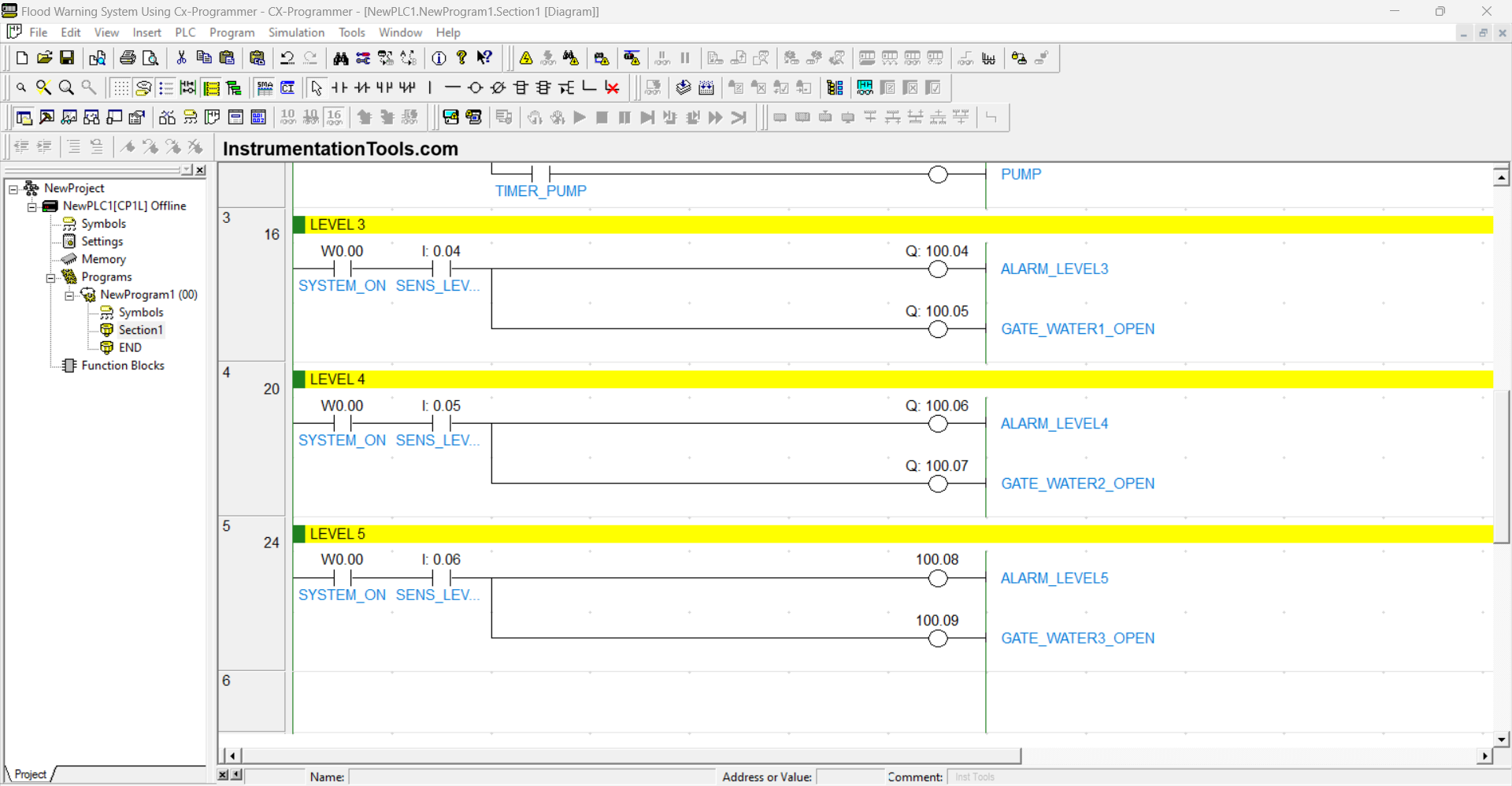

RUNG 0 (START_SYSTEM)
In this Rung, when the START (0.00) button is pressed, the memory bit SYSTEM_ON (W0.00) will be in the HIGH state. Because it uses the KEEP(011) instruction, the memory bit SYSTEM_ON (W0.00) will remain in the HIGH state even though the START (0.00) button has been released.
The memory bit SYSTEM_ON (W0.00) will be in the LOW state if the STOP (0.01) button is pressed.
RUNG 1 (LEVEL 1)
In this Rung, when the NO contact of the memory bit SYSTEM_ON (W0.00) and the sensor SENS_LEVEL1 (0.02) are in the HIGH state, the output ALARM_LEVEL1 (100.00) will be ON.
RUNG 2 (LEVEL 2)
In this Rung, when the NO contact from the memory bit SYSTEM_ON (W0.00) and the sensor SENS_LEVEL2 (0.03) are in the HIGH state, the output ALARM_LEVEL2 (100.01) will be ON and the output VALVE (100.02) will be OPEN.
The timer TIMER_PUMP (T0000) will start counting up to 2 seconds when the NO contact of VALVE (100.02) is in the HIGH state. After the timer TIMER_PUMP (T0000) has finished counting, the output PUMP (100.03) will turn ON.
RUNG 3 (LEVEL 3)
In this Rung, when the NO contact of the memory bit SYSTEM_ON (W0.00) and the sensor SENS_LEVEL3 (0.04) are in the HIGH state, the output ALARM_LEVEL3 (100.04) will be ON and the output GATE_WATER1_OPEN (100.05) will be OPEN.
RUNG 4 (LEVEL 4)
In this Rung, when the NO contact of the memory bit SYSTEM_ON (W0.00) and the sensor SENS_LEVEL4 (0.05) are in the HIGH state, the output ALARM_LEVEL4 (100.06) will be ON and the output GATE_WATER2_OPEN (100.07) will be OPEN.
RUNG 5 (LEVEL 5)
In this Rung, when the NO contact of the memory bit SYSTEM_ON (W0.00) and the sensor SENS_LEVEL5 (0.06) are in the HIGH state, the output ALARM_LEVEL5 (100.08) will be ON and the output GATE_WATER3_OPEN (100.09) will be OPEN.
