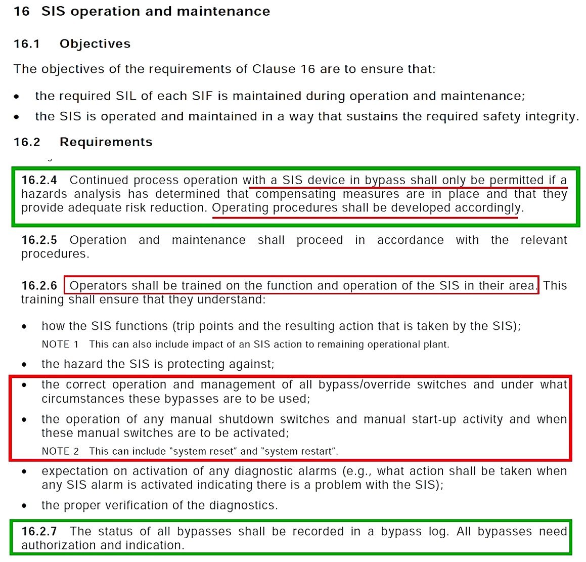

Safety Bypass Conditions
Section 16- SIS Operation and Maintenance of IEC 61511 declares some Safety Bypass conditions. (Figure-4)
Figure 4: Some Safety Bypass Conditions/ Requirements in IEC-61511
Bypassing is Restricted During Continued Process Operation
Clause 16.2.4 of this standard obligates Hazard Analysis for compensating measures, adequate risk reduction, and operating procedures as:
Continued process operation with a SIS device in bypass shall only be permitted if a hazards analysis has determined that compensating measures are in place and that they provide adequate risk reduction. Operating procedures shall be developed accordingly.
At first glance, it shall be noticed that SIS device bypassing is a continuous process operation restricted only by satisfying some conditions (and is not a normal act). On the other hand, before any override/bypass is applied, the implications of doing so shall be fully understood, and adequate additional measures shall be applied to reduce the consequential risk of operating without automatic protection.
However, in several points in the standard, it is declared that SIS under bypassing will be degraded.

Bypass Status Record
In 16.2.7 of the standard, it is mentioned:
“The status of all bypasses shall be recorded in a bypass log. All bypasses need authorization and indication.”
Since, as mentioned, bypassing is not a normal routine act, the status of all bypasses shall be recorded and logged, in order to make a regular and traceable sequence of actions and existing risks (with possible following consequences).
Authorization and Required Competency
As mentioned in 16.2.6 and 16.2.7 of the standard, all bypasses need authorization (and indication) further to some required competencies, which are described below. Two main items of them.
The correct operation and management of all bypass/override switches and under what circumstances these bypasses are to be used; the operation of any manual shutdown switches and manual start-up activity, and when these manual switches are to be activated.
Although the bypass design shall be done in such a case that the operator error shall be prevented, security protection shall be considered to prevent unauthorized bypass activation (e.g., by key lock or password protection) as mentioned in 11.7.2.2 and 11.7.2.3 of the standard (and shown in Figure 5).

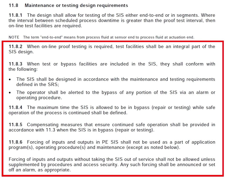

Bypassing Time Limit
It is clear that since bypassing will degrade the considered safety so it shall have a time limit and be removed as soon as possible. This condition, further to the insistence on other conditions, is shown in Figure 6.
Figure 6: Some Safety Bypass Limiting Conditions/ Requirements in IEC-61511
Bypassing for Device Repair or Proof Testing
As it can be concluded from Figure 6, the main target of Bypass/ Override of the SIS device during Process Normal Operation is returned to Device Repair (maintenance) or Proof Testing.

Forcing is not equal to Bypass or Override
It shall be mentioned that the forcing of inputs and outputs in Programmable Electronics (PE) is not equal to Bypass/Override, as declared in 11.8.6:
Forcing of inputs and outputs in PE SIS shall not be used as a part of application program(s), operating procedure(s) and maintenance (except as noted below).
Forcing of inputs and outputs without taking the SIS out of service shall not be allowed unless supplemented by procedures and access security. Any such forcing shall be announced or set off an alarm, as appropriate.

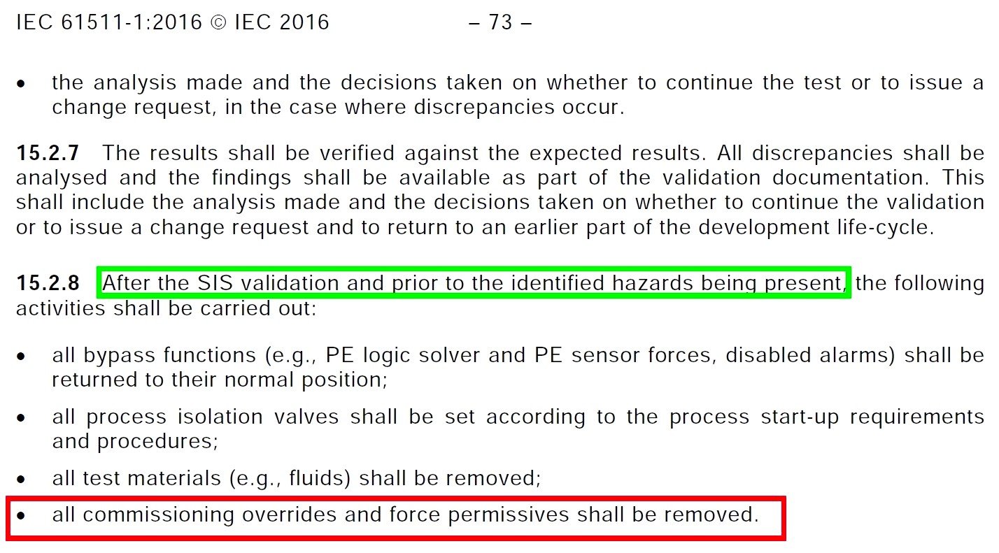

Validating Bypassing
In any case, all Force Bypassing (permissive) or Commissioning Override shall be validated and then removed before making the process plant run in normal operation (i.e., after SIS validation) as stated in the standard (Figures 7 and 8).
Figure 7: Safety Bypass Validation Conditions/ Requirements in IEC-61511
Figure 8: Safety Bypass after Validation Conditions/ Requirements in IEC-61511
