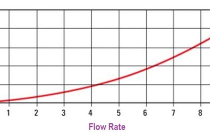

The pressure drop across the orifice ( ΔP in Fig.) increases when the rate of flow increases. When there is no flow there is no differential.
The differential pressure is proportional to the square of the velocity, therefore, follows that if all other factors remain constant, then the differential is proportional to the square of the rate of flow.
