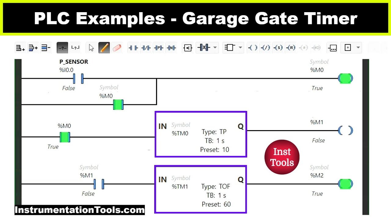

Problem Statement:
We are using one Sensor & “Parking Paid” status to control the Garage Gate.
When a Car arrives then open the gate for 10 seconds. If the car leaves within 1 minute, then the gate opens automatically.
After 1 minute, the gate will be opened when the status is “parking paid”.

Inputs and Outputs
Digital Inputs:
Sensor: I0.0
Parking Paid: I0.1
Digital Outputs:
Garage Gate: Q0.0
PLC Ladder Logic
Automated Garage Gate Control - PLC Ladder Logic
Logic Explained
We have used Normally Open Contacts for P-Sensor(I0.0), Parking Paid (I0.1) and Memory Bits.
In Rung 0:
  1. Normally Open Contact is used for P-Sensor (I0.0) to Turn ON Memory Bit 1 (M0).
  2. Memory Bit 1 (M0) is latched so that when P-sensor (I0.0) turns OFF, Memory Bit 1 (M0) still remains ON.
In Rung 1:
  1. Normally Open Contact is used for Memory Bit 1 (M0) to Turn ON Memory Bit 2 (M1).
  2. Timer-type TP is used to Turn ON Memory Bit 2 (M1) for a limited time.
In Rung 2:
  1. Normally Open Contact is used for Memory Bit 1 (M0) to Turn ON Memory Bit 3(M2).
  2. Timer-type TON is used to delay the turning ON time of Memory Bit 3(M2) for some time.
In Rung 3:
  1. Normally Open Contact is used for Memory Bit 2 (M1), Memory Bit 3 (M2), P-Sensor (I0.0), and Parking Paid (I0.1) to Turn ON  the output Garage Gate (Q0.0).
  2. Memory Bit 2 (M1), Memory Bit 3 (M2) + P-Sensor (I0.0), and Parking Paid (I0.1) are connected in parallel, thus implementing OR Logic Gate.
  3. Memory Bit 3 (M2) and P-Sensor (I0.0) are connected in series, thus implementing AND Logic Gate.
