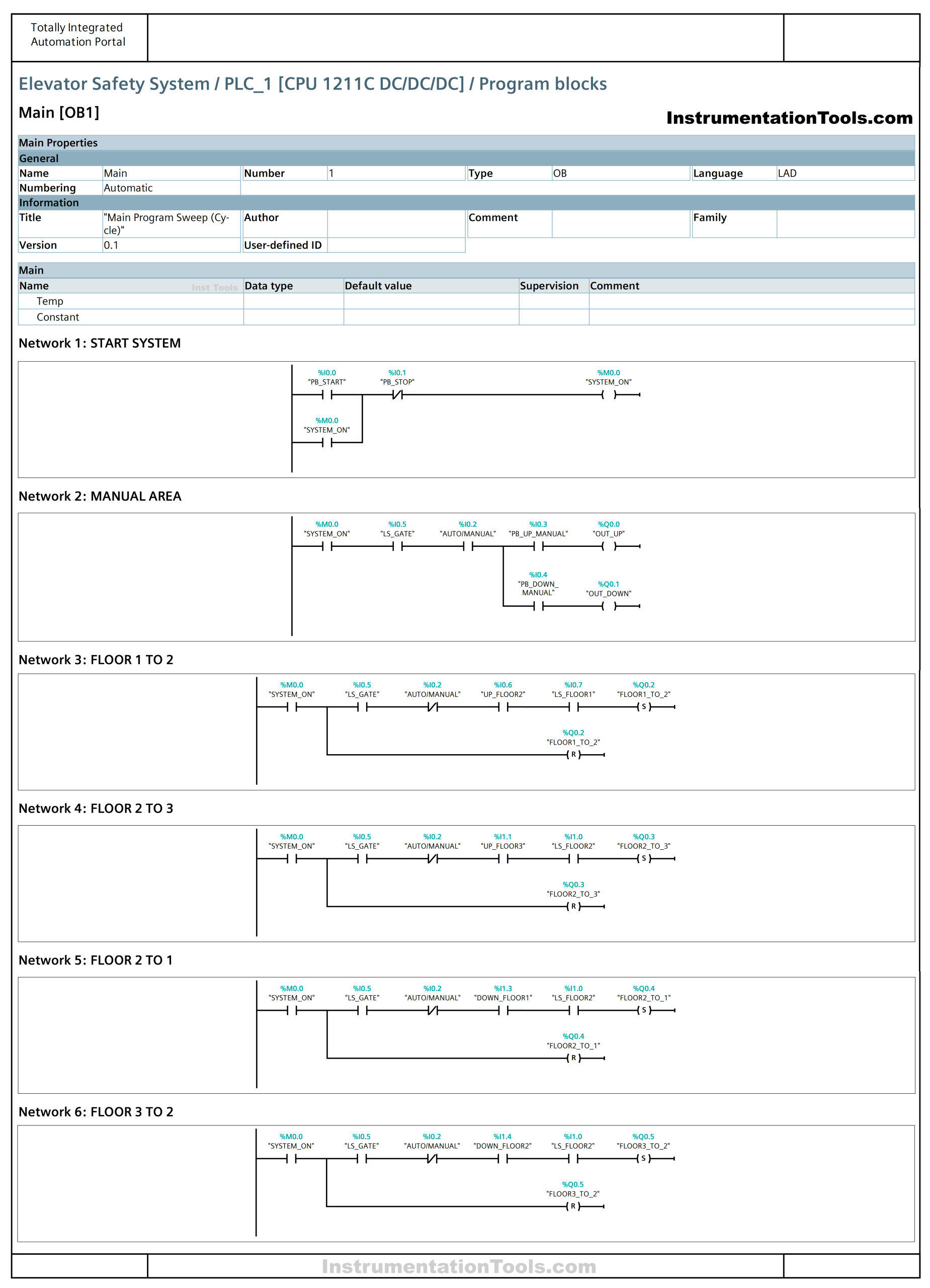

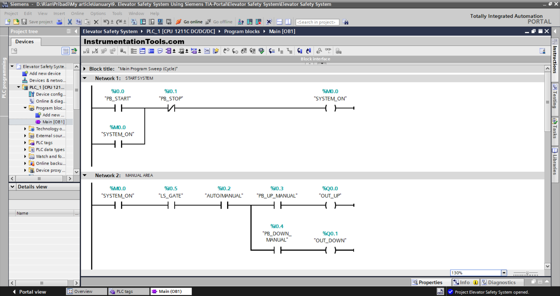

NETWORK 1 (START SYSTEM)
In this Network, when the PB_START (I0.0) button is Pressed, the memory bit SYSTEM_ON(M0.0)will be in the HIGH state. Because it uses the Latching Instruction, even though the PB_START (I0.0) button has been Released, the memory bit SYSTEM_ON(M0.0) will remain in the HIGH state.
If the PB_STOP (I0.1) button is Pressed, the memory bit SYSTEM_ON(M0.0) will be in the LOW state.
NETWORK 2 (MANUAL AREA)
In this Network, when the NO contact of the memory bit SYSTEM_ON(M0.0), the Limit Switch LS_GATE (I0.5), and the Selector Switch AUTO/MANUAL (I0.2) are in the HIGH state, and the PB_UP_MANUAL (I0.3) button Pressed, the output OUT_UP(Q0.0) will be ON.
When the NO contact of the memory bit SYSTEM_ON (M0.0), Limit Switch LS_GATE (I0.5), and Selector Switch AUTO/MANUAL (I0.2) are in the HIGH state, and the PB_DOWN_MANUAL (I0.4) button is Pressed, the output OUT_DOWN (Q0.1) will be ON.
Designing Elevator Interlock Logic in Siemens PLC

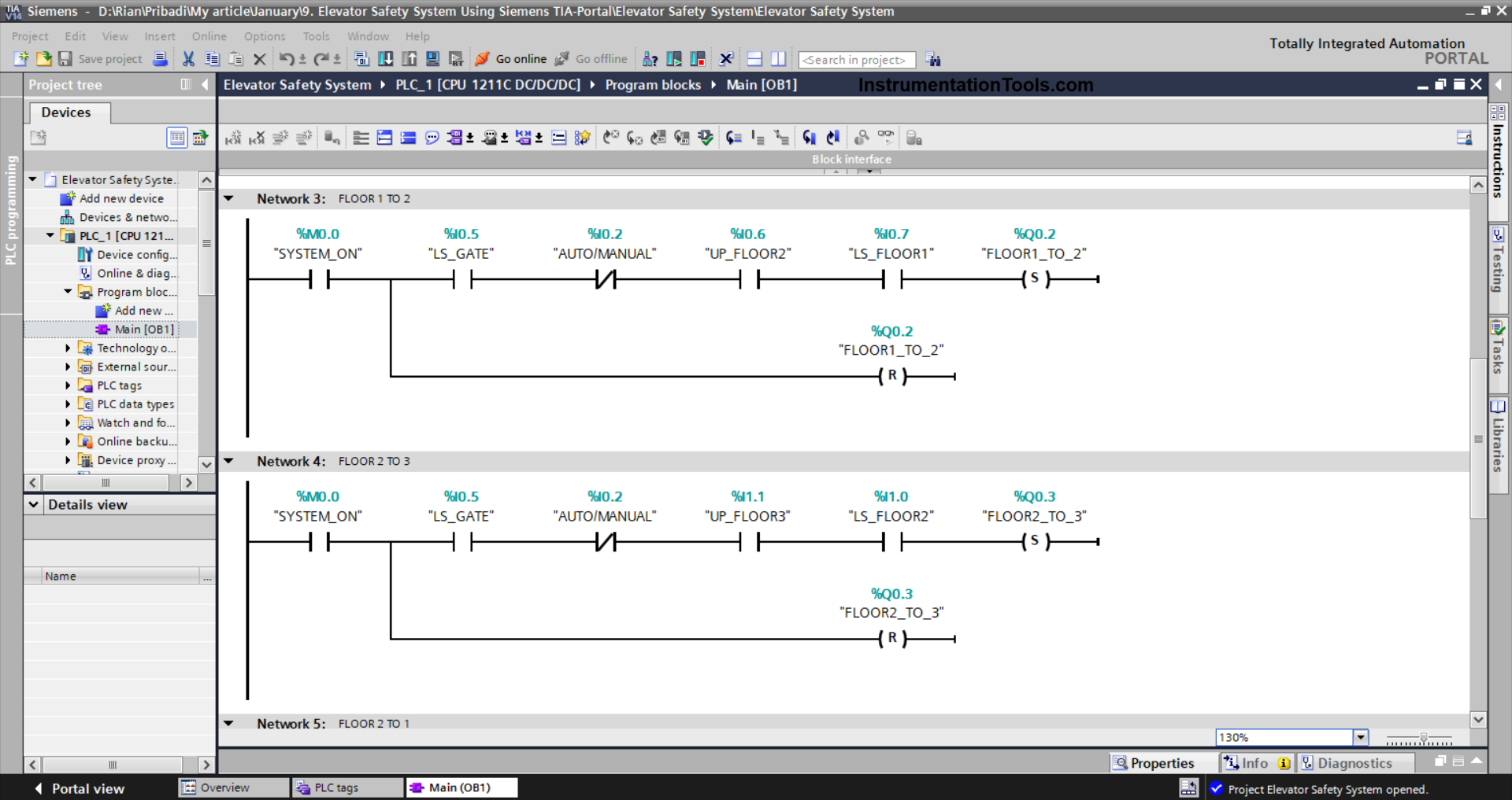

NETWORK 3 (FLOOR 1 to 2)
In this Network, the output FLOOR1_TO_2 (Q0.2) will be ON if the NO contact of the memory bit SYSTEM_ON (M0.0), Limit Switch LS_GATE (I0.5), and LS_FLOOR1 (I0.7) are in the HIGH state, and the UP_FLOOR2 (I0.6) button is Pressed.
Because it uses the SET Output Instruction, even though the UP_FLOOR2 (I0.6) button has been Released and the Limit Switch LS_FLOOR1(I0.7) is in the LOW state, the FLOOR1_TO_2(Q0.2) output state will remain in the ON state.
If the NO contact of the Limit Switch LS_FLOOR2 (I1.0) is in the HIGH state, then the output FLOOR1_TO_2 (Q0.2) will be OFF. Because it uses the RESET Output Instruction.
NETWORK 4 (FLOOR 2 to 3)
In this Network, the output FLOOR2_TO_3 (Q0.3) will be ON when the NO contact of the memory bit SYSTEM_ON (M0.0), Limit Switch LS_GATE (I0.5), and LS_FLOOR2 (I1.0) are in the HIGH state, and the UP_FLOOR3 (I1.1) button is Pressed.
Because it uses the SET Output Instruction, even though the UP_FLOOR3 (I1.1) button has been Released and the Limit Switch LS_FLOOR2 (I1.0) is in the LOW state, the FLOOR2_TO_3 (Q0.3) output state will remain in the ON state.
If the NO contact of the Limit Switch LS_FLOOR3 (I1.2) is in the HIGH state, then the output FLOOR2_TO_3 (Q0.3) will be OFF. Because it uses the RESET Output Instruction.
Elevator Programming in Siemens TIA Portal

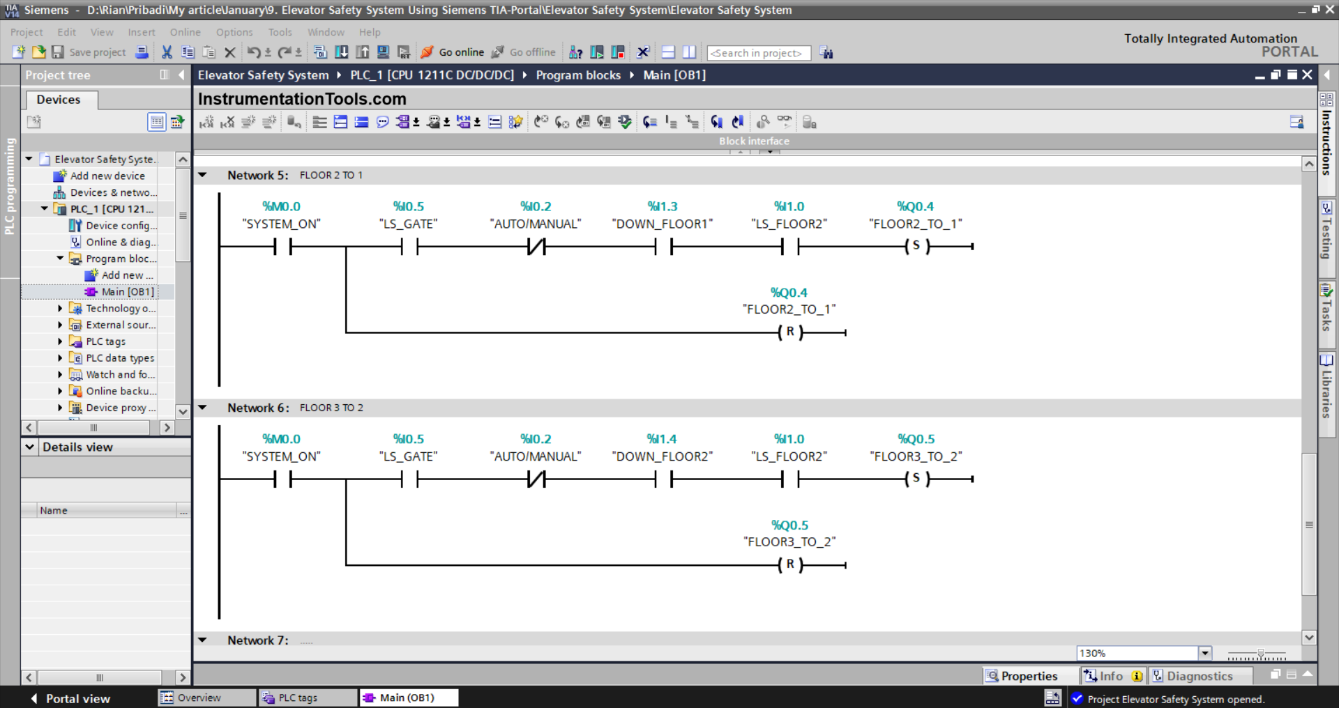

NETWORK 5 (FLOOR 2 to 1)
In this Network, the output FLOOR2_TO_1 (Q0.4) will be ON when the NO contact of the memory bit SYSTEM_ON (M0.0), the Limit Switch LS_GATE (I0.5), and LS_FLOOR2 (I1.0) are in the HIGH state, and the DOWN_FLOOR1 (I1.3) button is Pressed.
Because it uses the SET Output Instruction, even though the DOWN_FLOOR1 (I1.3) button has been Released and the Limit Switch LS_FLOOR2 (I1.0) is in the LOW state, the FLOOR2_TO_1 (Q0.4) output state will remain in the ON state.
If the NO contact of the Limit Switch LS_FLOOR1 (I0.7) is in the HIGH state, then the output FLOOR2_TO_1 (Q0.4) will be OFF. Because it uses the RESET Output Instruction.
NETWORK 6 (FLOOR 3 to 2)
In this Network, the output FLOOR3_TO_2 (Q0.5) will be ON when the NO contact of the memory bit SYSTEM_ON (M0.0), the Limit Switch LS_GATE (I0.5), and LS_FLOOR2 (I1.0) are in the HIGH state, and the DOWN_FLOOR2 (I1.4)   button is Pressed.
Because it uses the SET Output Instruction, even though the DOWN_FLOOR2 (I1.4) button has been Released and the Limit Switch LS_FLOOR3 (I1.2) is in the LOW state, the FLOOR3_TO_2 (Q0.5) output state will remain in the ON state.
If the NO contact of the Limit Switch LS_FLOOR2 (I1.0) is in the HIGH state, then the output FLOOR3_TO_2 (Q0.5) will be OFF. Because it uses the RESET Output Instruction.
