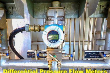

Check the datasheet of the DP type flow transmitter and note down the ranges. Here we need two range values. One is in mmH2O which is the DP range and the second one is the actual flow range which is in m3/hr range (or any other units)
Take out the range of the transmitter from the data sheet of the DP type Flow transmitter. Here you will see two ranges. One is in mmH2O which is the DP range. Another is the m3/hr range which is the output flow range.
