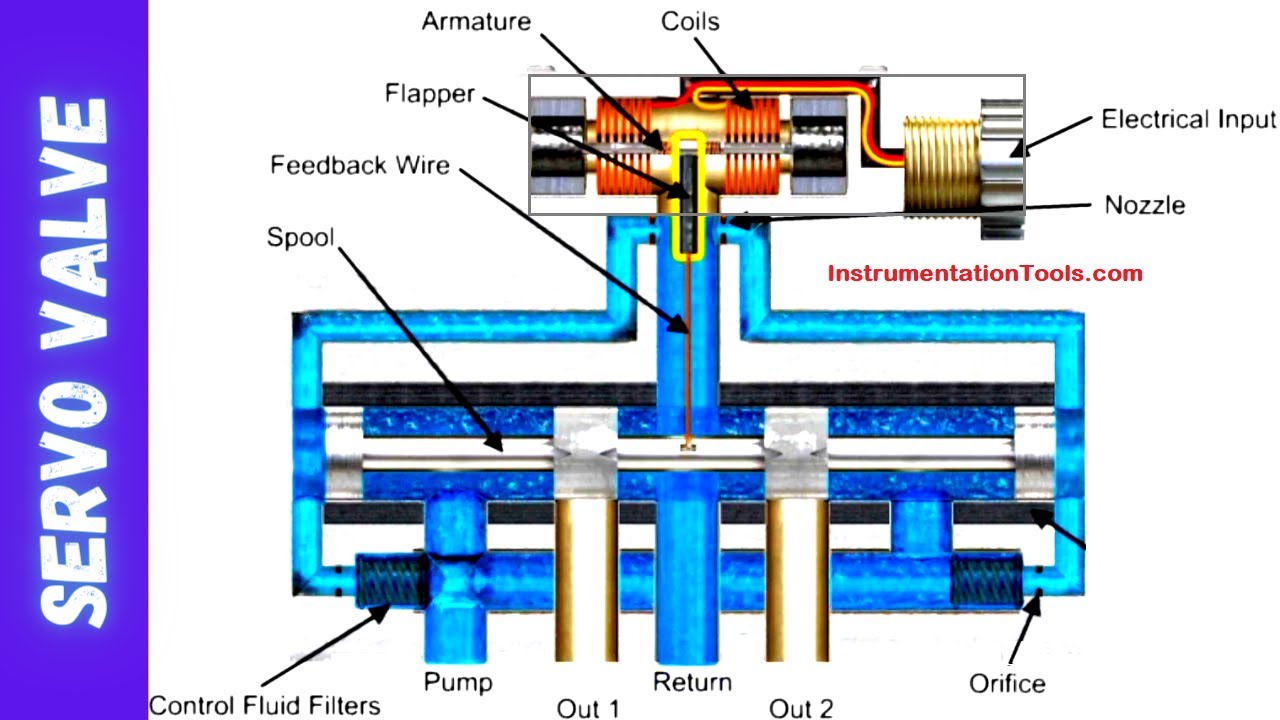

Servo Valve Principle
As you must have understood, a servo valve works on the basis of PID control or closed-loop control. The valve accepts electrical analog signals from the PLC in the form of 0-10 V or 4-20 mA. A feedback wire is connected inside the circuit, for giving feedback to the controller inside the valve. When a command is given to open or close the valve at a desired percentage, the valve starts to move to that position.
In a PID controller, you must have seen how fast the output operates when the error between the setpoint and current value is large and becomes slower when the error becomes minimal or zero. In a similar way, the valve speed is high when the difference between the set position and the actual position is high. When it reaches near the position, its speed starts to decrease.
As long as it does not achieve the set position, it will continue to increment or decrease its position. Once the position has been achieved and if for any reason the position is misaligned, then again it will try to get back to that original position. Due to this, the servo valve can provide accurate control of the position, velocity, and also acceleration of the actuator.
LVDT-Operation-Principle-Animation
LVDT Animation
The feedback signal used inside is an LVDT (linear variable differential transformer). It is a distance transducer that converts physical signals of distance into electrical signals. The main mechanism of the valve is a spool on which this sensor is mounted and the movement on this spool rod is tracked continuously.
Based on the feedback and the control command received, the spool moves continuously to keep the actual valve position in the desired place. Similar to servo drives and motors, the feedback received in a servo valve can be of three types – position, speed, and force.
