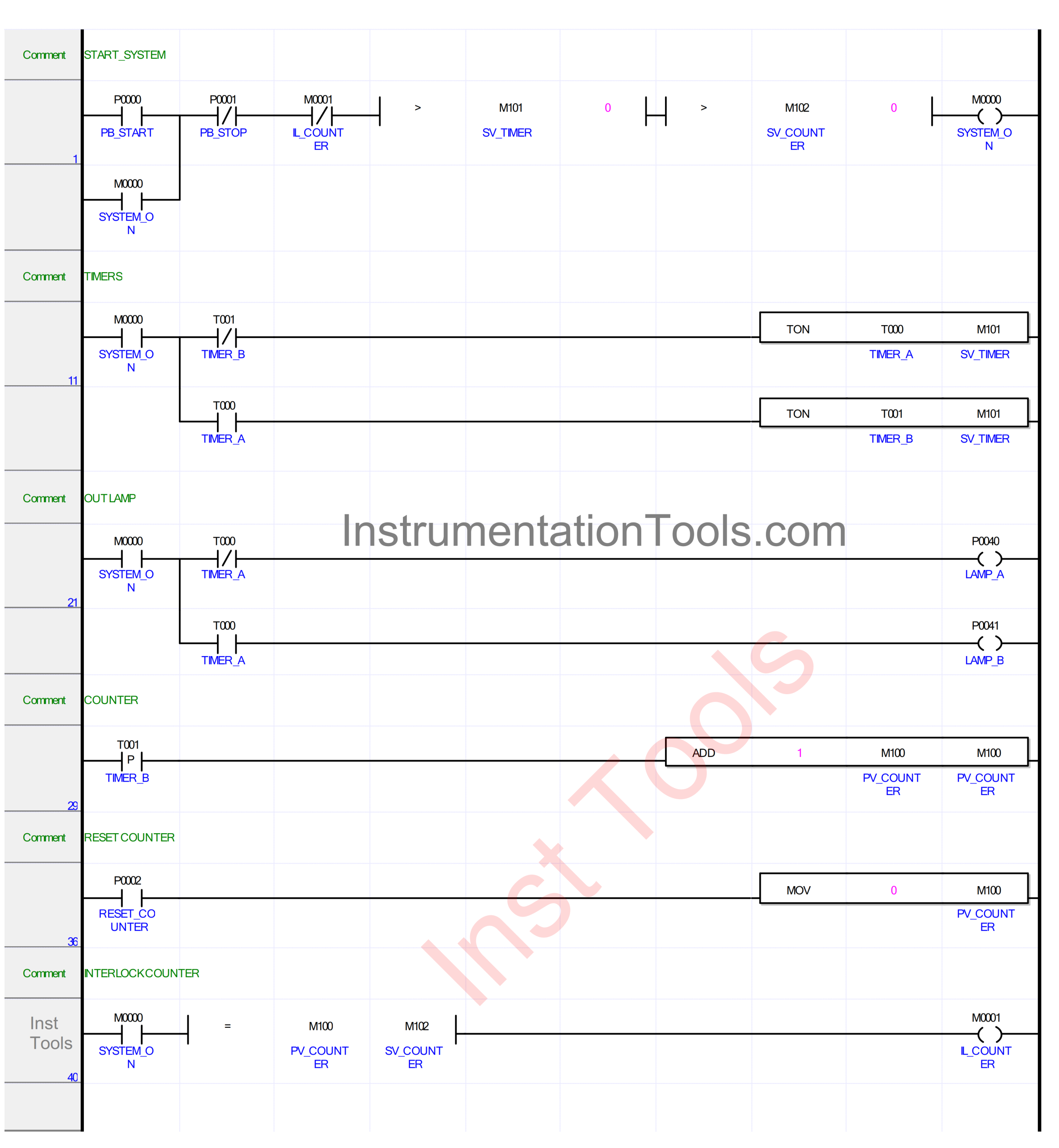

PLC Programming

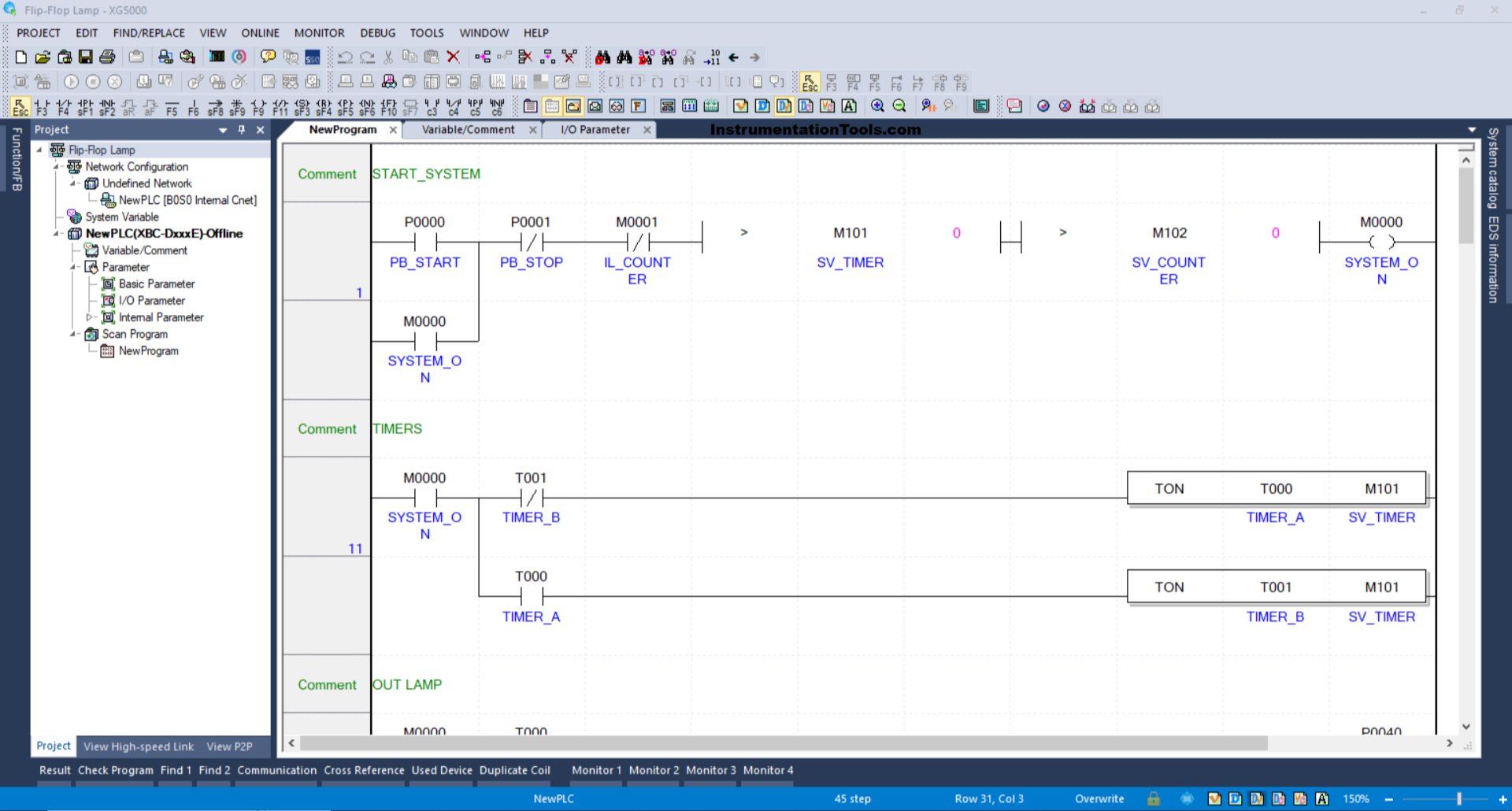

RUNG 1 (START_SYSTEM)
In this Rung, if the PB_START (P0000) button is pressed and the value in the memory word SV_TIMER (M101) and SV_COUNTER (M102) is Greater Than zero “0”, then the memory bit SYSTEM_ON (M0000) will be in the HIGH state. Because it uses Latching, the memory bit SYSTEM_ON (M0000) will remain in the HIGH state even though the PB_START (P0000) button has been released.
The memory bit SYSTEM_ON (M0000) will return to the LOW state if the PB_STOP (P0001) button is pressed or the NC contact of the memory bit IL_COUNTER (M0001) is in the HIGH state.
RUNG 11 (TIMERS)
In this Rung, when the NO contact of the memory bit SYSTEM_ON (M0000) is in the HIGH state, the TIMER_A (T000) timer will start counting with a time period according to the “Set value” that has been given to the memory word SV_TIMER (M101).
Next, after TIMER_A (T000) has finished counting, the TIMER_B (T001) timer will start counting with the same time period as TIMER_A (T000).
After the TIMER_B (T001) timer has finished counting, the TIMER_A (T000) will be OFF due to the Interlock of the TIMER_B (T001) timer. The timer TIMER_B (T001) will also turn off afterward, and the system will repeat again.

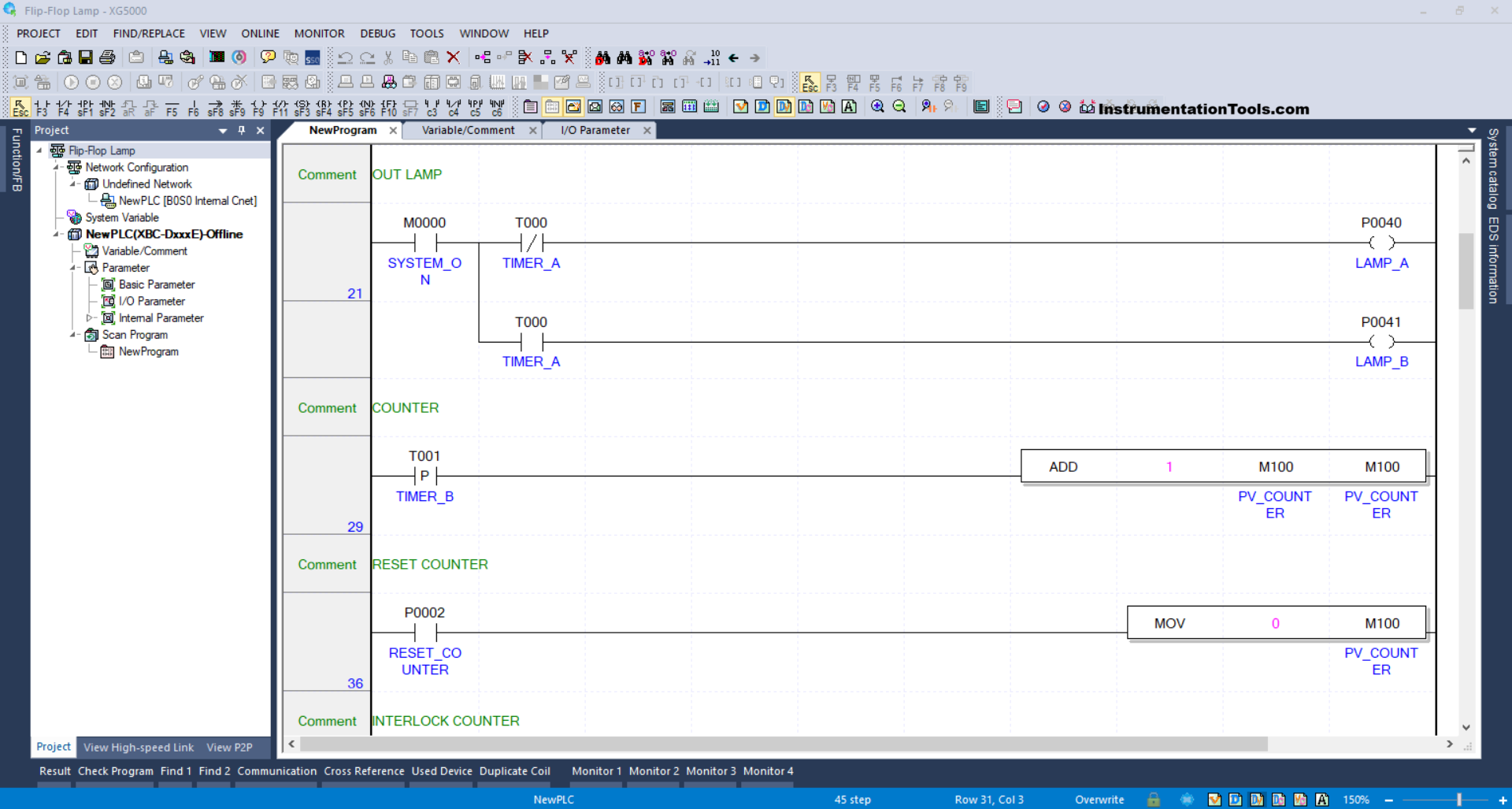

RUNG 21 (OUT LAMP)
In this Rung, if the NO contact of the memory bit SYSTEM_ON (M0000) is in the HIGH state and the NC contact of the timer TIMER_A (T000) is in the LOW state, then the LAMP_A (P0040) output will be ON.
When the NO contact of the timer TIMER_A (T000) is in the HIGH state, then the LAMP_B (P0041) output will be ON.

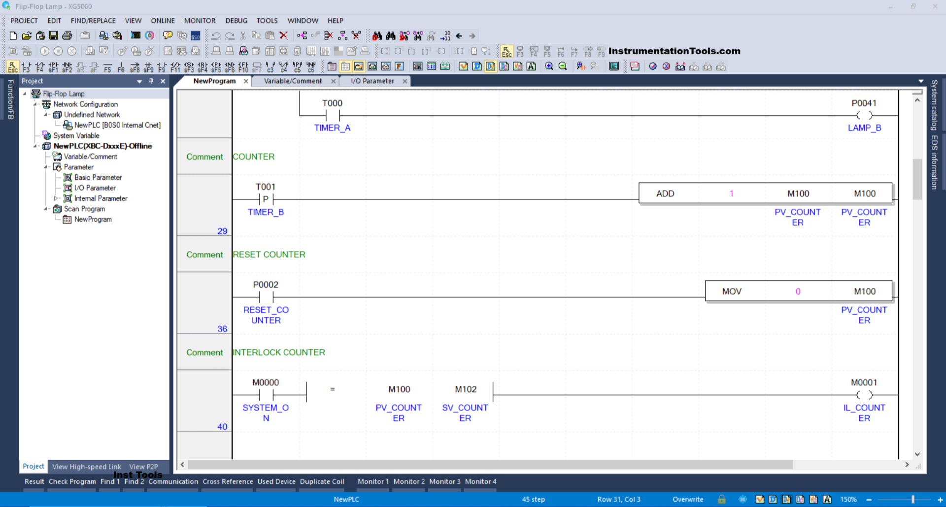

RUNG 29 (COUNTER)
When the NO contact of the timer TIMER_B (T001) is in the HIGH state, then the value in the memory word PV_COUNTER (M100) will increase (+1). Because it uses the ADD instruction.
RUNG 36 (RESET COUNTER)
When the RESET_COUNTER (P0002) button is pressed, the value in the memory word PV_COUNTER (M100) will be zero “0”. Because the MOV instruction moves the value “0” to the memory word PV_COUNTER (M100).
RUNG 40 (INTERLOCK COUNTER)
When the NO contact of the memory bit SYSTEM_ON (M0000) is in the HIGH state and the value of the memory word PV_COUNTER (M100) is Equal to SV_COUNTER (M102), the memory bit IL_COUNTER (M0001) will be in the HIGH state.
