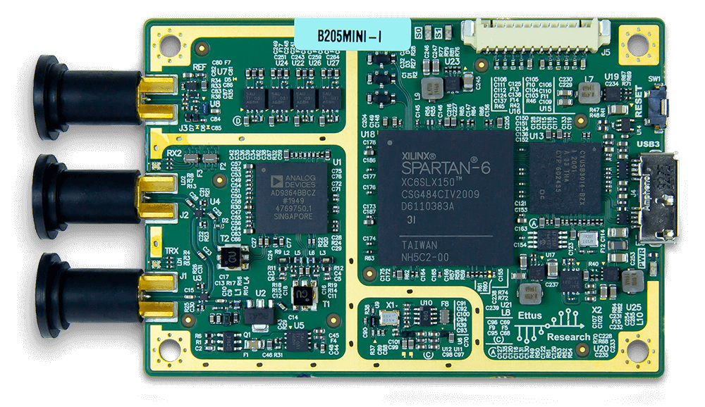

When is the right time to invest in SDR hardware?
If troubleshooting frequently ends without identifying a clear cause, or if faults disappear before they can be measured, then additional diagnostic capability becomes necessary.
Intermittent communication problems take time to investigate, and even a small amount of downtime can justify the cost of tools that provide better visibility into what is happening in the system.
For engineers who need to analyze physical layer conditions in more detail, software-defined radio hardware can capture transient noise events that are not visible using standard diagnostic methods. FPGA-based systems, for example, can detect fast signal disturbances that may otherwise go unnoticed, which allows you to confirm whether interference is present instead of assuming it.
Companies like Digilent provide FPGA-based software-defined radio hardware as flexible engineering platforms that are used for signal capture and analysis in this type of environment, where they are typically configured and integrated into custom diagnostic setups to capture transient noise events that are difficult to see with standard tools.
