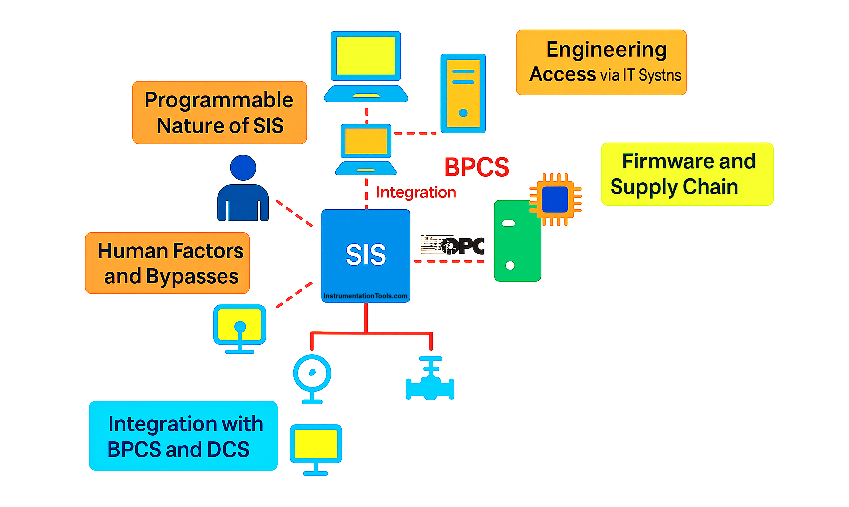

How are SIS systems attacked by cybersecurity threats?
SIS stands for safety instrumented systems. It is a network of sensors, controllers, and control elements that mostly act in a closed loop or redundancy to check the safety of the process, and perform a response in case of a failure. The responses can range from shutting down a system safely to generating alarms or activating safety control elements that are present in the backup. They are designed or selected according to SIL or safety integrity level, which ranges from 1 to 4.
People think that SIS looks more like a hardwired and isolated system. It has fewer industrial communication protocols and cannot be threatened by cyber attackers, as it is not connected to the network. But, this is a very wrong perception. SIS also consists of controllers like PLC, which we discussed earlier. And PLCs have industrial communication protocols running on them in the network. Also, the sensors and field instruments used nowadays are mostly of smart or IoT-cloud-based type, which are connected to networks for advanced monitoring and diagnostics. To program them, the corresponding engineering tools or software are used, which is done by a PC or laptop connected to the network. Also, engineers mostly access these engineering workstations of a PC or a laptop remotely online and are thus exposed to wireless networks. That is why SIS too are threatened by cyberattacks and makes the process very risky to operate.
