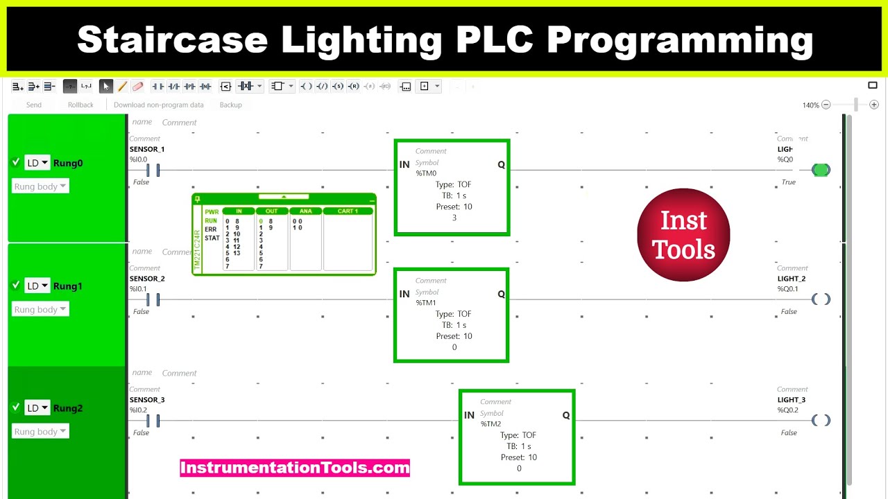

Problem Statement:
We are using three sensors to control 3 Lights. There is one sensor in each place, there are three places so we need 3 sensors. The sensor will detect if there is any presence of a person in the respective place.
The Light on each step (or place) of the stair should remain ON for 10 seconds after the last detected movement.

We have used Normally Open Contact for Sensor 1(I0.0), Sensor 2 (I0.1), and Sensor 3 (I0.2).
In Rung 0:
  1. Normally Open Contact is used for Sensor 1 (I0.0) to Turn ON the output  Light 1 (Q0.0).
  2. Timer TOF is used to delay the turn-OFF time of the output Light 1 (Q0.0) for some time.
In Rung 1:
  1. Normally Open Contact is used for Sensor 2 (I0.1) to Turn ON the output  Light 2 (Q0.1).
  2. Timer TOF is used to delay the turn-OFF time of the output Light 2 (Q0.1) for some time.
In Rung 2:
  1. Normally Open Contact is used for Sensor 3 (I0.2) to Turn ON the output  Light 3 (Q0.2).
  2. Timer TOF is used to delay the turn-OFF time of the output Light 3 (Q0.2) for some time.
PLC Code Testing
Let’s test our PLC code with the simulation of different input statuses. We may show only the required part of the logic or rung instead of the complete program. We recommend you watch the above video for full details.
Rung 0:
Automated Stairwell Lighting System
When Sensor 1 (I0.0) gets activated, the output Light 1 (Q0.0) will turn ON as Normally Open Contact is used for Sensor 1 (I0.0) and the signal will flow through it.
Sensor-Controlled Staircase Illumination
When Sensor 1 (I0.0) turns OFF, the output Light 1 (Q0.0) remains ON but for a limited time because Timer Function Block type TOF is used to delay the turning OFF time of the output Light 1 (Q0.0) and time is set to 10 seconds.
After 10 seconds, the output Light 1 (Q0.0) will turn OFF.
