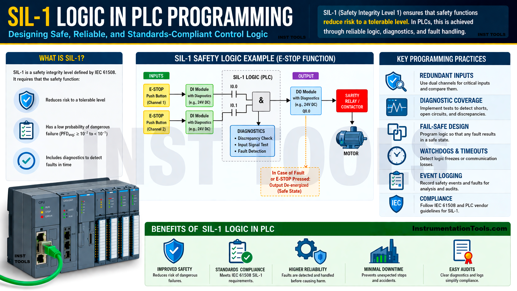

SIL-1 Logic in PLC Programming
- The very first thing to check is that when you read an analog input, it must be within the range. A wire break or short circuit alarm for that input must be given the highest priority and made to trip the logic accordingly. If you do not have any in-built system or diagnostic bit, you can also write the logic manually, by comparing the value between the lowest and highest values.
- If the signal is valid and the process value crosses the set alarm limit, then the trip signal must be generated. But remember to use a check timer, for a digital or analog signal, to avoid nuisance alarms and prevent the system from overflooding with alarms unnecessarily.
- Once an alarm occurs, the alarm must be set till the operator comes, acknowledges, and manually resets the alarm. Also, the reset button must ensure that it is both a soft signal from HMI / SCADA or a hardwired push button. If any of the values come, then the alarm can be reset.
- Then, if such critical alarms occur (be it software, hardware, or controller level), the output must be immediately de-energized to a false state as per the alarm process interlock written in the control philosophy.
- All the fault and diagnostics bits generated must be immediately communicated to HMI / SCADA systems to alert the operators to that. This ensures that they can take timely action and rectify the same.
- The process logic can be written as per your requirement, but care must be taken that the above steps mentioned have the highest priority and bypass the other conditions in the process, to achieve safety integrity.
