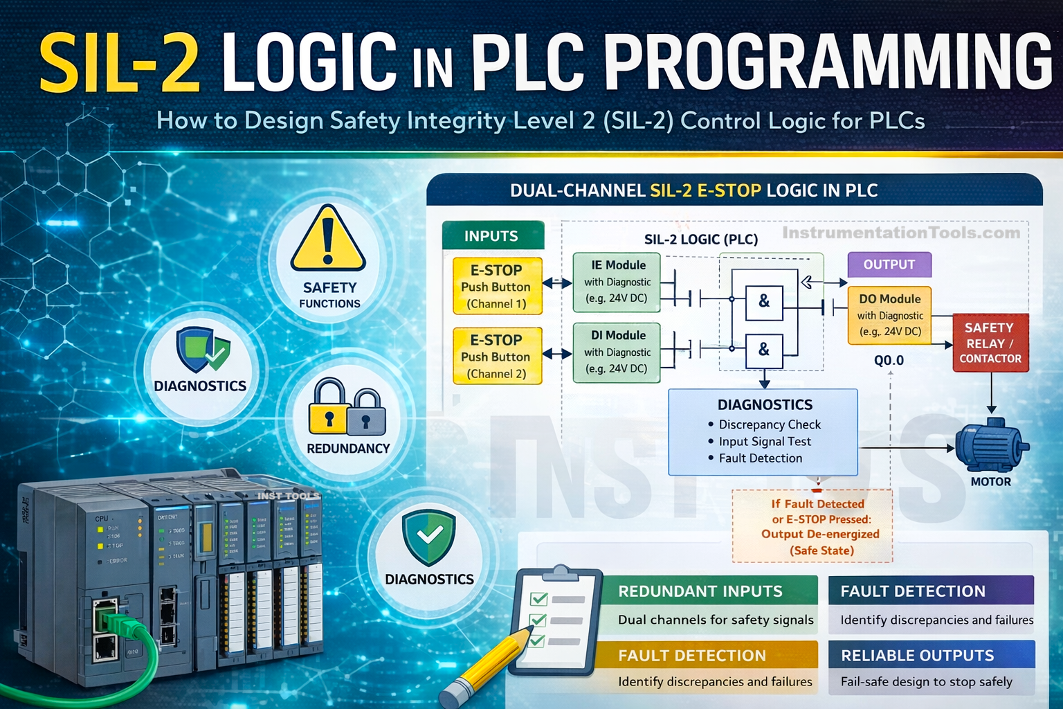

How to Develop SIL-2 Logic for Safety PLCs?
- Before starting any programming, just remember that you have to consider voting logic. So accordingly, you have to design the same logic in a repeated manner for all the sensors. Also, from a programming point of view, in a safety PLC, consider the following points: SIL-2 logic runs in a dedicated safety task, no shared tags with standard logic, no indirect addressing, and no complex state machines.
- For a trip condition, if 2oo3 voting is used, use AND gate logic. Voting ensures the safety function works despite one faulty channel. For example, refer to the following code:
Trip_Condition :=
  (PT1_Trip AND PT2_Trip) OR
  (PT2_Trip AND PT3_Trip) OR
  (PT1_Trip AND PT3_Trip);
- The next logic to implement is mismatch detection. SIL-2 must detect dangerous disagreement. The simple method is to subtract one value from the other, and then compare the result with an allowed drift set value. If the difference goes beyond this value, then it means the sensors are not giving correct results, and a diagnostic fault must be generated to trip the system or continue as per the design specifications of the control logic for the next step to be done.
- Then, as voting works on redundancy, redundancy checks too must be done continuously. So, in 2oo3 voting, if 2 sensors are not responding, then a redundancy fault must be generated immediately to trip the system or continue as per the design specifications of control logic for the next step to be done.
- It is also necessary to take feedback on the outputs, to check whether they are actually working or not. So, if you do not receive any feedback from the output for a certain small delay, then a fault alarm must be generated.
