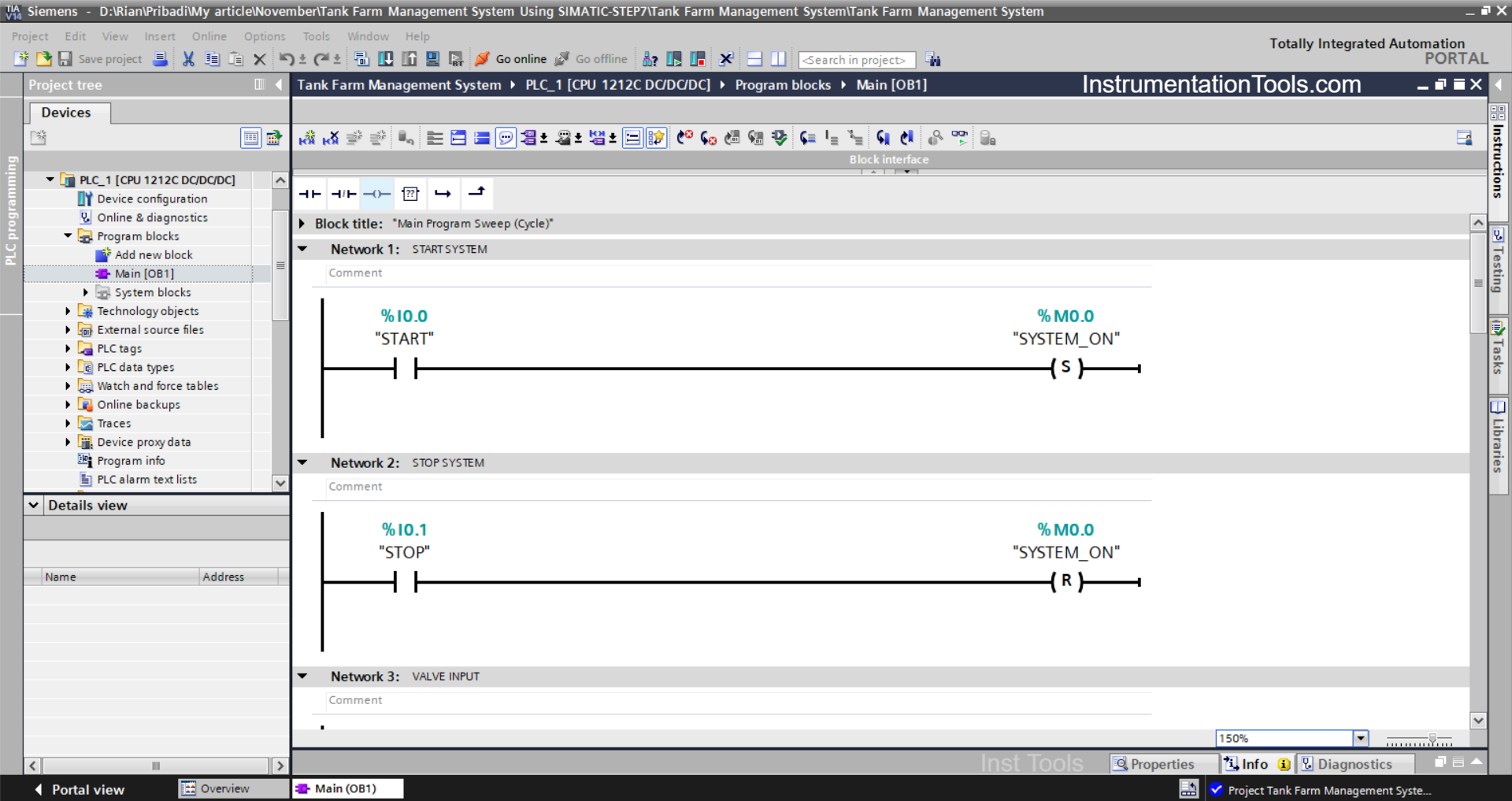

NETWORK 1 (START SYSTEM)
In this Network, the memory bit SYSTEM_ON (M0.0) will be in the HIGH state when the START (I0.0) button is pressed. The memory bit SYSTEM_ON (M0.0) will remain in the HIGH state even though the START (I0.0) button has been released, because it uses the SET OUTPUT instruction.
NETWORK 2 (STOP SYSTEM)
In this Network, if the STOP (I0.1) button is pressed, the memory bit SYSTEM_ON (M0.0) will be in the LOW state. Because it uses the RESET OUTPUT Instruction.

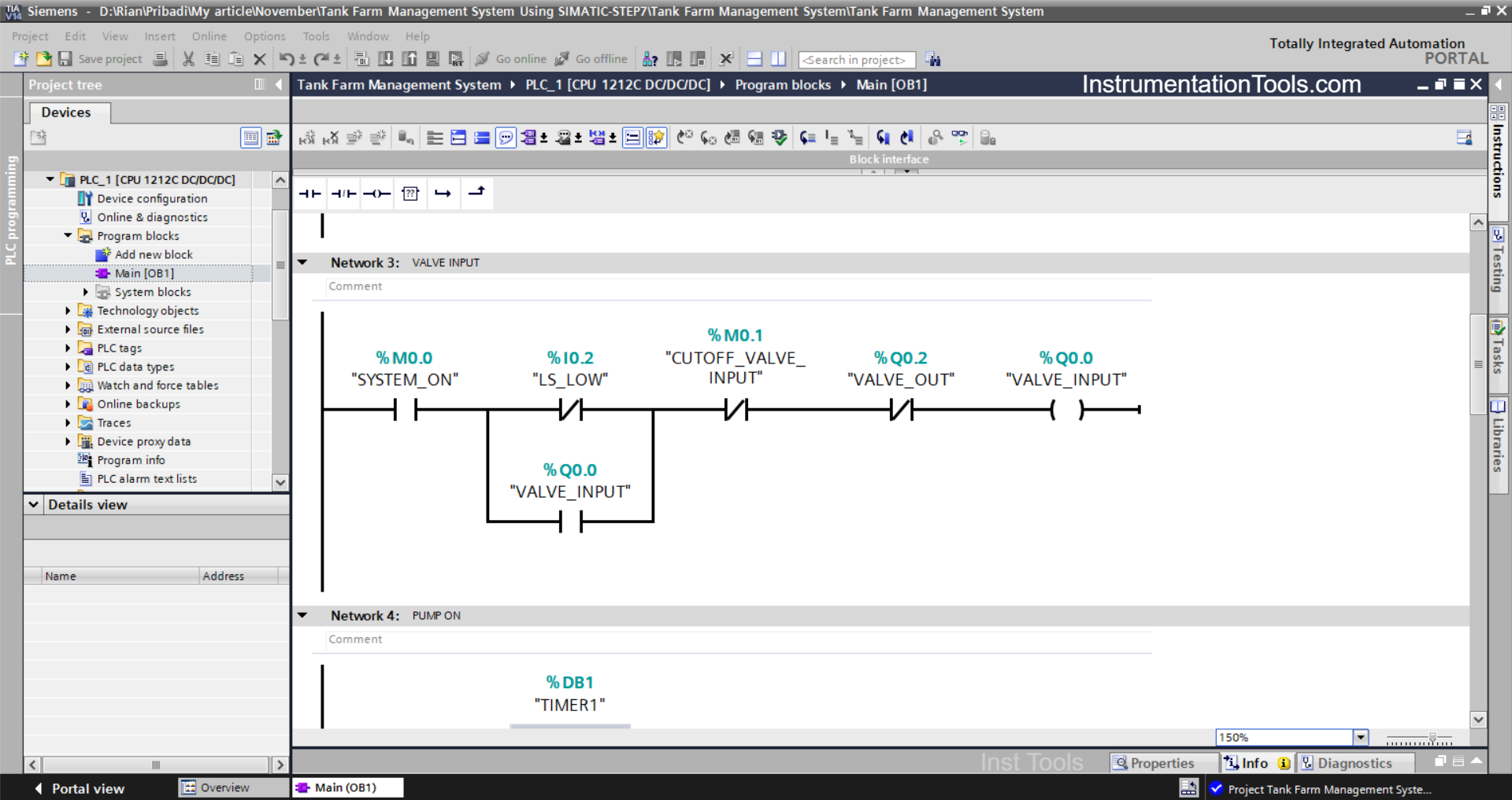

NETWORK 3 (VALVE INPUT)
In this Network, the output VALVE_INPUT (Q0.0) will be OPEN if the NO contact of the memory bit SYSTEM_ON (M0.0) is in the HIGH state and the sensor LS_LOW (I0.2) is in the LOW state.
When the NC contact of CUTOFF_VALVE_INPUT (M0.1) or VALVE_OUT (Q0.2) is in the HIGH state, the output VALVE_INPUT (Q0.0) will be CLOSED.

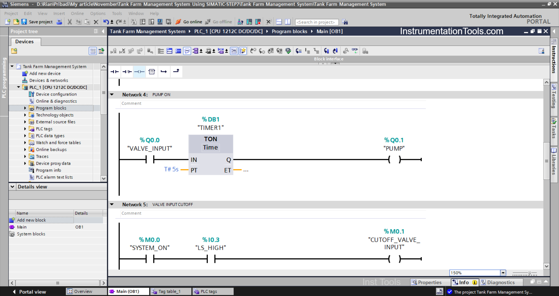

NETWORK 4 (PUMP ON)
In this Network, Timer TIMER1 (DB1) will start counting up to “5” seconds if the NO contact of VALVE_INPUT (Q0.0) is in the HIGH state.
The output PUMP (Q0.1) will be ON when the NO contact of TIMER1(DB1) is in the HIGH state.
NETWORK 5 (VALVE INPUT CUTOFF)
The memory bit CUTOFF_VALVE_INPUT (M0.1) will be in the HIGH state when the NO contacts of the memory bit SYSTEM_ON (M0.0) and Sensor LS_HIGH (I0.3) are in the HIGH state.

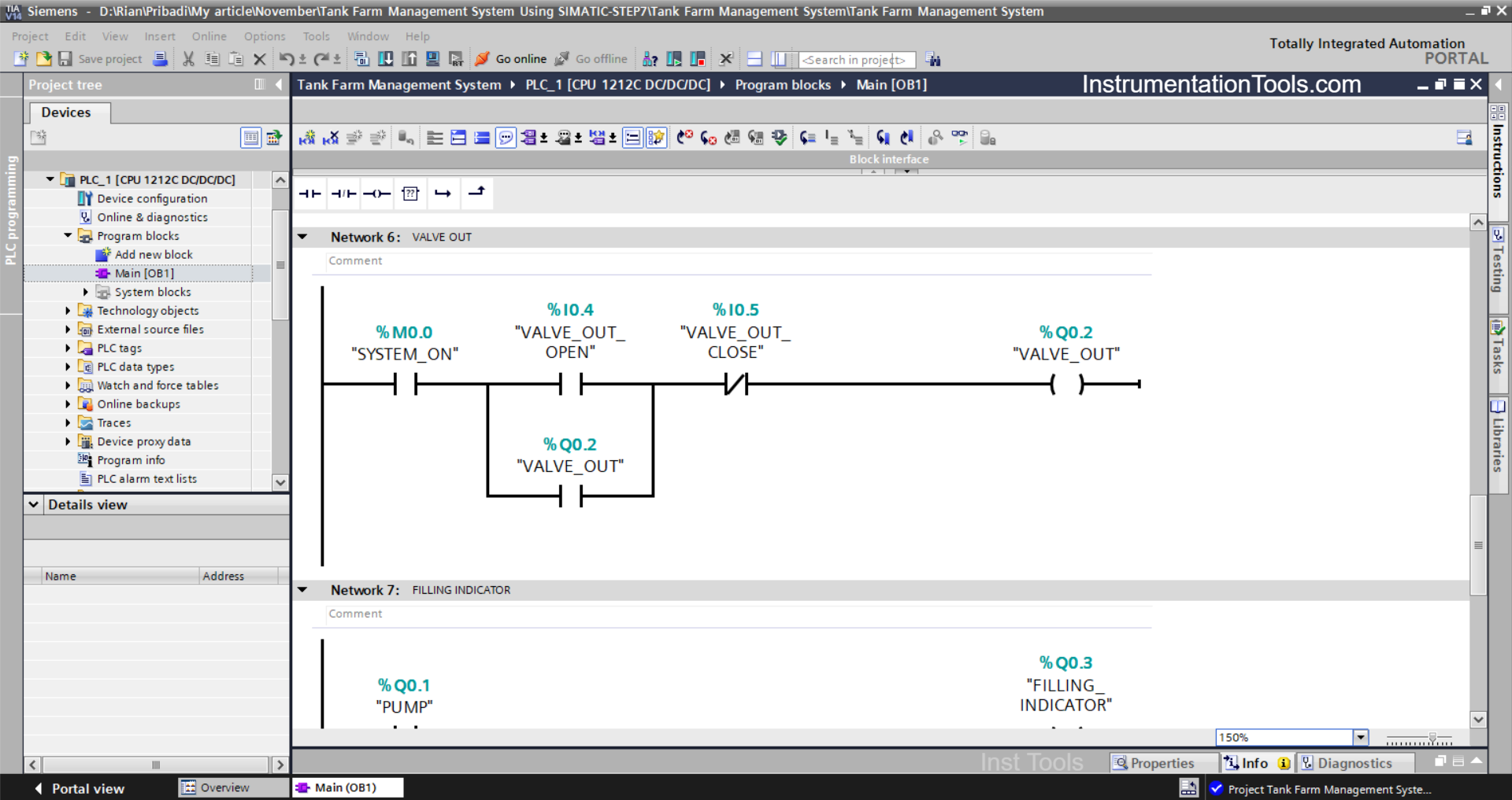

NETWORK 6 (VALVE OUT)
The output VALVE_OUT (Q0.2) will become OPEN when the NO contact of the memory bit SYSTEM_ON (M0.0) in the HIGH state and the VALVE_OUT_OPEN (I0.4) button is pressed.
The output VALVE_OUT (Q0.2) will remain in the OPEN state even though the VALVE_OUT_OPEN (I0.4) button has been released. Because it uses Latching.
And the output VALVE_OUT (Q0.2) will become CLOSE when the VALVE_OUT_CLOSE (I0.5) button is pressed.

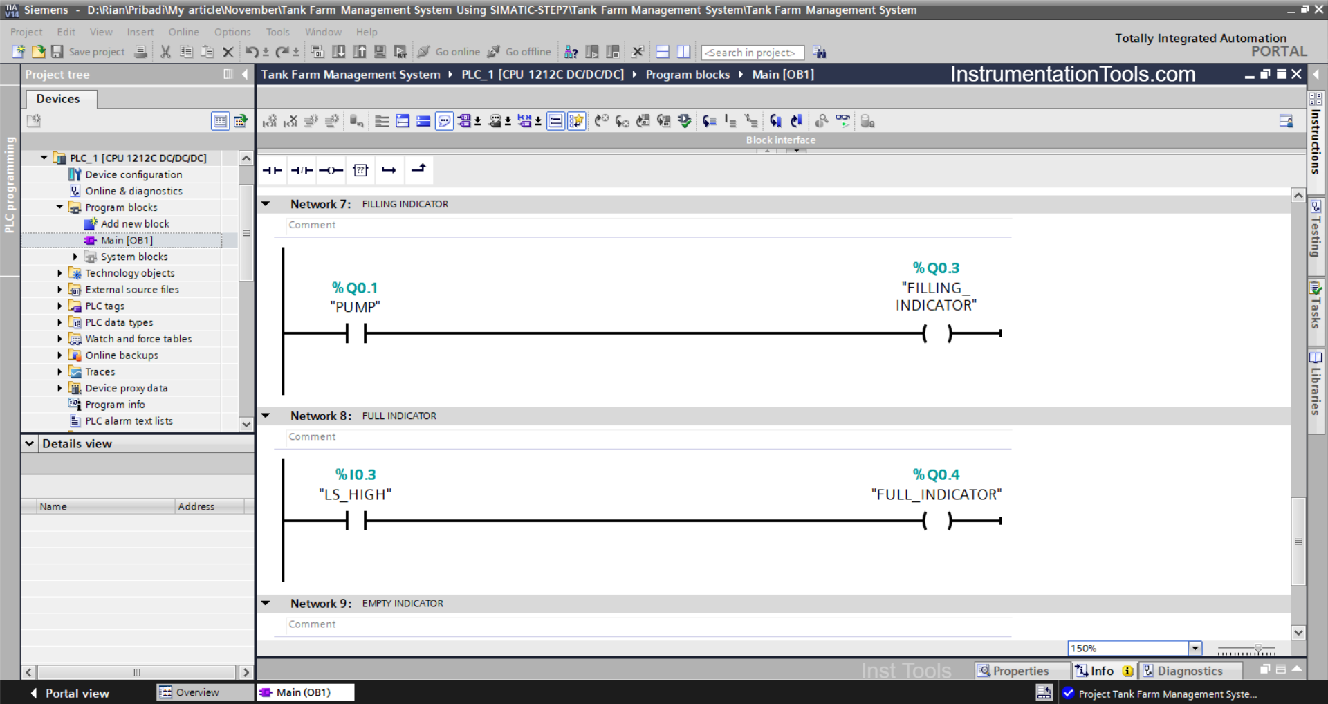

ETWORK 7 (FILLING INDICATOR)
In this Network, the output FILLING_INDICATOR (Q0.3) will be ON when the NO contact of PUMP (Q0.1) is in the HIGH state.
NETWORK 8 (FULL INDICATOR)
In this Network, the output FULL_INDICATOR (Q0.4) will be ON when the NO contact of the sensor LS_HIGH (I0.3) is in the HIGH state.
NETWORK 9 (EMPTY INDICATOR)
In this Network, the output EMPTY_INDICATOR (Q0.5) will be ON when the NC contact of the sensor LS_LOW (I0.2) is in the LOW state.
