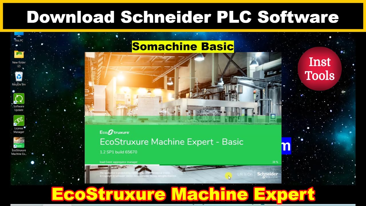

Here in this program, we used EcoStruxure Machine Expert Basic PLC software.
