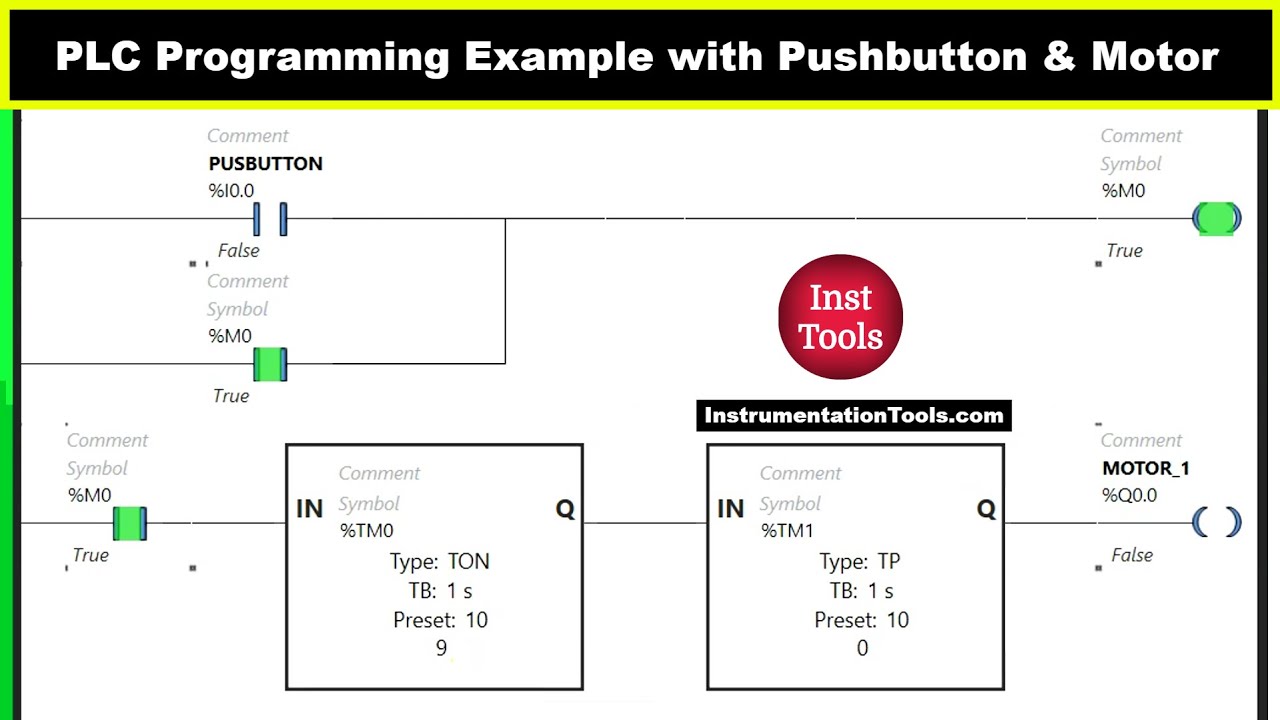

Problem Statement:
We are using a Push Button to control a Motor.
When the Push Button is pressed and released,
  • Motor 1 will be ON after 10 seconds.
  • After 10 seconds, Motor 1 goes OFF.

Digital Inputs:
The required inputs are listed below.
Push Button: I0.0
Digital Outputs:
The required outputs are listed below.
Motor 1: Q0.0

Here we used Normally Open Contact for Push Button and Memory Bit.
Timer Function Block Type TP and Timer Function Block Type TON is used for Motor 1.
In Rung 0:
1) Normally Open Contact is used for Push Button to Turn ON Memory Bit.
2) Latching is used for Memory Bit so that when the Push Button is released, Memory Bit still remains ON.
In Rung 1:
1) Normally Open Contact is used for Memory Bit to Turn ON Motor 1.
2) Timer Function Block type TON is used for Motor 1 to delay the Turning ON.
3) Timer Function Block type TP is used for Motor 1 to delay the turning OFF time.
So, When Push Button is pressed and released, Memory Bit Turns ON in Rung0 and Rung1. When Memory Bit Turns ON in Rung1, Timer starts in Timer Function Block type TON which is set to 10 seconds and then, it delays 10 seconds to Turn ON Motor1.
After 10 seconds Motor 1 Turns ON and when Motor 1 Turns ON, Timer starts in Timer Function Block type TP which is set to 10 seconds and it delays 10 seconds to Turn OFF Motor 1. After 10 seconds, Motor 1 Turns OFF.

When Push Button is Pressed and Released
When Push Button is pressed and released, Memory Bit will Turn ON in Rung0 and Rung1.
normally open Start pushbutton plc program
As Memory Bit turns ON in Rung1, Motor 1 will Turn ON after 10 seconds because Timer Function Block type TON is used for Motor 1 which delays the time of Motor 1 to Turn ON.
Ladder Logic Programming of Push Button Latching
After 10 seconds, Motor 1 will Turn OFF as Timer Function Block type TP is also used for Motor 1 which delays the time of Motor 1 to Turn OFF.
