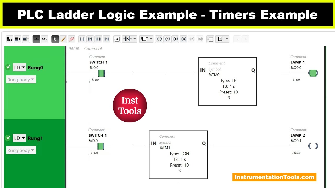

Problem Statement
We are using one toggle switch to control two lamps.
When Switch 1 is ON, then
  1. Lamp 1 will be ON for 10 seconds.
  2. Lamp 2 will be ON after 10 seconds.

Ladder Logic
PLC Programming Example on Timers Function Block

Here we used Normally Open Contact for Switch 1 (I0.0).
Timer Function Block Type TP is used for Lamp 1 and Time Function Block Type TON is used for Lamp 2.
In Rung 0:
1) Normally Open Contact is used for Switch 1 to Turn ON Lamp 1.
2) Timer Function Block type TP is used to Turn OFF Lamp 1 after Set time.
In Rung 1:
1) Normally Open Contact is used for Switch 1 to Turn ON Lamp 2.
2) Timer Function Block type TON is used to delay the time of Lamp 2 to Turn ON.
When Switch 1 is ON, the signal will flow through Switch 1 as Normally Open Contact is used for Switch 1 and Lamp 1 will Turn ON for 10 seconds because Timer Function Block type TP is used for Lamp1 and time is set for 10 sec.
After 10 seconds, Lamp 2 will Turn ON in Rung1 as Timer Function Block type TON is used for Lamp 2 to delay the turning ON and time is set for 10 sec.

When Switch 1 is ON
When Switch 1 is turned ON, Lamp 1 will Turn ON for 10s in Rung 0 as Timer Function Block Type TP is used for Lamp 1.
How to Use Timers in PLC Ladder Logic
After 10 seconds, Lamp 1 will Turn OFF and Lamp 2 will Turn ON in Rung 1 because Timer Function Block Type TON is used for Lamp 2 which will delay the time of Lamp 2 to Turn ON for Set time.
