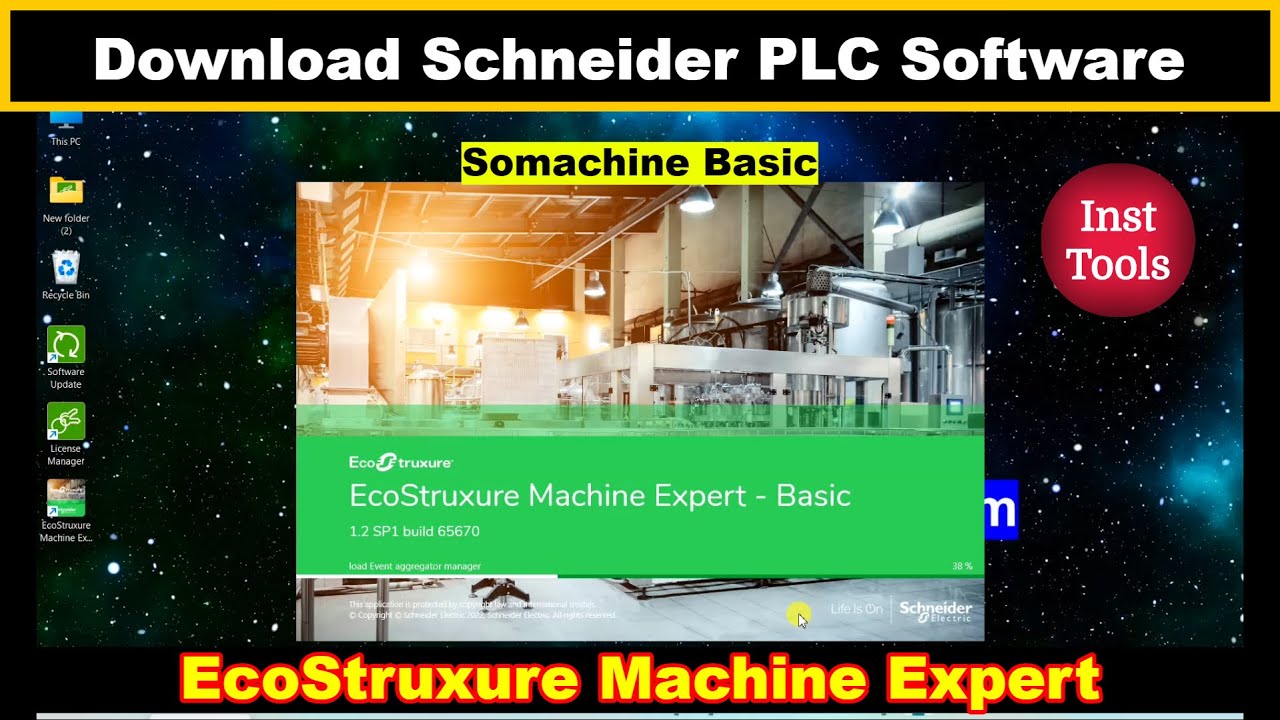

Watch this PLC video to learn the programming example.
Simple PLC Example - Schneider Electric PLC Programming

We used EcoStruxure Machine Expert Basic PLC software for this example logic.
