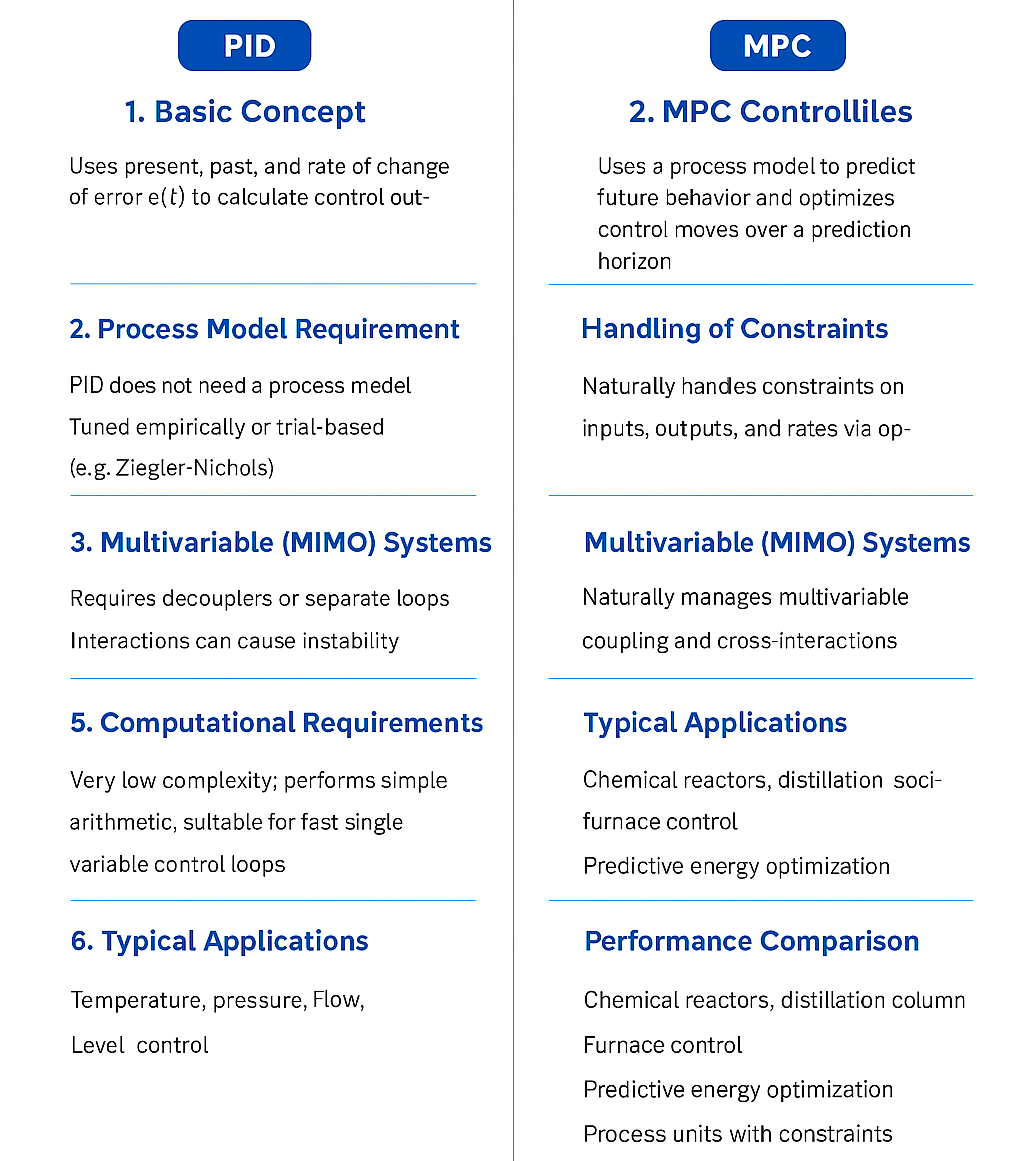

Difference between PID and MPC
- PID uses only the present value to minimise the error, whereas MPC uses both the past and present values to minimise the error.
- The nature of PID is reactive, whereas the nature of MPC is predictive.
- PID can work even in a PLC, but MPC does not work in a PLC. It works on higher levels like DCS, MATLAB, IIoT controllers and SCADA.
- PID can handle only a single input or output, whereas MPC can work with multiple values.
- PID is used for simple applications, whereas MPC is used for complex applications.
