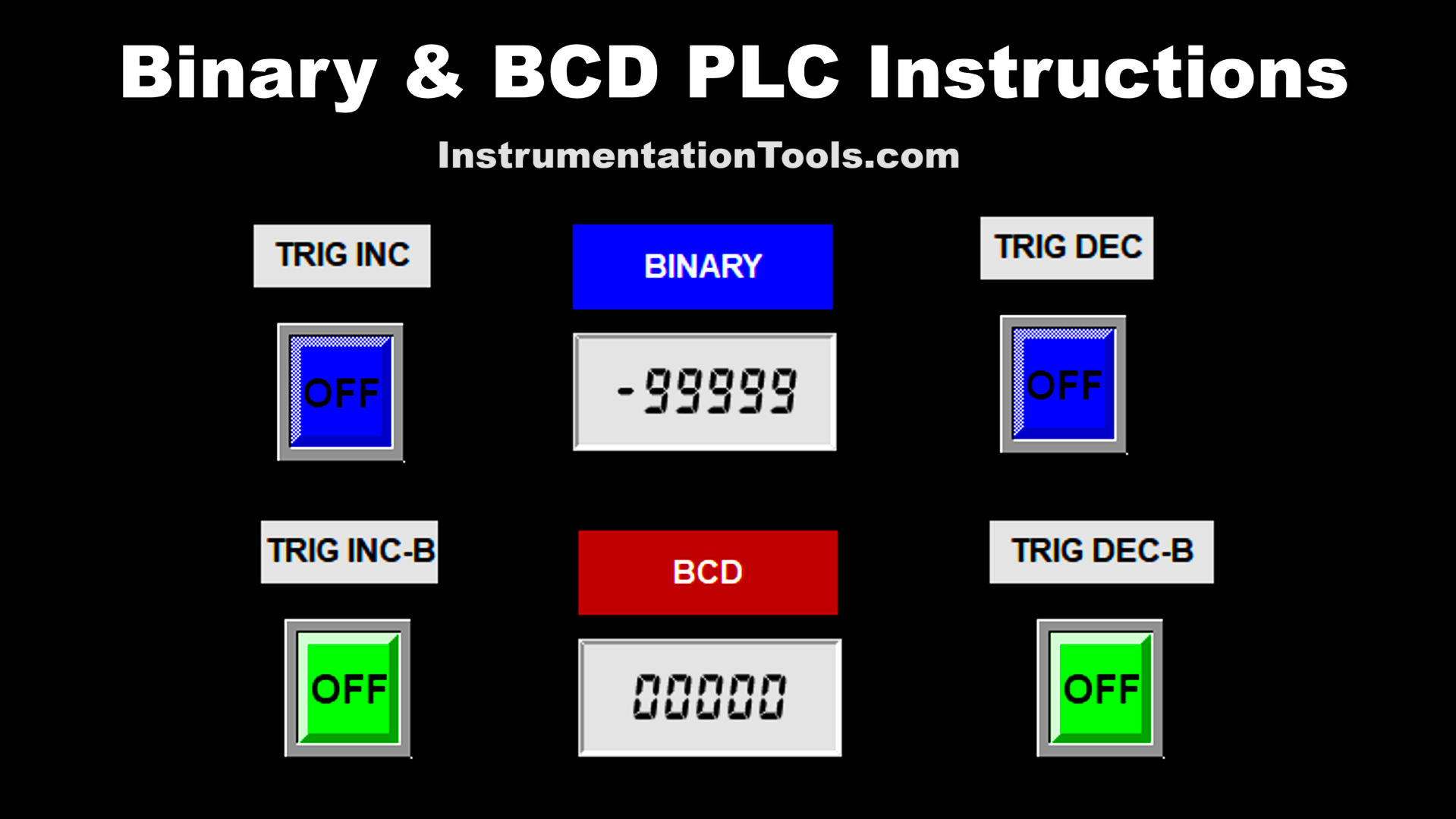

In this program, each Instruction will be used to add and subtract values in a word memory allocation. The Binary Increment / ++(590) instruction will share the same word memory address with Binary Decrement / –(592), and the BCD Increment / ++B(594) instruction will share the same word memory address with BCD Decrement / –B(596). Each Instruction has its own trigger.
Simulation Video
In the video below, we simulated the PLC program, and the results are displayed.

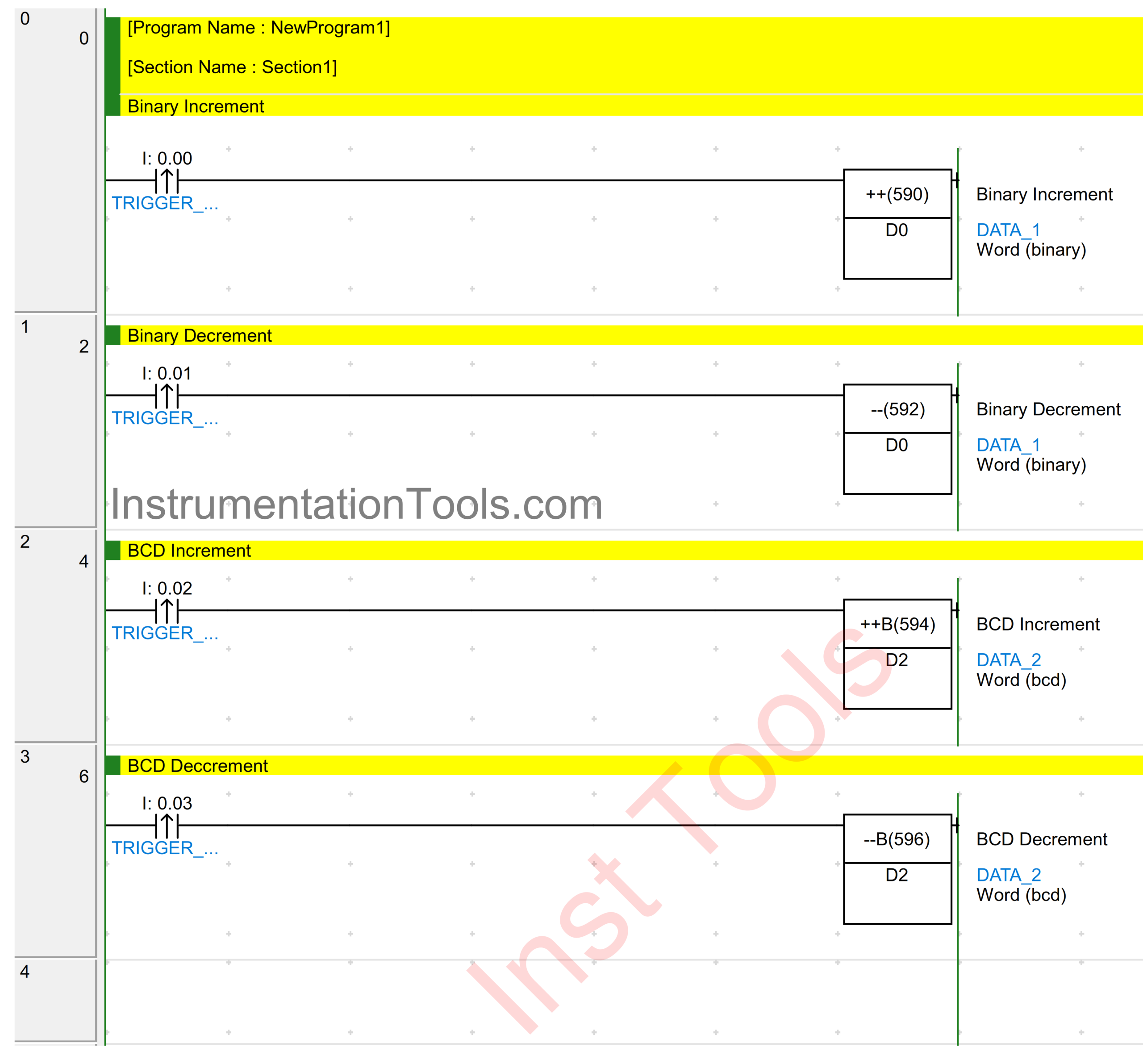

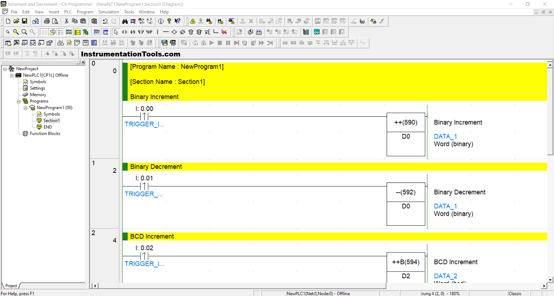

RUNG 0 (Binary Increment)
In this Rung, if the TRIGGER_INC (0.00) button is pressed, the value in the memory word DATA_1 (D0) will increase by +1. Because the TRIGGER_INC (0.00) button uses a Differentiate UP type NO contact, the value will only increase once, namely when the condition changes from OFF to ON.
RUNG 1 (Binary Decrement)
In this Rung, if the TRIGGER_DEC (0.01) button is pressed, the value in the memory word DATA_1(D0) will decrease by -1. Because the TRIGGER_DEC (0.01) button uses a Differentiate UP type NO contact, the value will only decrease once, namely when the condition changes from OFF to ON.

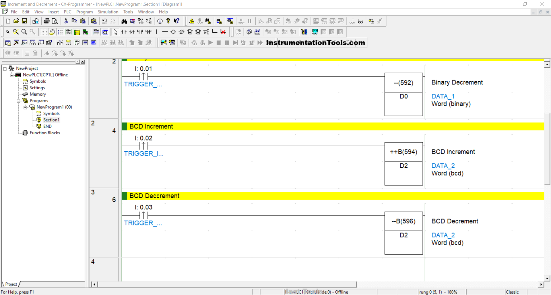

RUNG 2 (BCD Increment)
In this Rung, if the TRIGGER_INC_B (0.02) button is pressed, the value in the memory word DATA_2 (D2) will increase by +1. Because the TRIGGER_INC_B (0.02) button uses a Differentiate UP type NO contact, the value will only increase once, namely when the condition changes from OFF to ON.
RUNG 3 (BCD Decrement)
In this Rung, if the TRIGGER_DEC_B (0.03) button is pressed, the value in the memory word DATA_2 (D2) will decrease by -1. Because the TRIGGER_DEC_B (0.03) button uses a Differentiate UP type NO contact, the value will only decrease once, namely when the condition changes from OFF to ON.
