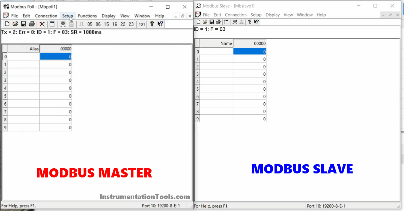

Modbus Poll
Modbus Poll is a Modbus Master simulator software. This software can be used as a master to send commands and read data from Modbus slave devices.
Modbus Slave
Modbus Slave is a Modbus Slave simulator software. This software can be used as a receiving device for commands from Master devices.

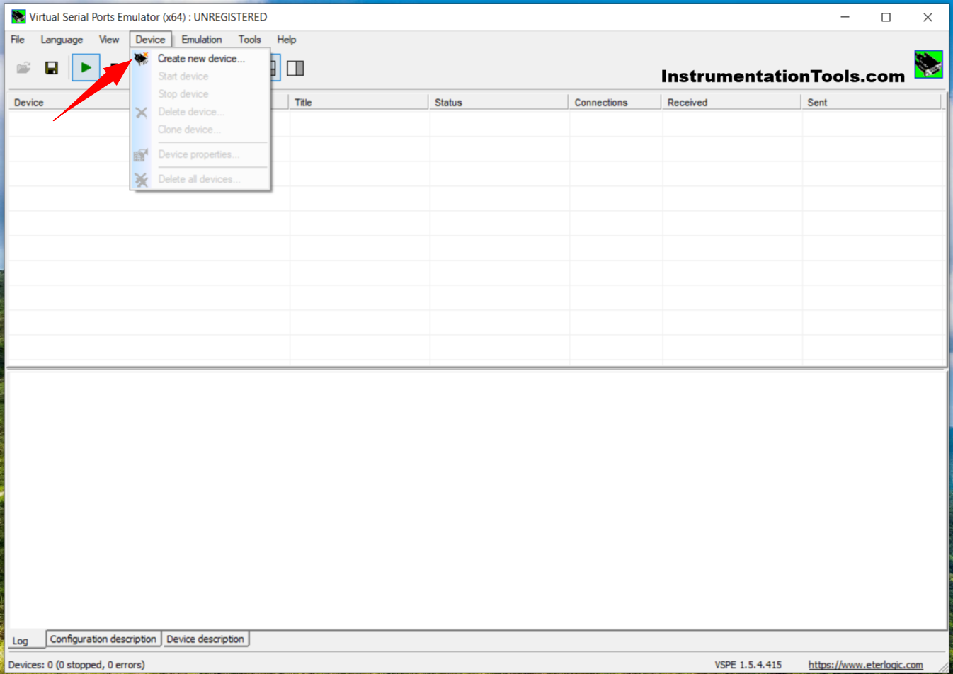

VSPE (Virtual Serial Port Simulator)
VSPE (Virtual Serial Ports Emulator) is software designed to create virtual COM ports without the need for physical hardware ports.

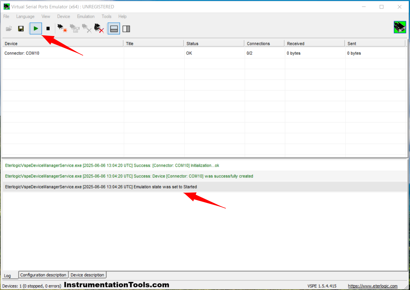

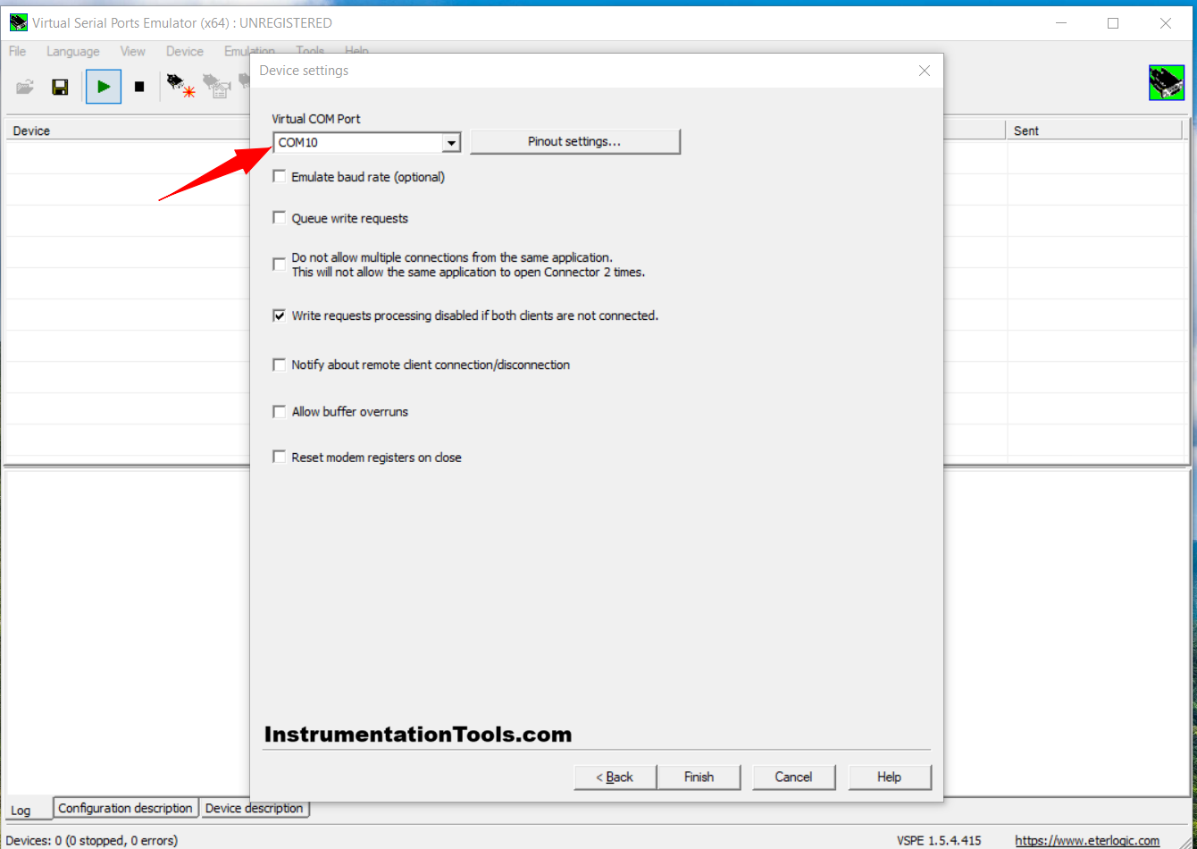

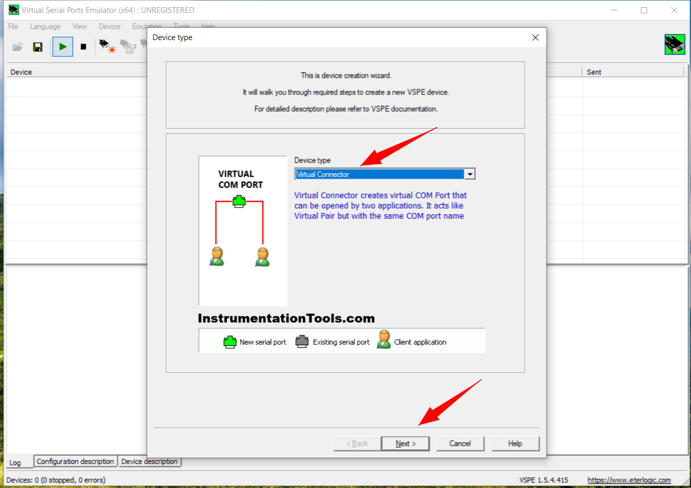

1. Open the VSPE Software. Click “Device” → “Create new device”.
2. Set the Device type to “Virtual Connector” → Click “Next”.
3. Set the Virtual COM Port to “COM 10” → Click “Finish”.
4. Click the “Start Emulation” icon, and check the log for a message indicating that the Emulation process has started.

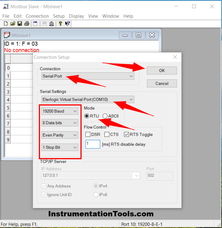

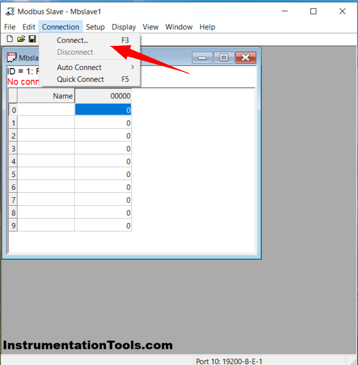

5. Open the Modbus Slave Software. Click “Connection” → Click “Connect”. Or press F3.
6. Configure the Connection: Serial Port, Serial Setting: COM 10, Baud: 19200, Data Bits: 8, Parity: Even, Stop Bit: 1, and Mode: RTU. Click “OK”.

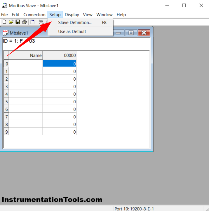

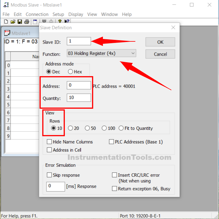

7. Click the “Setup” menu → Click “Slave Definition”. Or press the F8 key.
8. Set Slave ID: 1, Function: 03 Holding Register, Address: 0, Quantity: 10, and Rows: 10. Click “OK”.

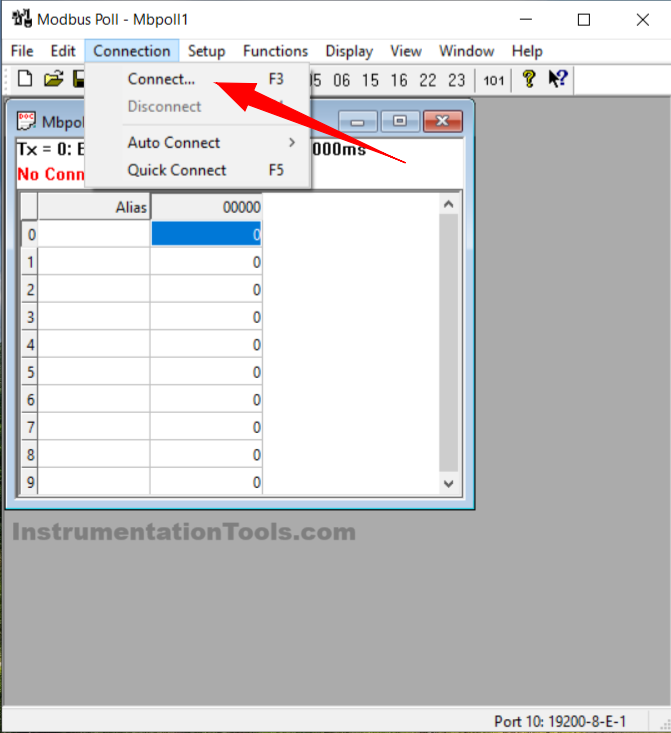

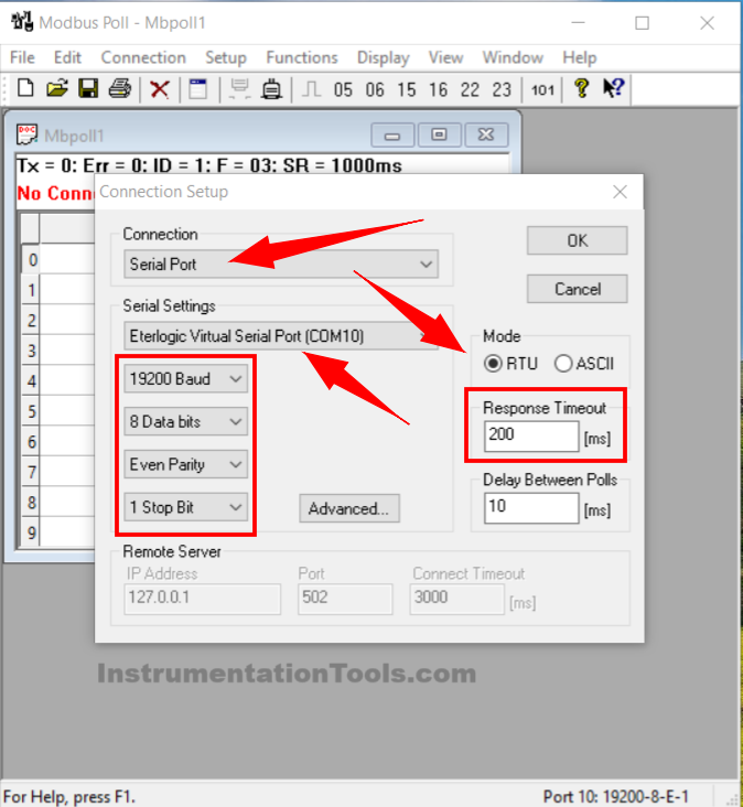

9. Open the Modbus Poll Software. Click “Connection” → Click “Connect”. Or press F3.
10. Configure the Connection: Serial Port, Serial Setting: COM 10, Baud: 19200, Data Bits: 8, Parity: Even, Stop Bit: 1, Mode: RTU, Response Timeout: 200 ms. Click “OK”.

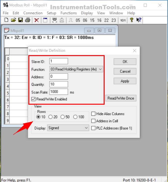

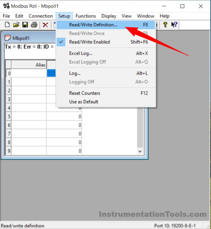

11. Click the “Setup” icon → Select “Read/Write Definition”. Or press the F8 key.
12. Set Slave ID: 1, Function: 03 Holding Register, Address: 0, Quantity: 10, Scan rate: 1000 ms, Rows: 10, and enable the “Read/Write Enabled” function. Click “OK”.

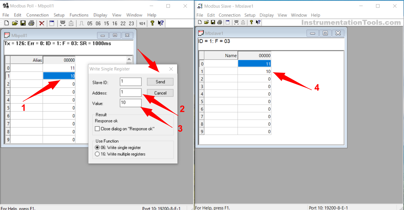

13. To read data from Modbus Slave, input values in the Modbus Slave Address column → Click “OK”. The entered data will automatically be read in Modbus Poll.
14. To send data from Modbus Poll, input values in the Modbus Poll Address column. Set the value to be sent, Address, and Slave ID → Click “Send”. The entered data will automatically be read in Modbus Poll.
