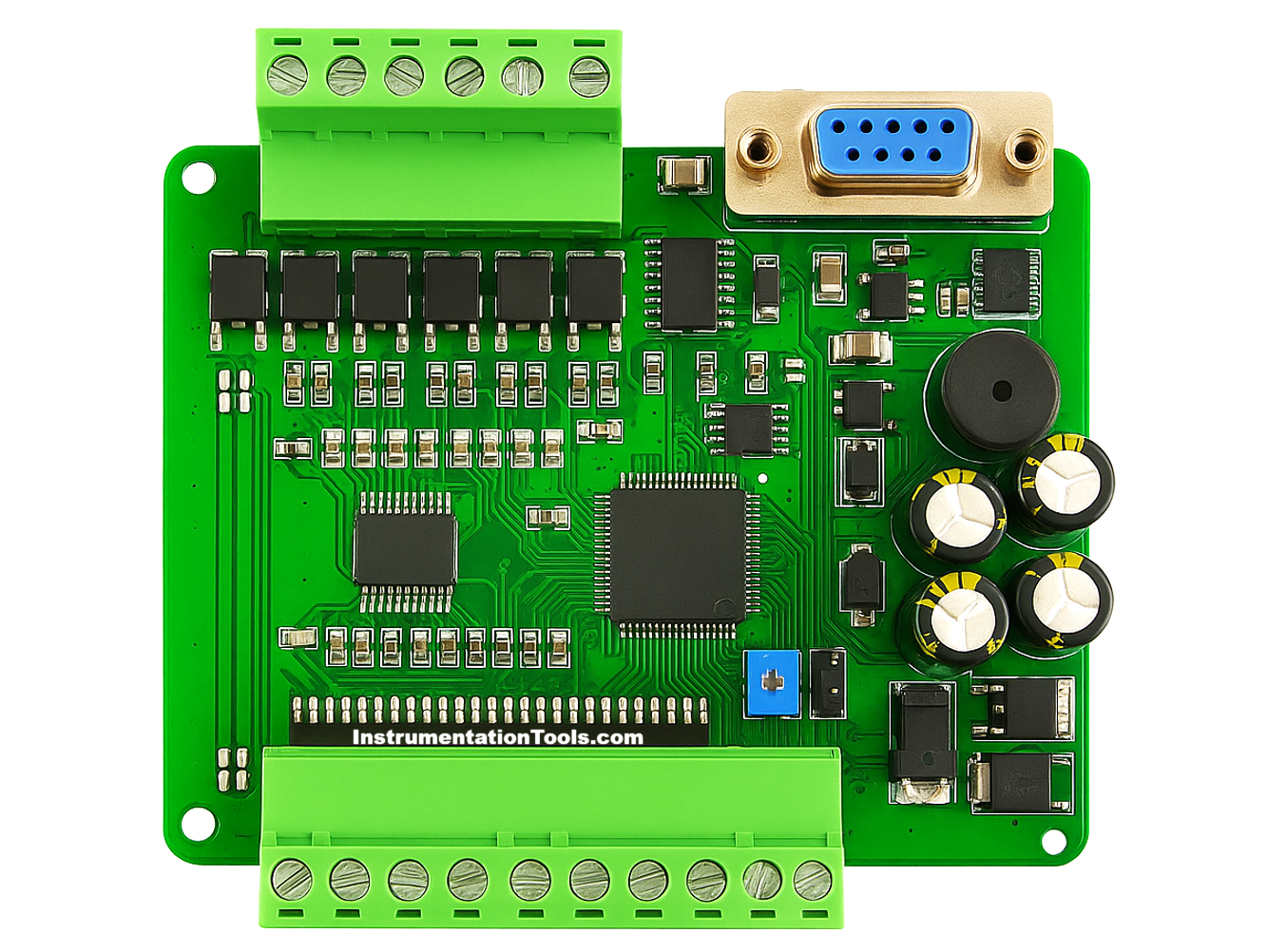

PLC FX3U-14MT Lollette (China)
This PLC can be programmed using Mitsubishi GX Works2 software with specifications of 8 digital inputs, 6 transistor outputs, 3 analog inputs (AI), 3 analog outputs (AO), 24V DC power supply, and an RS232 DB9 communication port with a maximum speed of 38.4 Kbps. With limitations in the number of I/Os and relatively low communication speed, this PLC is more suitable for automation learning purposes, small-scale projects such as simple control systems, and is not recommended for industrial applications requiring high performance.

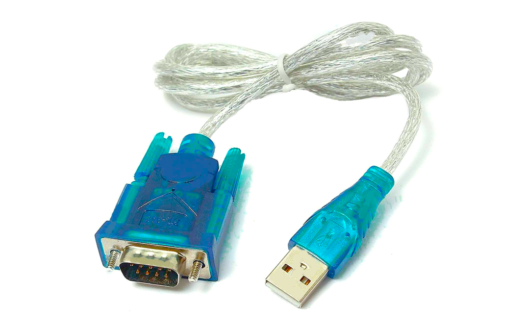

USB to Serial RS232 Cable
The USB to Serial RS-232 cable is an adapter that converts the USB port on a PC into an RS-232 serial port. This cable is used to connect the PLC to a PC during the process of writing/reading PLC programs or monitoring PLC programs.

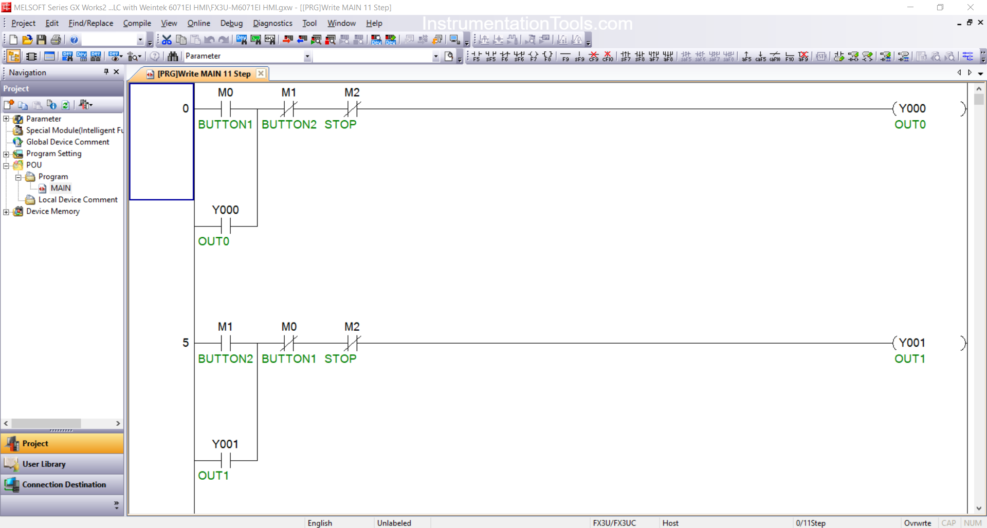

c. Create the PLC program to be used. Here’s an example:
How to Connect PLC FX3U-14MT with Weinview MT6071iE HMI

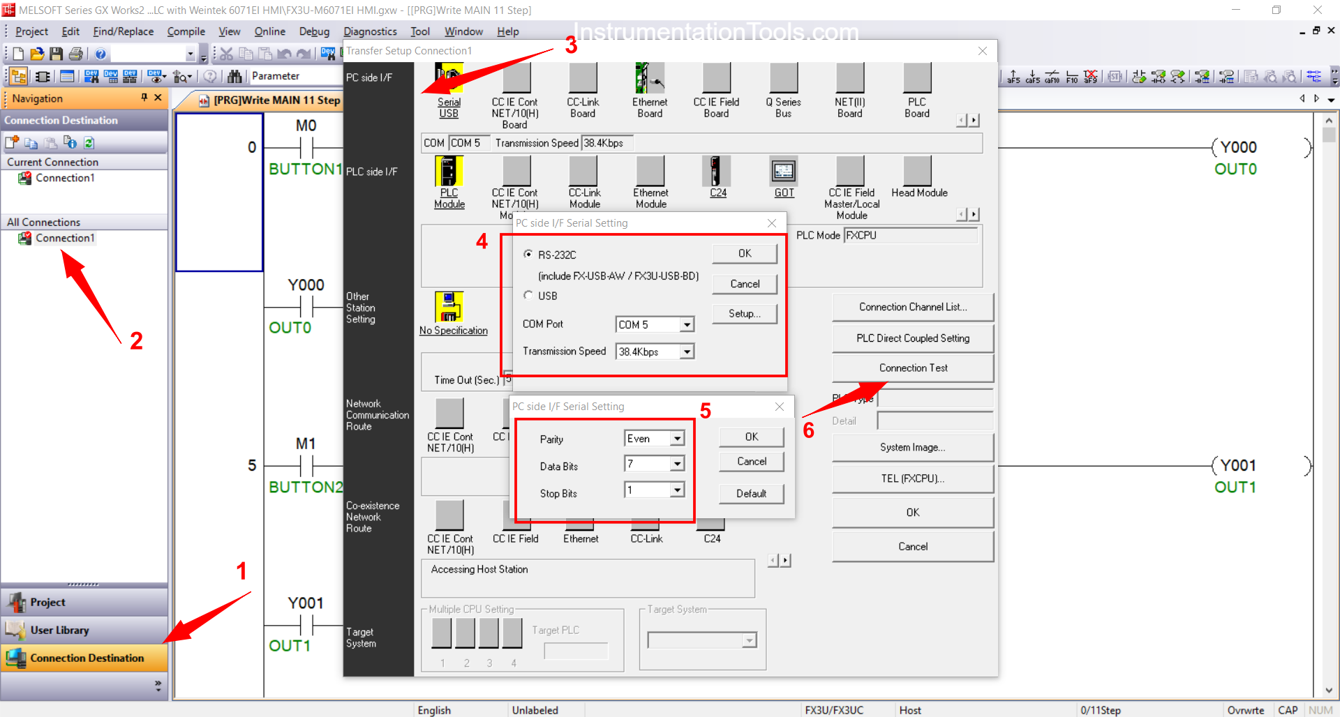

d. To configure the PLC connection, open the Connection Detection → Connection1 menu, then set communication parameters by selecting Serial USB (RS-232C) interface, specify COM Port 5, set Transmission Speed to 38.4 Kbps, and configure Parity: Even, Data bits: 7, and Stop bits: 1. Ensure the PLC connection is active by checking the port in Device Manager, then perform a Connection Test – if the notification “Successfully Connected with the FX3U/FX3UC CPU” appears, it means the connection between PC and PLC has been successfully established.

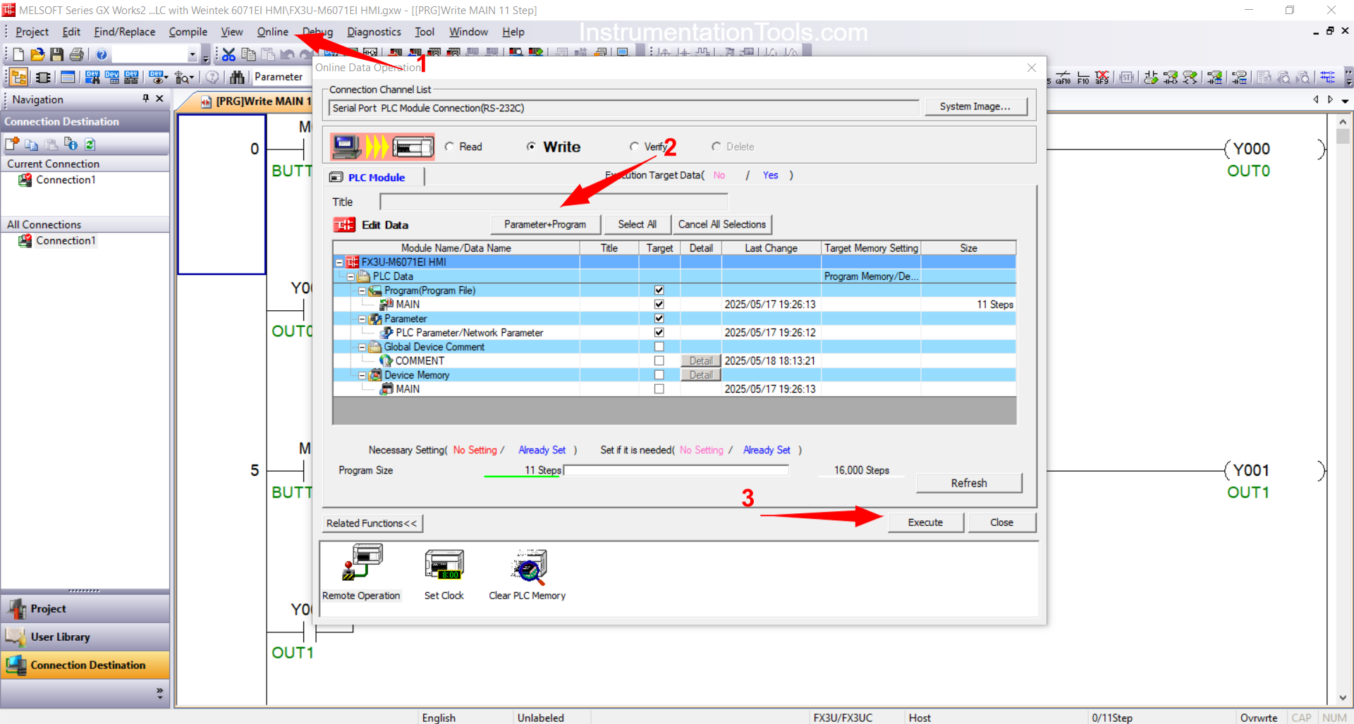

e. After the connection is established, click the “Online” menu then select “Write to PLC“. Specify the program section to be transferred “Parameter+Program” → press “Execute“. When a confirmation pop-up appears showing the transfer process is successful, the program has been sent to the PLC memory and is ready to run.
FX3U PLC to Weinview MT6071iE interface
f. The final step is to disconnect the USB to Serial RS232 cable from the PLC and PC.

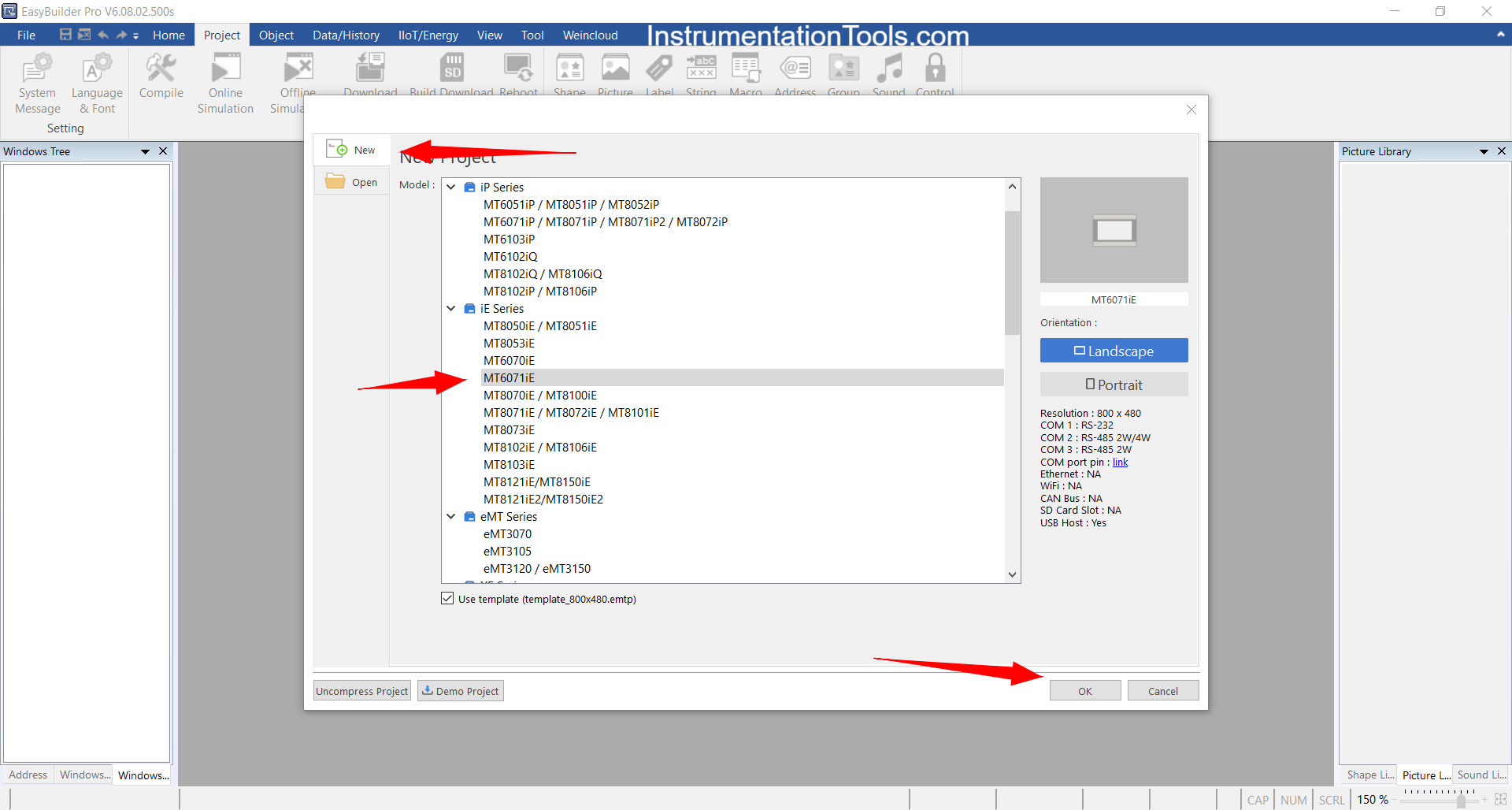

c. Create a New Project
Open Easy Builder Pro, then create a new worksheet by clicking New → select the HMI type to be used → OK.
EasyBuilder setup for Weinview HMI and FX3U PLC

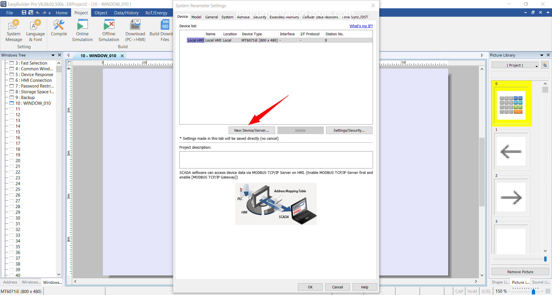

d. Add PLC Device
In the System Parameter window, click New Device/Server to add the PLC device.
Mitsubishi PLC and Weinview HMI tutorial

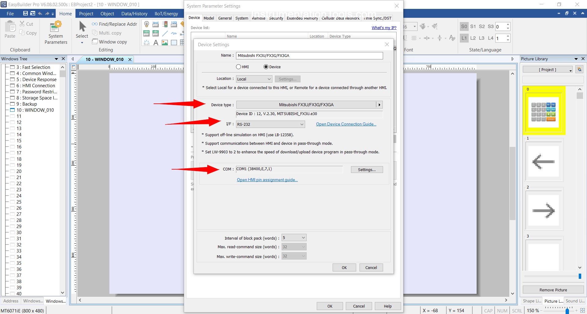

e. Configure Communication Port.
f. Set the port parameters as follows:
  • Port: RS-232
  • COM: COM1(*)(38400,E,71)
  • Device Type: Mitsubishi FX3U/FX3G/FX3GA
Click “OK” to save the settings.
Serial communication with Weinview MT6071iE

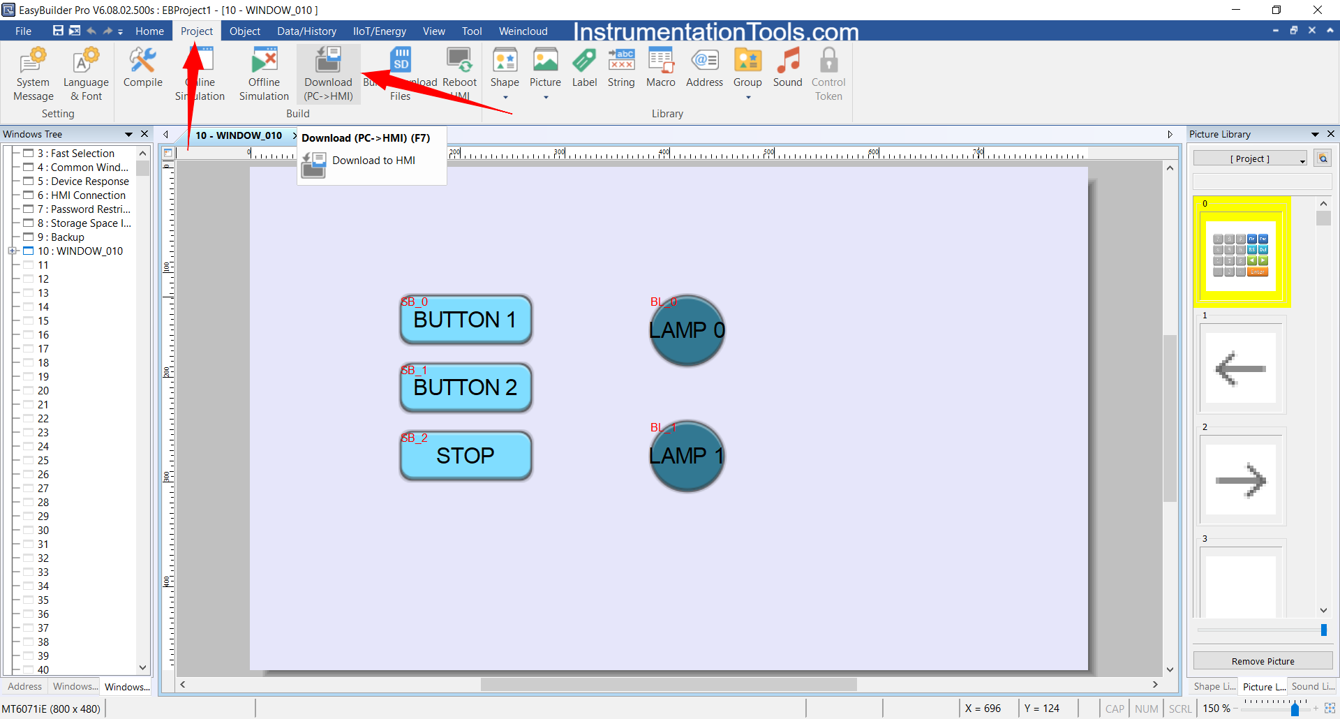

g. Design Interface & Download Interface
  • Create an HMI design by adjusting the Input/Output addresses according to the PLC program.

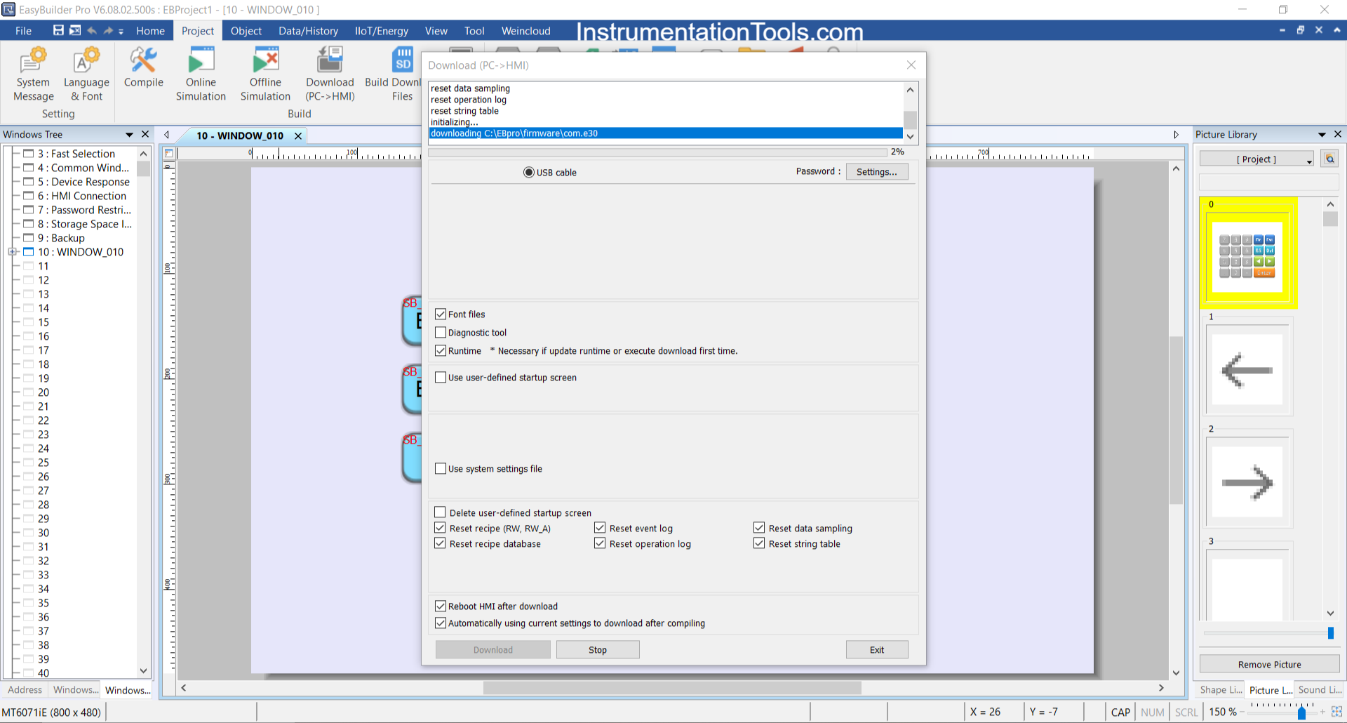

  • Click the Project menu → Download (PC->HMI)
Mitsubishi FX3U PLC communication settings
h. Wait for the Download process to complete, then click exit.

*Note: If a “Device Not Responding” message appears on the HMI, there may be a Device Type mismatch. The solution is to change the Device Type in System Parameter (for example: change from FX3U/FX3G/FX3GA to FX0S/FX0N/FX1S/FX1N/FX2/FX3SA), because some models like FX3U 14-MT have compatibility bugs.
