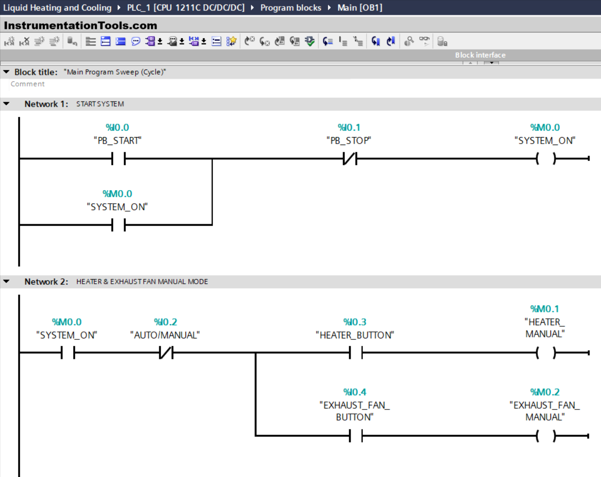

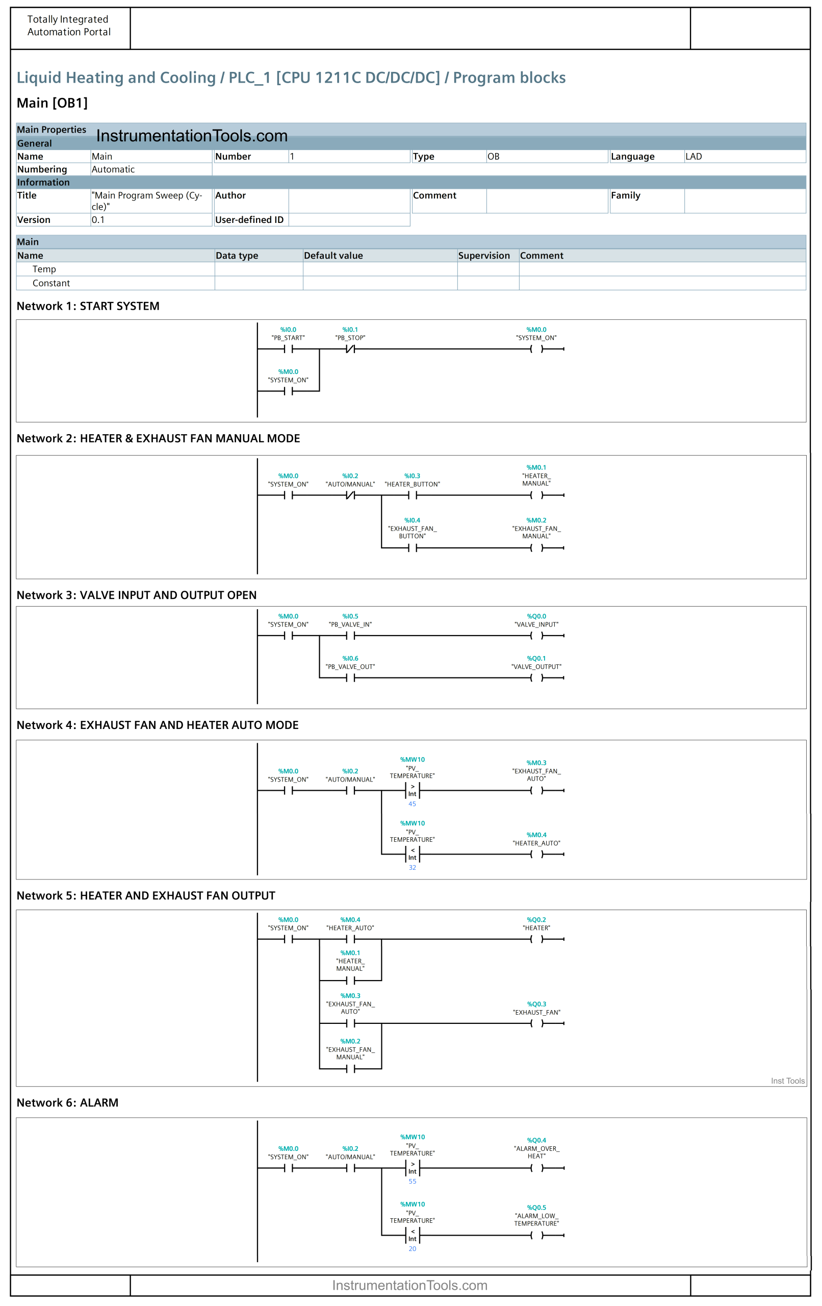

NETWORK 1 (START SYSTEM)
In this network, when the PB_START (I0.0) button is Pressed, the memory bit SYSTEM_ON (M0.0) will be in the HIGH state. Because it uses Latching, even though the PB_START (I0.0) button has been Released the memory bit SYSTEM_ON (M0.0) will remain in the HIGH state.
If the PB_STOP (I0.1) button is Pressed, the memory bit SYSTEM_ON (M0.0) will be in the LOW state.
NETWORK 2 (HEATER & EXHAUST FAN MANUAL MODE)
In this network, if the NO contact of the memory bit SYSTEM_ON (M0.0) in the HIGH state and the HEATER_BUTTON (I0.3) button is Pressed, then the memory bit HEATER_MANUAL (M0.1) will be in the HIGH state.
If the NO contact of the memory bit SYSTEM_ON (M0.0) in the HIGH state and the EXHAUST_FAN_BUTTON (I0.4) button is Pressed, then the memory bit EXHAUST_FAN_MANUAL (M0.2) will be in the HIGH state.

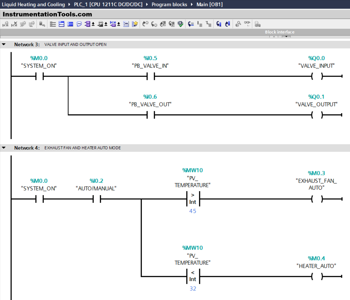

NETWORK 3 (VALVE INPUT AND OUTPUT OPEN)
In this network, when the NO contact of the memory bit SYSTEM_ON (M0.0) is in the HIGH state and the PB_VALVE_IN (I0.5) button is Pressed, the VALVE_INPUT (Q0.0) output will become OPEN.
When the NO contact of the memory bit SYSTEM_ON (M0.0) in the HIGH state and the PB_VALVE_OUT (I0.6) button is Pressed, the VALVE_OUTPUT (Q0.1) output will become OPEN.
NETWORK 4 (EXHAUST FAN AND HEATER AUTO MODE)
In this Network, when the NO contact of the memory bit SYSTEM_ON (M0.0) and Selector Switch AUTO/MANUAL (I0.2) in the HIGH state and the value in the memory word PV_TEMPERATURE (MW10) is Greater Than “45”, then the memory bit EXHAUST_FAN_AUTO (M0.3) will be in HIGH state.
When the NO contact of the memory bit SYSTEM_ON (M0.0) and the Selector Switch AUTO/MANUAL (I0.2) in the HIGH state and the value in the memory word PV_TEMPERATURE (MW10) is Less Than “32”, then the memory bit HEATER_AUTO (M0.4) ) will be in the HIGH state.

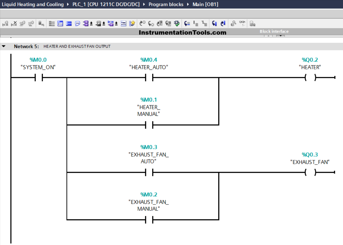

NETWORK 5 (HEATER AND EXHAUST FAN OUTPUT)
In this Network, if the NO contacts of the memory bits SYSTEM_ON (M0.0), HEATER_AUTO (M0.4), and HEATER_MANUAL (M0.1) are in the HIGH state, then the HEATER (Q0.2) output will be ON.
If the NO contacts of the memory bits SYSTEM_ON (M0.0), EXHAUST_FAN_AUTO (M0.3), and EXHAUST_FAN_MANUAL (M0.2) are in the HIGH state, then the output EXHAUST_FAN (Q0.3) will be ON.
NETWORK 6 (ALARM)
In this Network, when the NO contact of the memory bit SYSTEM_ON (M0.0) and the Selector Switch AUTO/MANUAL (I0.2) are in the HIGH state and the value in the memory word PV_TEMPERATURE (MW10) is Greater Than “55”, then the output is ALARM_OVER_HEAT (Q0.4) will be ON.
If the NO contact of the memory bit SYSTEM_ON (M0.0) and the Selector Switch AUTO/MANUAL (I0.2) are in the HIGH state and the value in the memory word PV_TEMPERATURE (MW10) is Less Than “20”, then the output ALARM_LOW_TEMPERATURE (Q0.5) will be ON.
