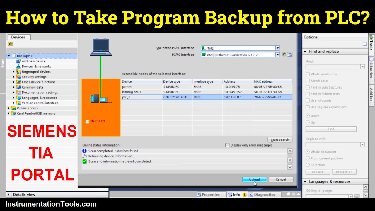

Create a new project, but unlike what we do usually we will not add a new device rather we will press the Online and choose “upload device as a new station”. See picture 1.
How to Take Program Backup from Physical PLC
Picture 1 – Upload the device as a new station.
This will take you to upload the device into the PG/PC window. See picture 2.
Backup from PLC
Picture 2 – Upload device window.
You need to choose the type of PG/PC interface as shown in the last picture and then press Start search.
When the search is done, you will see all the devices that were found by your software. Note that, it’s not necessary to only find PLCs; you will also be able to find HMIs, IO modules, and every other communication module that the software can detect. See picture 3.
PLC Program Backup in Siemens Tia Portal
Picture 3 – Scan complete and devices found.
After the scan is complete, you can select the PLC that you need to upload and then press Upload.  This will start uploading the software from the PLC to your TIA Portal. See picture 4.
Upload from PLC
Picture 4 – Upload from PLC is complete.
As you can see from the previous picture, the complete project saved on the PLC will be uploaded into your TIA Portal. Even with all the comments and addresses. See picture 5.
PLC project is uploaded
Picture 5 – PLC project is uploaded
As you can see, the whole PLC project was uploaded from the PLC to your PC. With all the blocks, comments, and project configurations.
This is how you can upload the project from the PLC to your PC. See the next video for the complete steps of the process.
