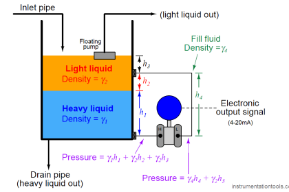

We need to configure the Lower Range Value (LRV) and Upper Range Value (URV) for the level transmitters after installation in the field. The formula to calculate the LRV (4mA) and URV (20mA) will always change based on the transmitter mounting or installation position.
The below example shows the different types of level transmitters installation.
Remote Capillary Level Transmitter Mounted at Zero Level
Remote capillary Level Transmitter mounted at zero level
  • dH = Vertical distance from the transmitter to high-pressure seal
  • dL = Vertical distance from the transmitter to low-pressure seal
  • Lmax = the maximum level of the process above the high-pressure seal and typically the 20 mA lower range value
  • Lmin = the minimum level of the process above the high-pressure seal and typically the 4 mA lower range value
  • SGf = specific gravity of fill fluid
  • SGp = specific gravity of process fluid
Tank span = Lmax *SGp – Lmin *SGp
Tank span = (108 in.* 0.75) – (0 in.* 0.75) = 81 inH2O
4 mA = Lmin *SGp + dH *SGf
4 mA = (0 in. 0.75) + (0 in.* 0.934) = 0 inH2O
20 mA = Lmax* SGp + dH * SGf
20 mA = (108 in.* 0.75) + (0 in.* 0.934) = 81 inH2O
Span = 81 inH2O (81 to 0 inH2O)
Note: Both installations would have the same calculated range points.
Note: Silicone 200 has a specific gravity of 0.934.

  • DB says:
    December 28, 2019 at 11:55 pm
    Why does Tank span = (180 in.* 0.75) – (0 in*. 0.75) = 81 inH2O? as far as I can tell, 180*0.75 = 135? What’s going on here that am I missing?
  • Almahadi says:
    January 10, 2020 at 2:57 pm
    This is very Good and practically Hope I find a lot of engineering that can this tools help them
  • Rathete says:
    April 30, 2020 at 5:19 am
    I’m in Concord with the initial commentor,My line of understanding that calculation,is blurry,won’t some light be shed?.I’m talking about what DN is commenting about
  • giby says:
    June 10, 2020 at 4:00 am
    i think the Lmax is 108 not 180..
  • Kamesh.b says:
    November 26, 2020 at 11:42 am
    Not thinking
    Here in the examples all 180 are ,misplaced actually it was 108
    And in 3rd example dh & dl are also wrong position according to theory
    May this calculation will be correct by author
  • R. JAGAN MOHAN RAO says:
    November 28, 2020 at 7:11 pm
    I thank everyone for their comments on the mistakes. Corrections have been done and updated in the article. I also thank Mr. Bharadwaj Reddy Garu for bringing various comments to my notice.
