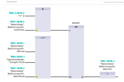

Here, we will create a simple PLC program of Addition. Each time Function is called it increment value.
In the FC environment to create input, we have to select a variable from the section option.
FC Function
Here, I have selected Local In. In local in whenever FC called in OB logic must be set every time as in our example, we want to do addition. so, the number will change each time FC called.
Global in use when a block has to retain its value until their value is changed by a function or by other logic.
The same rule is applicable to define the output.
what is fc in siemens plc
Here, in the above window, I have created logic in function to add number 5 each time FC is called from OB.
Siemens PLC Programming OBs in Siemens TIA Portal
Follow the step as shown in the window and the program which we have created in FC, now drag here into OB.
Introduction of Siemens PLC
Example: FC Function for Valve Logic
You can see above the window in which I have to give a name to input and output and use a variable for the addition.
In the previous FC window, I took 5 to add. When this program executes and I make I0.1 make true it will add 5 + the number which wants to add. Here in our case, I use 45 so the last answer is 50.
So, every time OB executes it will call FC to make an addition.
