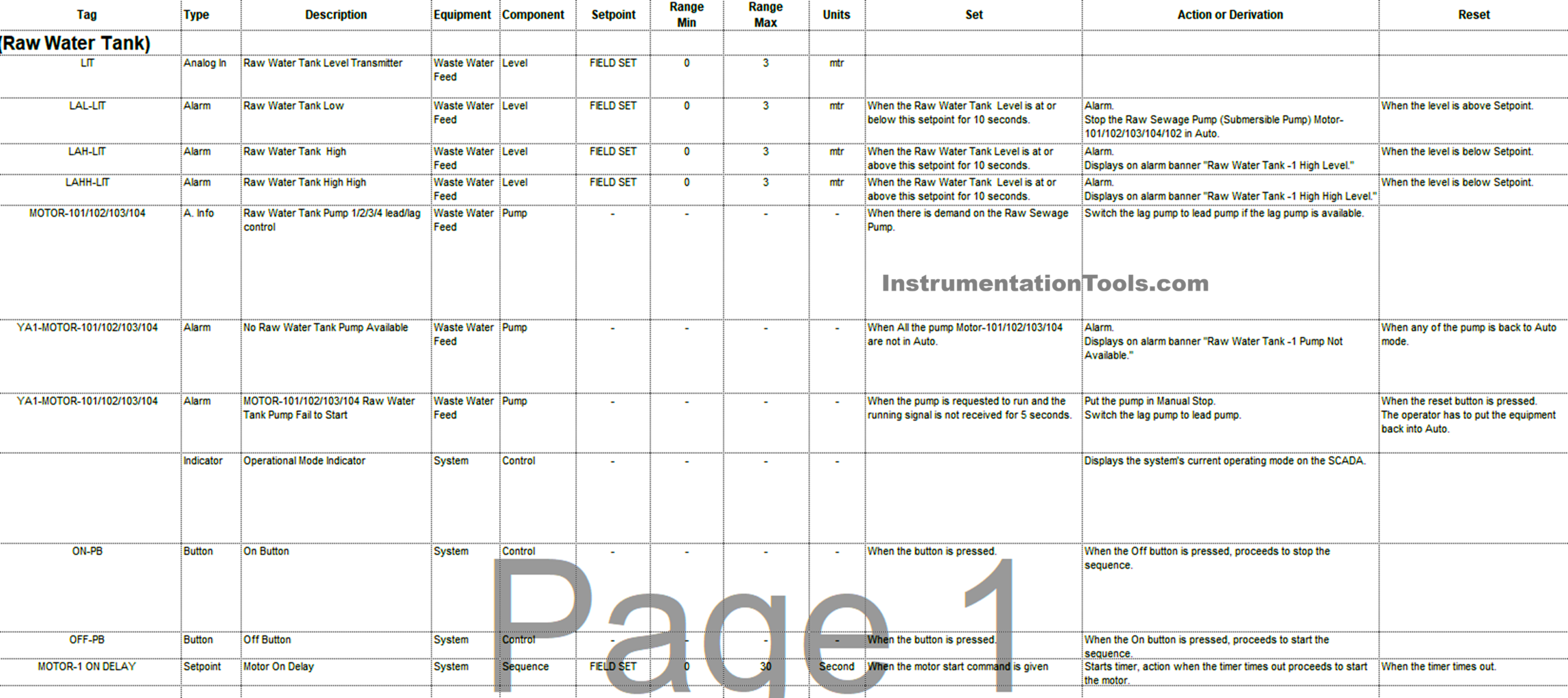

Let us understand this by an example. Refer to the image below for more details. As you can see, we have a raw water tank which has the following components: four motors and a level transmitter. So, to automate this tank in detail and with proper interlocks, we develop a control logic chart.
We first start with the level transmitter. It indicates the location of the instrument and its scaling range. Then, for this instrument, we generate alarms. Each alarm will have a description that needs to be shown in SCADA. The set point for these alarms will have a minimum and maximum range that needs to be entered in SCADA. Then, we need to write how the alarm occurs and what happens when that alarm comes. Also, we need to describe how the alarm is reset.
Similarly, we write the logic chart for the motor, describing its alarms and operations. Then we describe what all operator buttons and setpoints are required for this tank in the SCADA to be operated in auto or manual mode. In short, you must have seen that we covered the inputs and conditions, decisions, steps, and interlocks very simply and in an understandable manner in the chart. If the motor had a complex sequence of operation, then that would have been covered in the operation sequence chart.
