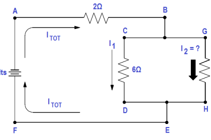

A 30 Ω resistance and a 40 Ω XC are in parallel with a 120V power source, as shown in Figure.
Calculate Power in Parallel RC Circuit
Figure : Parallel R-C Circuit
Find:
  1. Current, IT
  2. Z
  3. Power Factor, pf
  4. True Power, P
  5. Reactive Power, Q
  6. Apparent Power, S
Solution:
1.Current, IT
Calculate Current in Parallel RC Circuit
IT = 5 amps
2. Calculate Z
Z = VT/IT
Z = 120/5
Z = 24 Ω
3. Calculate Power factor (pf)
Calculate Power Factor in Parallel RC Circuit
p.f. = 0.8
4. Calculate True Power, P
P = EI cos θ
P = (120)(5)(0.8)
P = 480 watts
5. Calculate Reactive Power, Q
Q = EI sin θ
Q = (120)(5)(0.6)
Q = 360 VAR
6. Calculate Apparent Power, S
S = EI
S = (120)(5)
S = 600 VA
